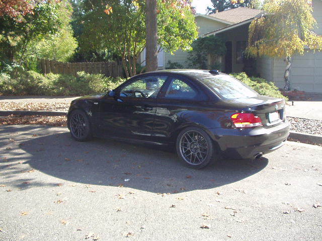

Here's a pic of my car.
I hope I CAN talk you into getting the Ohlins! They're available from PSI (Performance Shock Inc, ask for Beau) and I think HPA carries them as well.
I chose different spring rates for the rear. The kit comes with 342 front and 400 rear, I got 700 rears in 8" length and the car rides 1" lower with adjustment in either direction. No revalving is necessary for the rear shocks.
I'm not an expert, but I do know how nice racing shocks feel, I have JRZ's on my Porsche, better performance but harsher ride, and the ride on my 135 is SOOO smooth even with twice the spring rates, I'm convinced the Ohlins Road and Track shocks are different and special. The DFV is the real deal.
