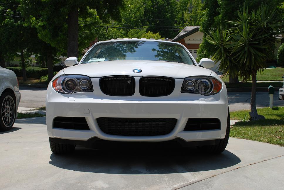

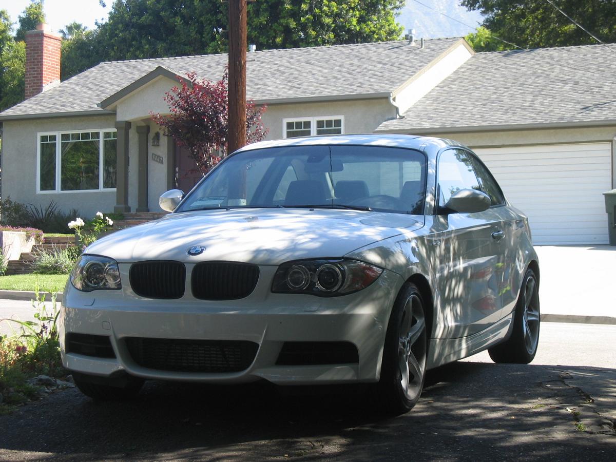

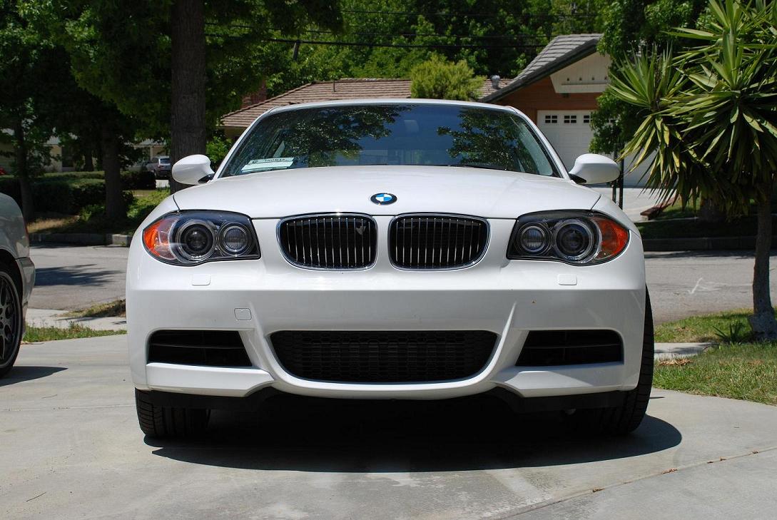

These are the only pics I have, sorry the lighting is bad. Ill take more when I get home.

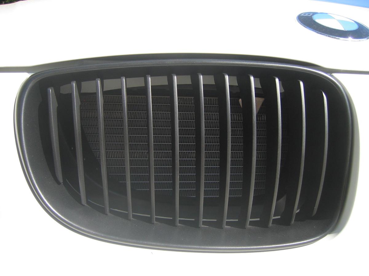

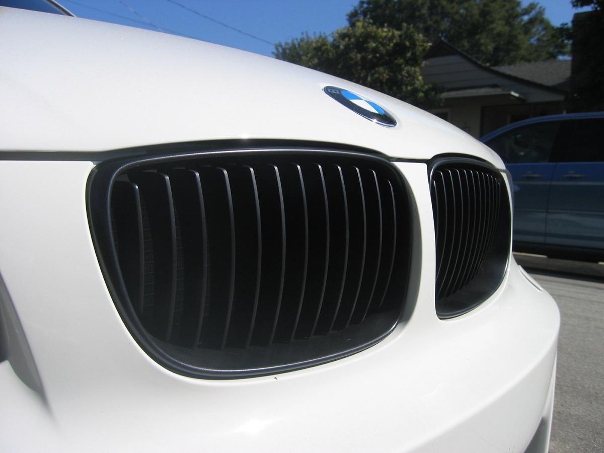

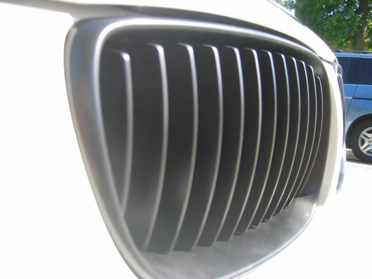

Ok some close ups...
