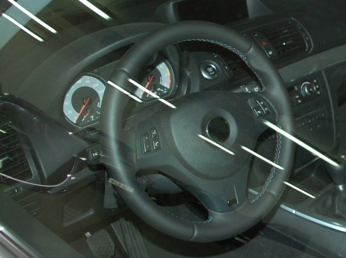

I think, I remember seeing some pics of the early 1M prototypes running around with M3 seats. We need to call upon our local 1M WiKi aka @Artemis for a picture!
Only few pictures are around showing the seats in 1M test mules. Here's one (as you can notice, the alcantara trim and anthracite ceiling still had to be implemented - no M3 seats).

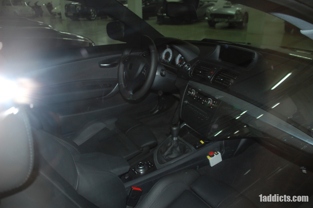

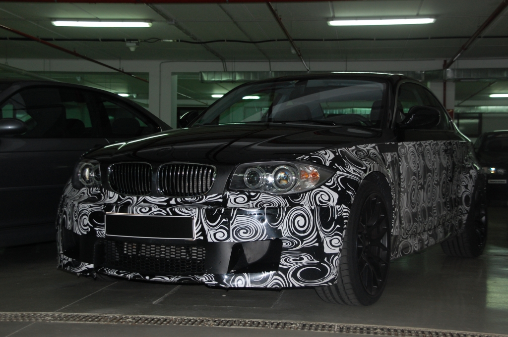

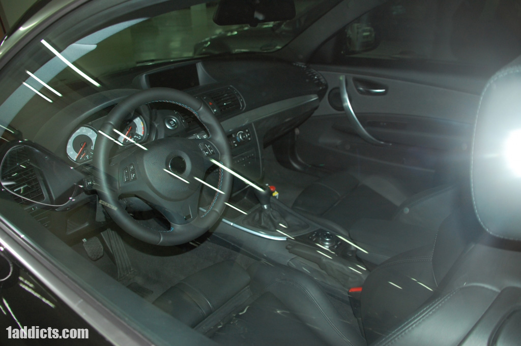

@andrey_gta @swagon @BMW40146 @pd135
@Artemis you made me go digging in my 1M photo archives!
I found the picture(s) I remembered showing the M3 seats in a 1M prototype. This was also the first photos of the 1M instrument panel gauges. You can clearly see the M3 seats.
