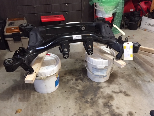

no progress this weekend and I'm out of town next weekend.
I'll try to get some things done during the week:
replace inner CV boots on rear axles
replace ball joints on rear hubs
pre-assemble some of the subframe
New FMIC is on order. I'll be switching from AA to AD Engineering due to distortion of bumper so that I can't fit a splitter.
Every part in this picture is brand new from the dealer:

Finally, made some headway now that the pool's closed, the boat's on land, and the boy is back in school.
In September, I had a few hours to tinker on a Saturday (while closing the pool) so I figured I'd tackle replacing the CV boots. As you can see in the picture below, not so good, and both sides were in the same condition. Disassembly was a piece of cake and cleaning everything off just took some brake cleaner and paper towels. I took pictures while taking things apart but I did make two mistakes putting the joints back together. The first mistake was just dumb: there are "V" grooves where the big ball bearings run in the inner and outer rings of the joint. My mistake was not lining up the "V's" staggered. It's kind of hard to explain unless you're in there and if you don't do it right, you'll never get all the balls back in. I got the first joint together no problem. The second joint ate up a couple of hours and I set it aside for about 3 weeks. Once I saw the "V" thing, I was able to put it back together quickly. Second mistake: a big one. The inner ball race has a step cut into the splines. This side should slide onto the axle first, I put them backwards and resorted to Thor's Hammer to get things seated.
Having gotten the axles back together, assembling the subframe was fairly easy and it helped quite a bit to have the nuts and bolts pre-assembled onto each control arm. Everything just bolted up, no swearing necessary. I'm leaving the calipers and rotors off until after the subframe is bolted up in order to keep the weight down. All up weight is around 300 lbs. I'll also put in new parking brake shoes and backing plates before adding the rotors and calipers (caliper were rebuilt in September).
I had bought 2 dollys at Home Depot some weeks back. I'll use these and some wood to create a cradle for the assembly, then push it into a corner until Spring. This will give me time to double check I've got everything I need to bolt up the subframe and driveshaft.

Made up the cradles yesterday and got things mounted today. I forgot that one axle is longer than the other so I had to make some minor changes after the unit was on the cradle. A little bit hair raising since the entire thing wound up on the floor when I was doing a trial fit. Almost took out my foot.
Not as pretty as I'd hoped but there was a lot of on-the-spot engineering and I only used cheap framing studs.
Now i've got a warm and dry home for my car over the winter.

Originally Posted by drwillb View Post
That's interesting. I did 6 months of research before beginning to buy parts and I didn't come across this. Do you have more details? I don't want to get stuck without the right parts as I'm putting things back together.
Maybe you're referring to the fact that 135 and M3/1M toe arms are different lengths so, unlike the other rear arms that are 100% interchangeable, the toe arms are not. In my case, though, I'm using full M3 components including hubs and axles so there's no snag there.
Yup. I must of been thinking of something else. I shot an email to Harold at HPA and he confirmed the M3 toe arm will work with the M3 subframe/suspension.

Bikes and Traf, the item you are calling a V8 flange is actually a full CV joint connection vs the stock 135 simple 50mm nut coupler thing.
I've got one those CV joint flanges for sale. BNIB. I was going to rebuild the M3 shaft that I bought.
Anyone interested? M3 driveshaft and/or CV joint for sale
http://www.1addicts.com/forums/showthread.php?t=1443492
the driveshaft is not listed in that post but I have it.
**Traf: great contribution on that driveshaft conversion. Too late for me, but others will benefit.
