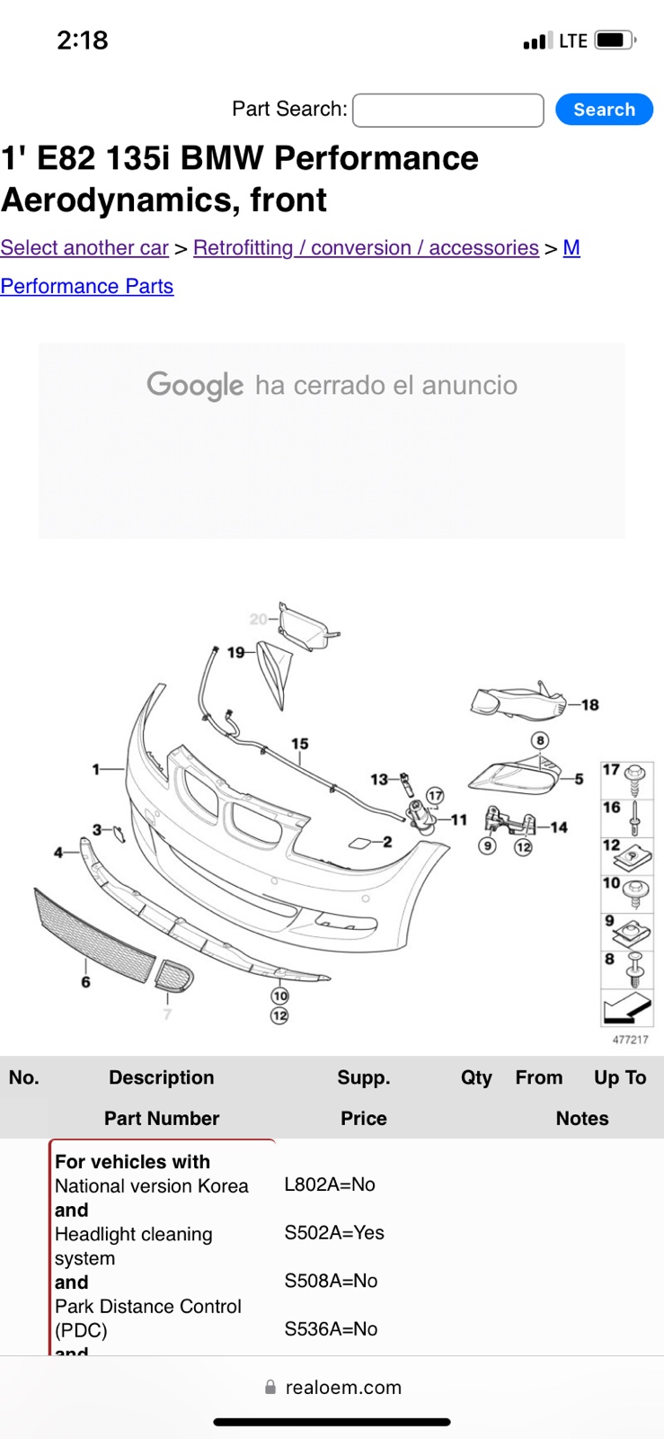

I am going to be retrofitting front PDC to my performance aero bumper. Thanks to Realoem.com, I am well studied on the bits I'll need (willing to share any info!) EXCEPT one!
The mounting holes on the bumper.
All suggestions I have so far are flat mounts (51117209152 & 51117841902). However, if you Google this bumper with pdc, you will see the sensors are not mounted flush, they are angled and recessed. Please see below
Name:  Screen Shot 2023-08-21 at 12.24.19 AM.png
Size:  405.5 KB Name:  Screen Shot 2023-08-21 at 12.24.52 AM.png
I believe that if I mount the sensors flush, they will not be correct. I'd like to know what the part numbers are for the mounts. I'm almost certain they are not molded into the bumper! My bumper has X's to mark where the holes for PDC should be. Would appreciate any help!

Part no ending in 902 is the sensor mounting bracket. Though you can’t see the front, the lip of the bracket should be the same as the one you pictured.
Why not remove the brackets from your old bumper and attach to new bumper?

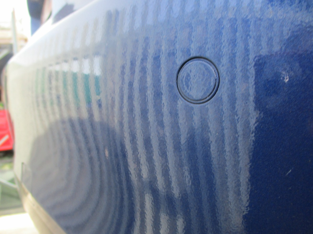

I found this M-Sport in England with front PDC. Flush mounts

Here's another example of some close up PDC on an aero bumper (Still doesn't seem to be the .902 part to me)
You'll also notice the back of the clips look like they only have 2 'arms' to hold the sensor?
Luxury85.50

Part number ending in 902 is what realoem lists as the parking sensor bracket for both stock and perf bumper.
The problem is, there is no photos of how the front of the bracket so it’s hard to say if it has the extra edge.
The sensor can also be mounted flush and still work properly.

I see the first image now.
Wow two perf bumpers in one photo. Are those recent? Did you find them on the internet or in person? The part numbers of each of the four mounts are molded in them
That is an important detail, glad you noticed. Also the inner two have a flat edge and the bottom are completely round.
I cannot find it on performance in realoem, only the stock and m sport, which I think is called M Aerodynamic kit, nope M Trim, but the performance bumper is Performance Aerodynamic Kit. Notice that there isn’t a line and number on the perf bumper diagram to show the mounts.
Could you show us what leads you to believe 902 is for performance?
I don’t understand PDC technology. If I was guessing, I’d assume the purpose of the different mounts is to keep the sensors in the exact position so when the PDC coding is the same regardless of what bumper you have, it will reflect onto the screen and beep accurately.
