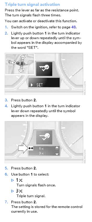

Today I drove the car and everything is going great, except... I just noticed that my turn signal tap doesn't trigger 3 blinks anymore ?
Since I bought the car I've had the 3 blinks.
So some questions:
- is the 3 blink tap a standard feature or did the previous owner had it coded?
- could the coding I did make the 3 blinks disappear?
- shall I be worried about other things that got changed and that I can't see as obviously?

When you process a module , or "process car," all you're doing is setting everything back to stock settings based on your $VO. So, yes, someone changed that blinker option in the past. Or, maybe it came customized for your cars package or something off the factory floor.
Either way, all you need to do is edit the CAS/NFRM, or whatever module the settings is housed in to get back that feature (sometimes multiple modules all need editing which is why process car is a good function to use when making $VO changes).
Carly is the best app for making these kinds of changes. You can also make the change manually using NCSExpert or NCSDummy. Should be a fairly common thing people edit so some googling should get you an answer on what to change...
Nothing to worry about. All you did was reset those modules back to their factory settings (factory settings as in what your $VO reads).

BTW, I found the answer for the 1x blink vs 3x blink!! ==> RTFM
Page 57 of the non-iDrive user manual it shows how to select one from the other using the dash UI.
So definitely a no-brainer, and fully expected upon a CAS/NFRM reset.
