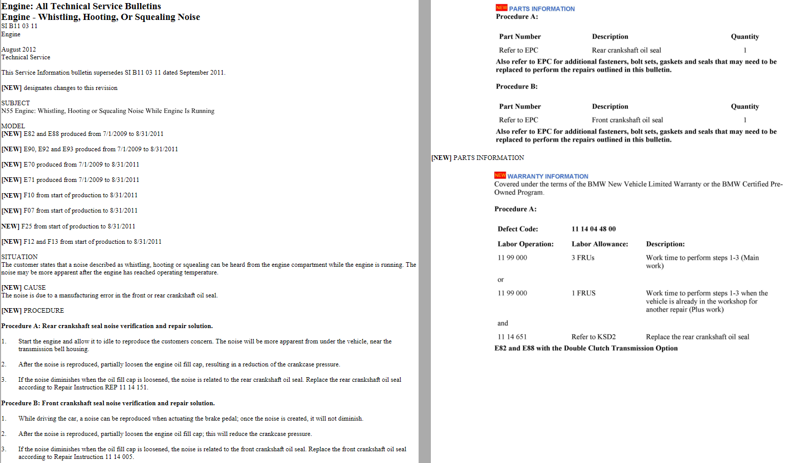

If your crankshaft front or rear main seal is howling, whistling, squealing, chirping screeching or chattering like this, this, or this, check the PCV valve first. SIB 11 03 11 explains that faulty front and rear crankshaft seals were installed on all models produced between 7/1/2009 and 8/31/2011 but I suspect that many of these seal problems are actually caused/cured by the PCV valve. Photos below detail the failure of the rubber diaphragm in my 05/2011 which led to problems with both the front and rear main seals.

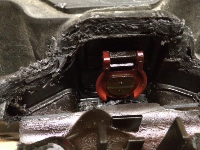

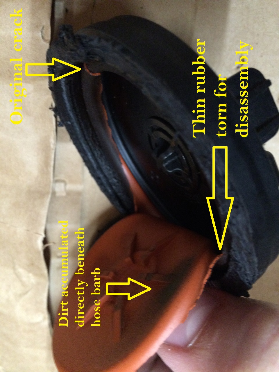

The one-way valves are quite simple and robust, as is the sealing portion of the PCV valve itself. Clogging, leaking or gumming up of any of these mechanisms appears highly unlikely. But unfortunately the diaphragm actuator has very thin edges that can crack and leak. When this happens the valve will fail to close and the crankcase will be exposed to excessive intake vacuum, likely resulting in front and/or rear main seal squealing and/or damage.
If you have any reason to suspect PCV valve malfunction, first open the oil cap to see if the problem (e.g. main seal noise) immediately subsides -- this is perfectly safe and will confirm that crankcase pressure is related to the problem. The engine will stumble a little as it goes lean from the unexpected air flowing thru the PCV system.
You can easily test the PCV valve for failure by holding a smoke source (match, cigarette) close to the hose barb with the engine idling. If smoke is continuously ingested into the valve the diaphragm is leaking. You could also use a clear hose and see if motor oil is drawn in. Or you could apply 38mbar positive pressure to the barb with the engine off and confirm that the pressure is held for a reasonable time. Do not connect a pressure gauge to this while the engine is running, you will interfere with the PCV operation and will not get any useful information anyway.
Cause of my valve failure:
The radial direction of the crack in my valve is quite curious and does not seem consistent with fatigue so I suspect it may have been exposed to high pressure and "popped". The system is well designed such that the delicate diaphragm portion of the valve can never be exposed to raw intake vacuum or boost pressure -- only regulated crankcase pressure. And the crankcase pressure can never be too high or too low, thanks to the PCV regulator and related one-way valves. It's pretty foolproof, unless you're a fool.
I only owned the car for 4K miles when this happened so I don't know the history but I think the previous owner must have done one of two things:
  1. Connected a pump to the barb and sucked/blew hard enough to pop the valve diaphragm. I can't imagine any reason someone would do this, but I can guarantee it would break the valve.
  2. Performed a pressure test of the entire intake tract without removing either the metal PCV hose or the oil cap. Pressure tests should be performed from the turbo inlet pipe with a kit like this, but if you have an aftermarket intake with some round connection that seems more convenient, you will end up pressurizing the crankcase if you don't remove the oil cap. This occurs because you are pressurizing both PCV vacuum sources (pre/post turbo) so the air that inevitably leaks past the piston rings and PCV one-way valves will slowly pressurize the entire crankcase until the regulator diaphragm pops. It's only designed to handle 0.5psi so hitting it with the standard 20psi leak test will surely burst it.
