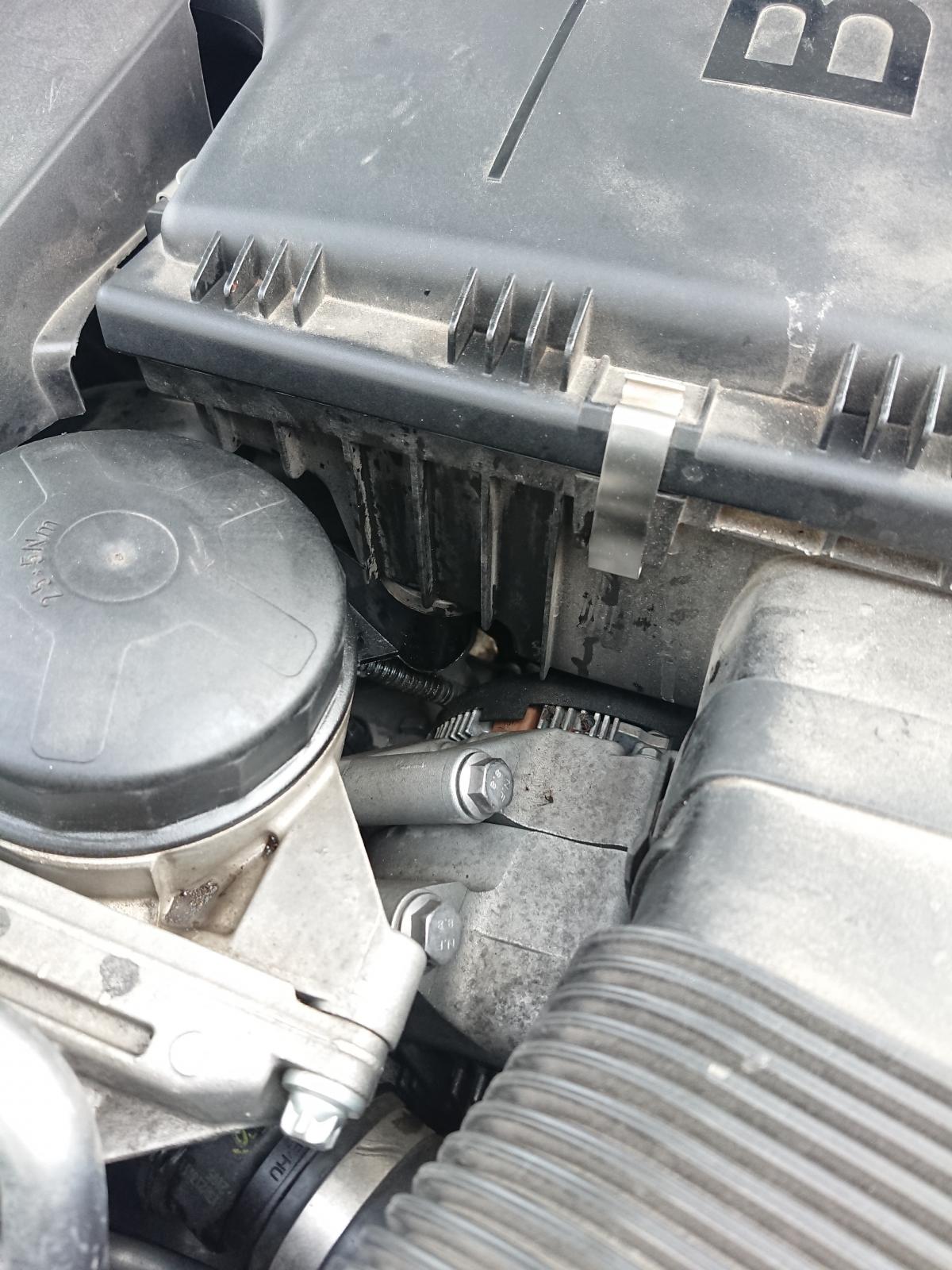

I opened my hood for the first time after a few thousand km since my last oil change, noticed some oil. There is a possibility that it could be from the oil change because I didn't do it this time, but if that's not the case judging from where the oil is what would the leak be from? Yes I know I have a dirty engine bay.

Looks like they dripped some oil from the filter during removal, gave the mess a fast wipe with the closest rag, and moved on... gaaaahh, I hate oil change places....
I'd suggest cleaning things up and monitoring for a bit to be safe, but no worries I think.

Agreed with 1and1, but just to be safe check the underside of your oil filter housing. OFHG leaks are very common for us. It can leak onto a pulley and cause all kinds of messes.

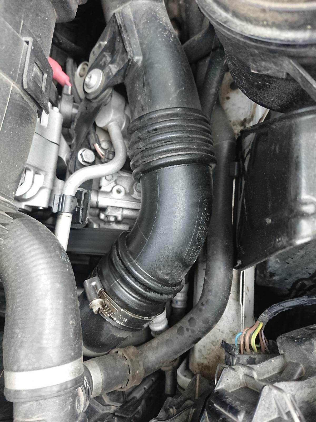

Yeah looks like spilled and sloppily mopped up oil. Look at the excess in the recesses by the filter cap. Doesn't look like burned residue. Other note is possible coolant dried up on the CP. White residue.

Time to break out some "brake cleaner" and hose down that area. Probably due to a sloppy last oil change. When you remove the oil filter cap... use a flash light from inside to out... so check for any cracks in the plastic cover. Oil filter housing(OFH) gasket leaks usually leak downwards.
Looking at your last photo... Are you sure you don't have a boost leak ? Can you check for codes? The hose clamp on your CP looks suspicious to me.
