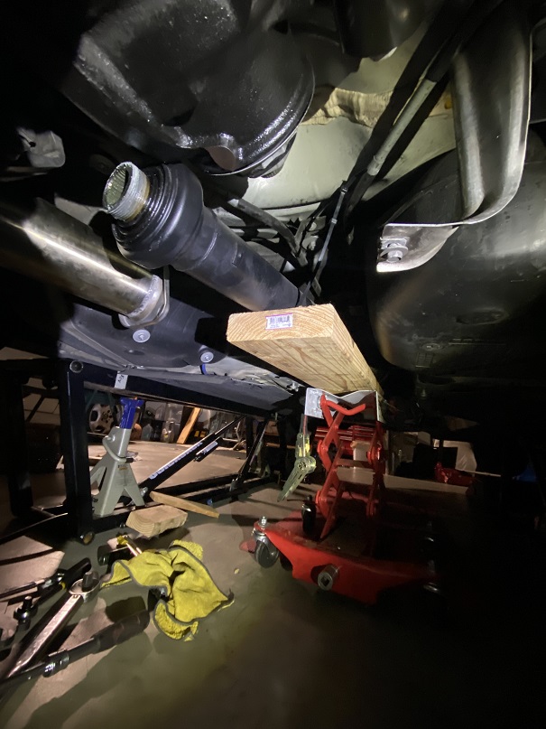

8. Once the insert nut is completely off the drive shaft, I proceed to remove the Center Support bearing bolts and support the entire driveshaft assy with Transmission jack.
9. Slide the Drive shaft out of the Transmission Output Flange.
10. Slide the Drive shaft out of the Rear Diff Pinion shaft.

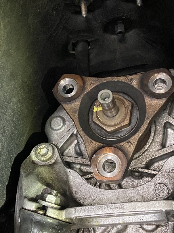

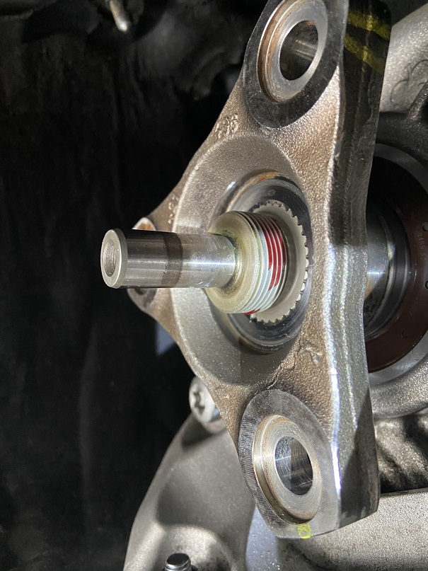

11. Now you can see the Transmission Output Shaft Flange.

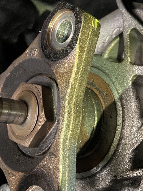

12. The Flange is press fit to the spline and you would need to brace the flange to remove the nut. This Giant nut (36mm) is Loctited so a little heat gun persuasion was necessary.
13. I marked the nut final orientation to the shaft just to double check that I get the torque spec correctly.

15. Even with heat applied to the nut, this thing was on there tight. I didn't want to use impact.

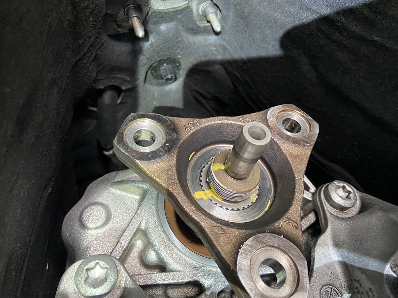

16. After a couple more heat cycle it finally came loose. I marked the the flange to the spline in one plane so I can put it back in the same orientation. I don't think you need to do this, but I'd just do it for ease of mind.

17. Pay attention to how flush the flange surface to the spline end. This will be your reference of the final engagement of the press fit between the flange and the drive spline.

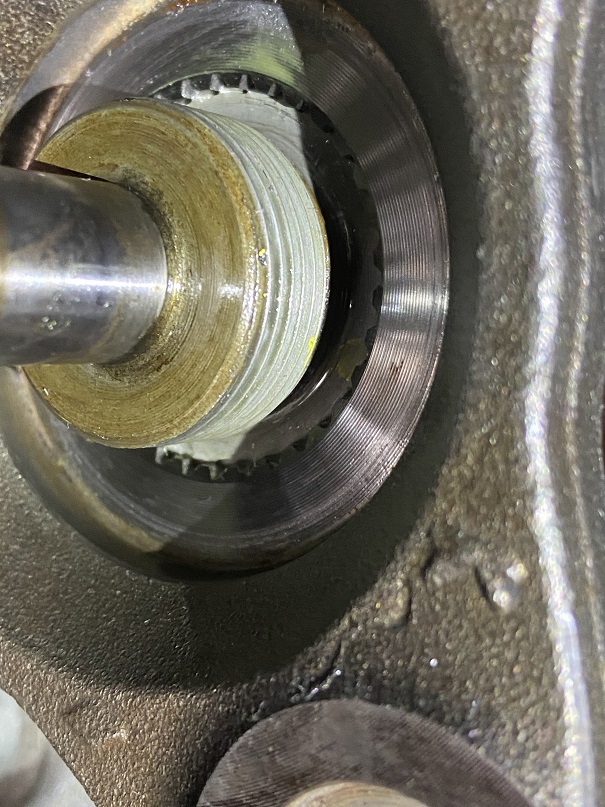

20. Its time to remove the seal victim. Before I remove the seal, I'd measure the depth of the seal with respect to the housing. The TIS didn't mention this other than drive the seal till it hits a hard stop. To do this, I used a depth gage to measure how deep the seal is seated with respect to the housing edge. You can also visually see how the chamfer edge of the housing is almost flush with the edge of the seal front edge. My depth gage measured at .018"

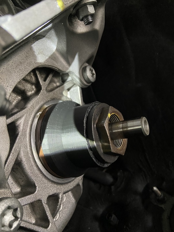

I opted to use a spacer that I built using 3d printer and the spacer is being driven by the giant nut. This way I have equal axial pressure to drive the seal in nicely.
Once you get close to mating surface, slow down and make sure you that seal is seated properly by either measuring that gap or visually by making sure that the seal front edge is at the chamfer edge of the housing. I measured mine and it was .020". A couple thou off but oh well, should be OK.

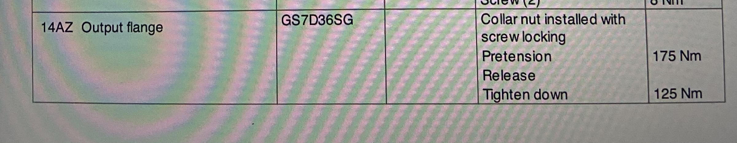

23. Now its time to put the flange back in. To seat the flange to the drive spline correctly, you would need to torque this down to 175NM.
This would make sure that the Flange is seated properly.
Remember the mark I did in the beginning, this is also a confirmation that the two interface are mated properly. When I torqued the nut to 175Nm, it was right where I marked it in the beginning.

24. Once you flange is seated properly, release the nut and clean the threads with acetone or brake cleaner. DO not spray all over, just focus on the area being cleaned. Make sure it is squeaky clean then apply Red Loctite 271 (TIS mentioned medium 243) and torque it to 125NM.
Wait for 24 hours for the Loctite to fully cured.

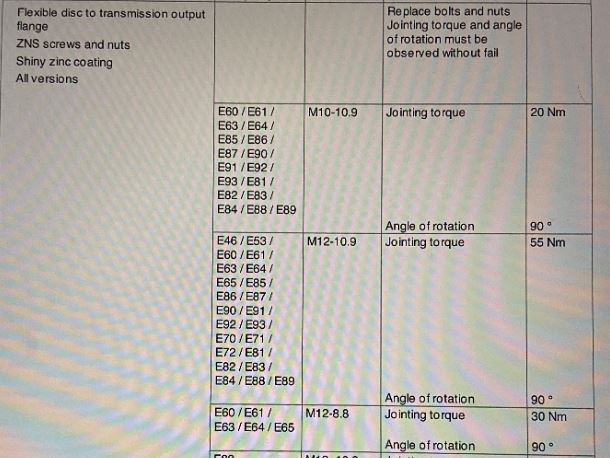

25.Re install the drive shaft Guibo to the flange. Remember the orientation that we marked in the beginning. Torque the bolt to 55 Nm and 90 degree.

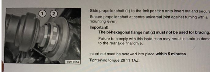

28. Re install the NEW insert nut to attach the driveshaft to the Rear Diff.
https://www.fcpeuro.com/products/bmw...x6-26117567770
You got 5 minutes to do this per TIS.
