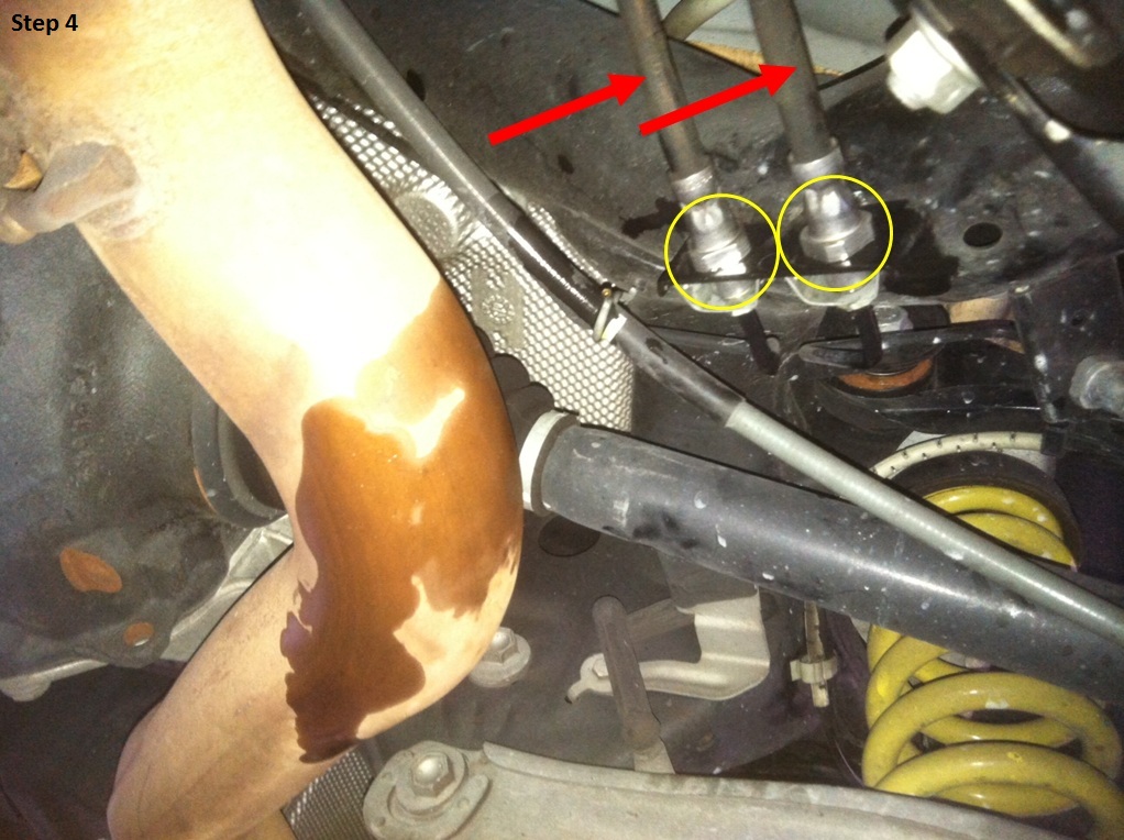

4. Use a pair of vice grips (or a hose crimper or something similar) to stop the flow of brake fluid in the brake lines indicated in red. Then use an 11mm open-ended wrench to disconnect the rear brake lines by detaching the fittings indicated in yellow. Once you disconnect the fittings, some brake fluid will likely leak out of the hoses on both ends. One good solution is to put a Ziplock bag around it to collect any spillage. I obviously did not!

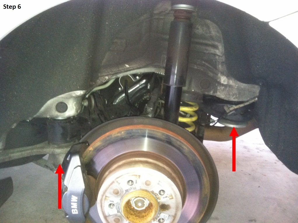

6. Use a 1/2" ratchet and a 9/16" socket to remove the two bolts supporting the rear subframe on each side indicated in red. These bolts have a unique head, but I found that a 9/16” socket works perfectly. A metric sized socket might work even better; I just saw it was a unique head and started trying sockets one at a time. The one in the front is deep inside a “cup” and will require a lengthy extension for your ratchet.
