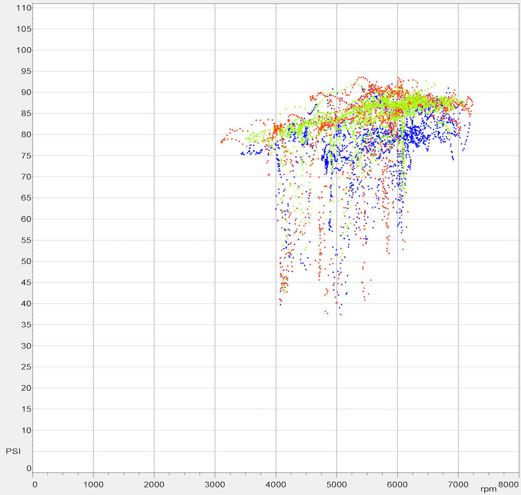

So what I have found?
I began by choosing 3 representative fast laps from different events and plotted oil pressure against rpm. What this reveals is that rpm never drops below 3000 rpm and normal oil pressure ranges from 75 to 90 psi. There are numerous transient occurences of lower pressures, down to about 35 psi. These event do not appear to be rpm related as they occur widely over the range of rpm values.
Name:  3 OP vs RPM.jpg

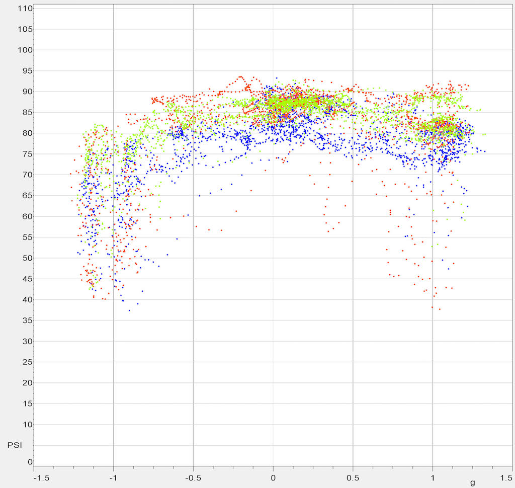

Looking at the same data vs lateral acceleration confirms that the transients occur primarily at high lateral g.
Name:  5 OP vs Lateral.jpg

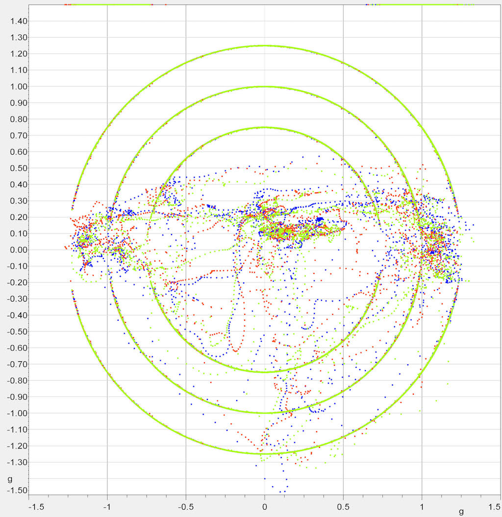

To get a better idea of the accelerations in question, we can plot a friction circle for the three laps.
Name:  7 OP Friction Circle.jpg

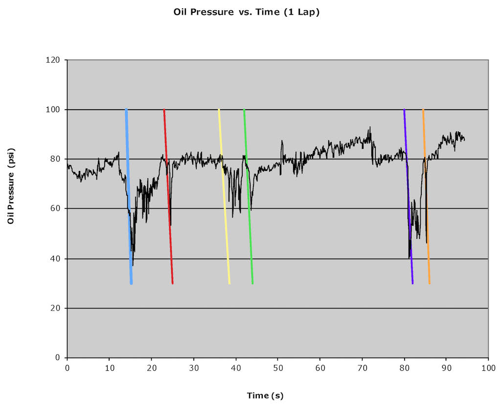

While the scatter plots above provide and idea of how widely the oil pressure varies, it does not show what exactly triggers a transient event, and how it progresses. For that, we look at a single fast lap against track position, identifying each major transient event with a colour code.
Name:  8 1 Lap Transient.jpg

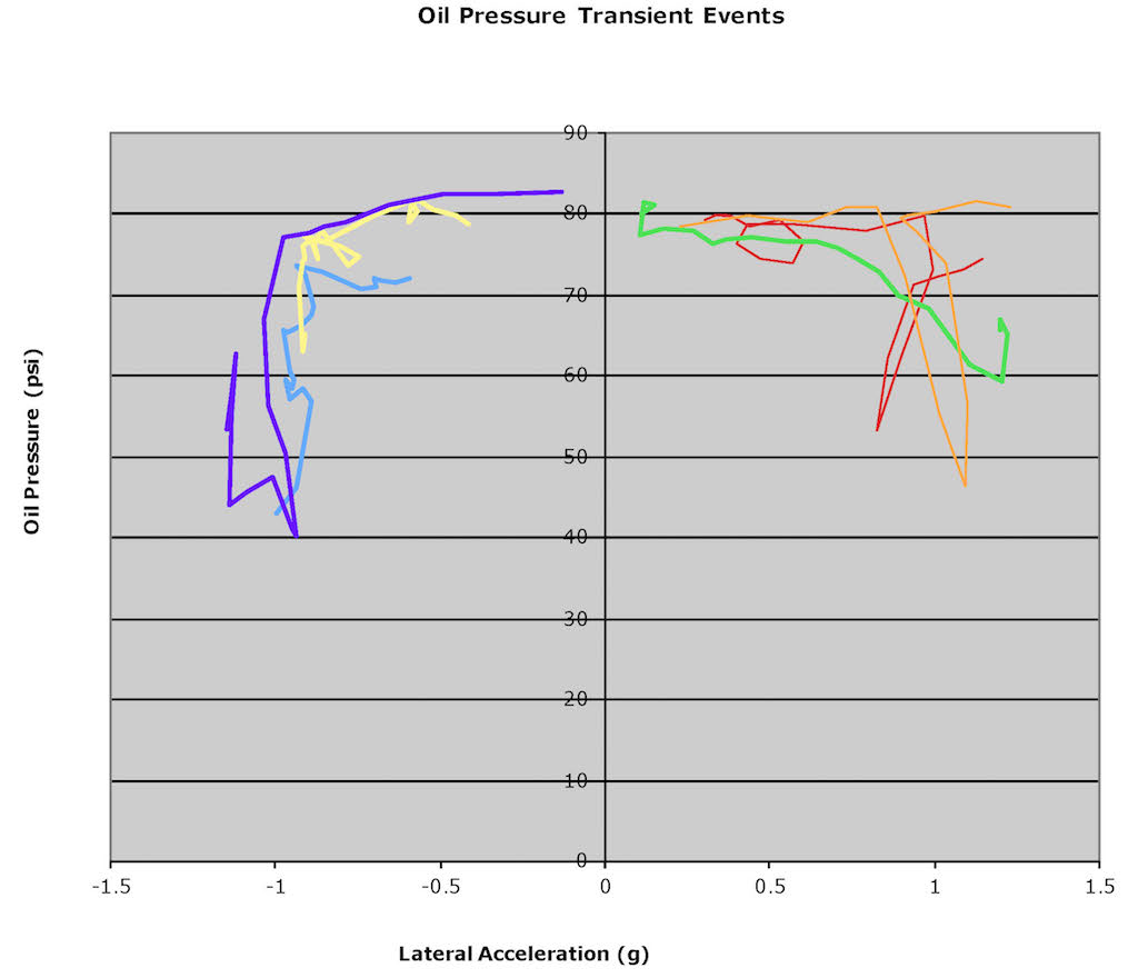

Then for each transient event, we plot oil pressure against lateral acceleration, as the acceleration rises and until the transient begins, using the same colour code.
Name:  9 Transients.jpg
Here we can clearly see that the trigger is lateral acceleration approaching 1-g. Once triggered the oil pressure becomes random. It appears that high lateral g is required to trigger a transient event, but that oil pressure does not necessarily imediately return to normal as the lateral acceleration eases. While this track has more right turns than left, left turns are more prevalent, and longer lasting

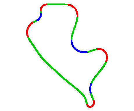

The upper right corner of the track map below is turn 1, and the track runs clockwise.
