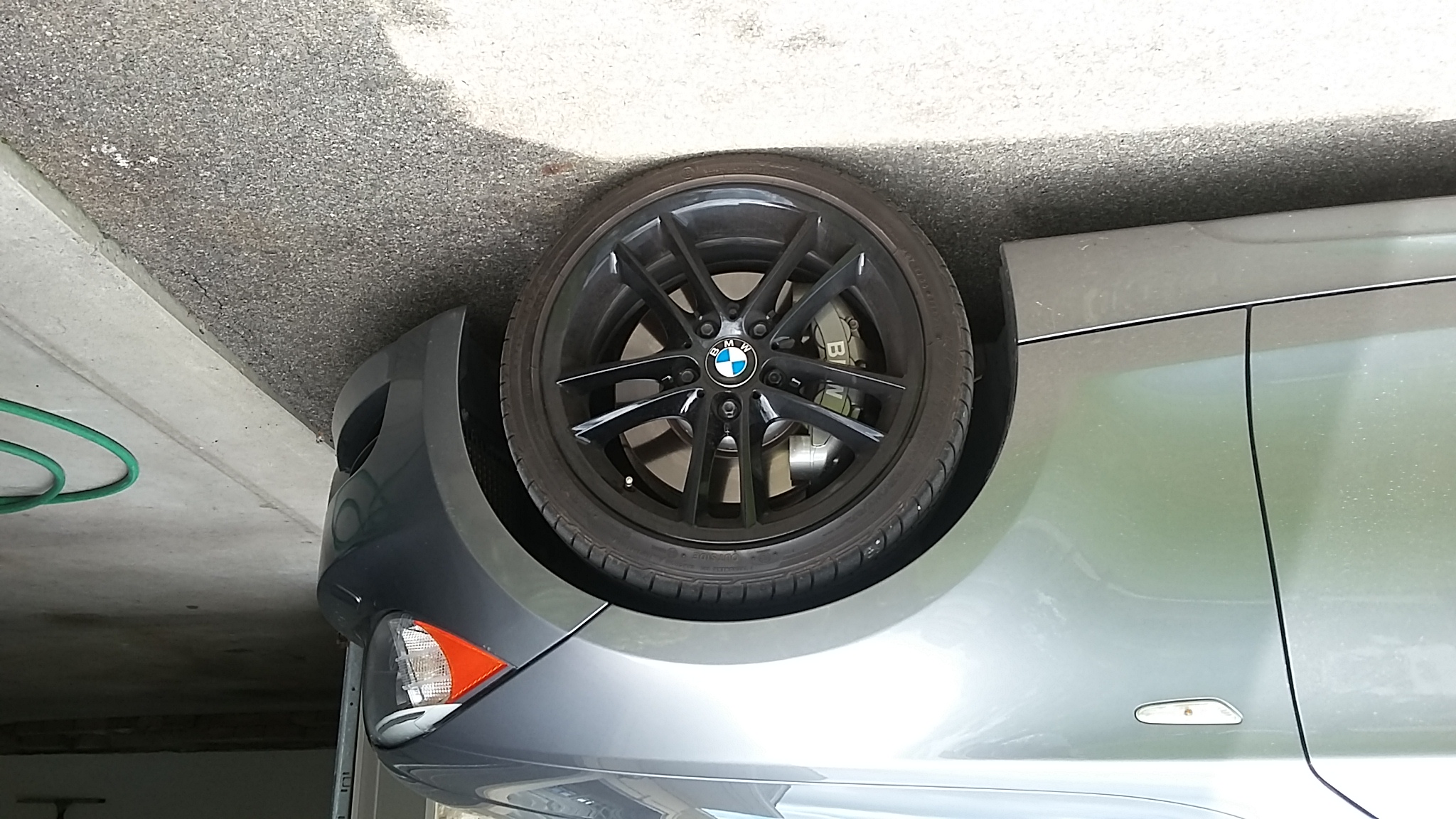

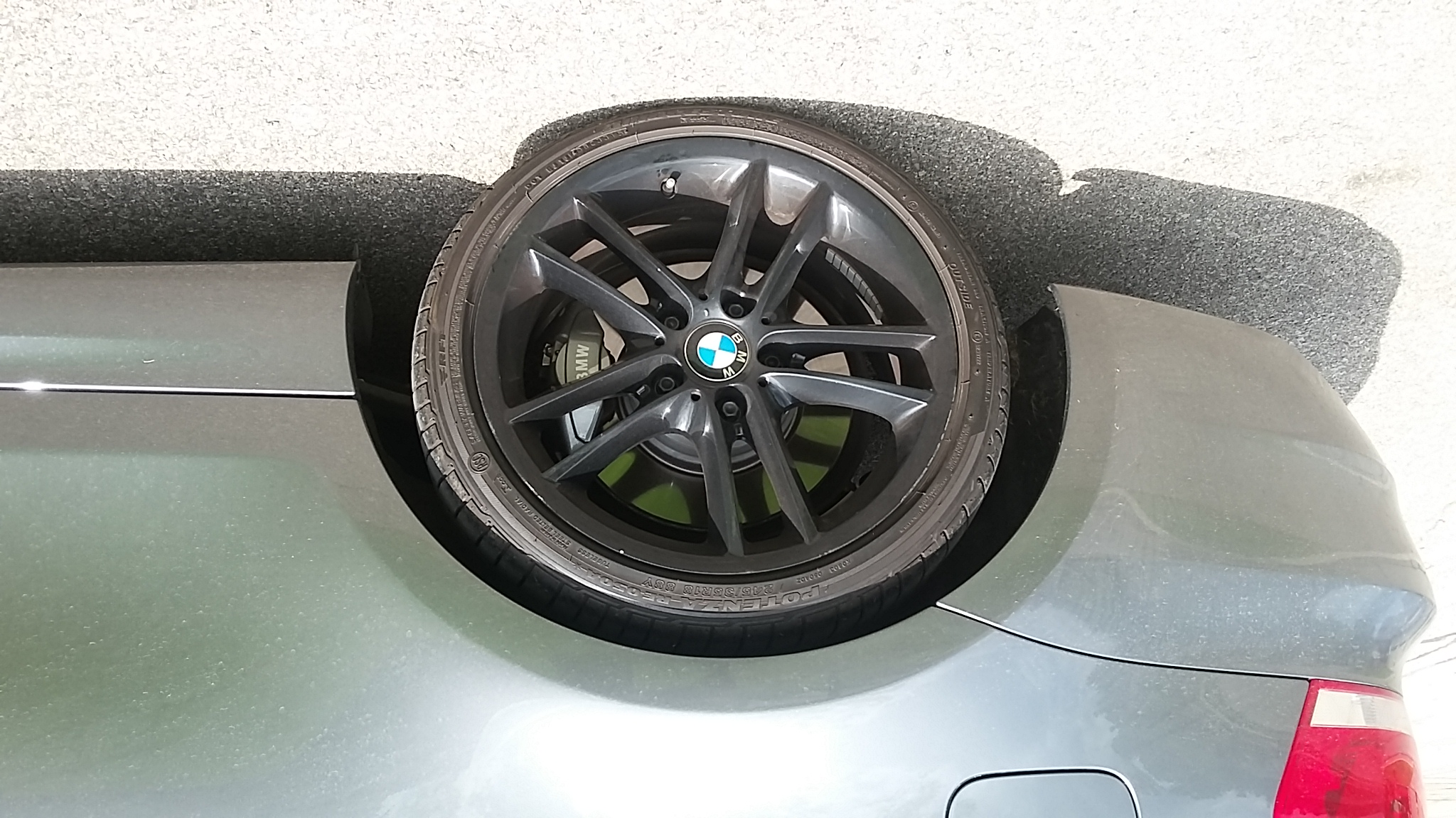

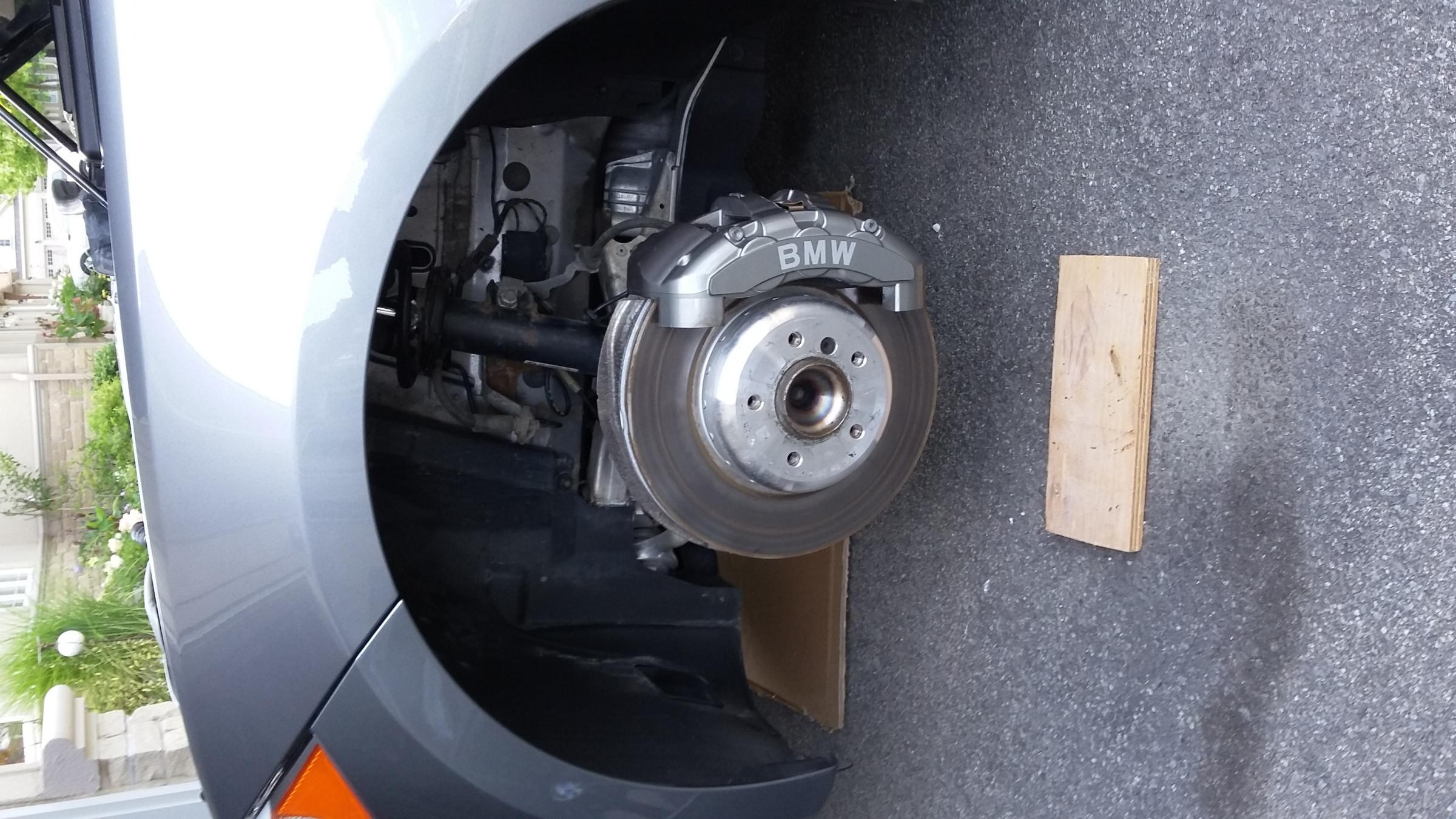

Thanks again! I am just speculating right now because I'm looking at used cars but many of them do not have brakes like my current 135i. To me the standard calipers look awful. How would you describe the setup on my car as shown in the pics? How would you identify these?

People just refer to those as the oem 135i brembo's. It really is extremely dependant on which model you end up getting. I think some of the F series brakes are interchangeable, some might require a bracket to be able to adapt, or some might not be. Referring to your original question of putting Brembos on a BMW which doesn't originally come with them, sometimes you can but a BMW Performance part which will be straight bolt on, sometimes you might be able to interchange like I mentioned, sometimes you'll just have to get a full non-oem brake set to get that look. It really depends on a model by model basis.
