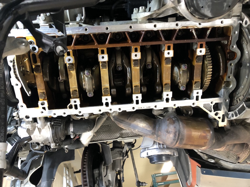

My rod bearing change proved relatively uneventful, with some wear visible on the old bearings, but nothing alarming.
Name:  1 Block.JPG
Bottom End

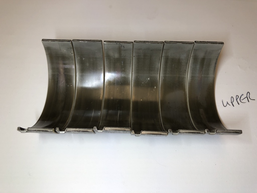

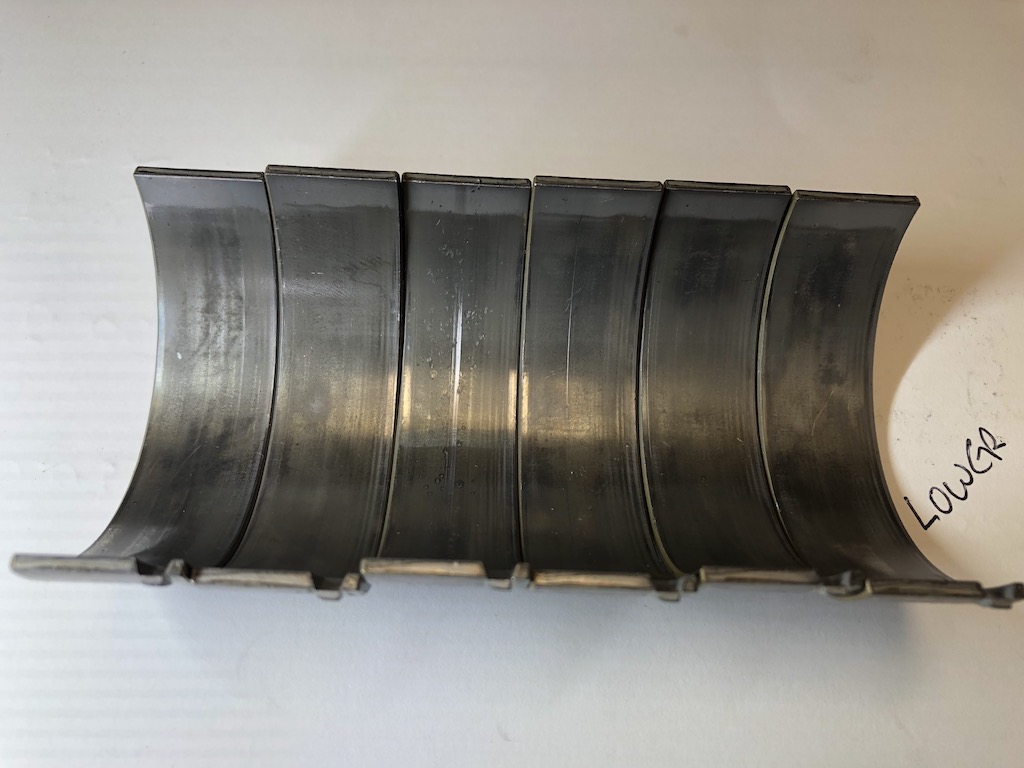

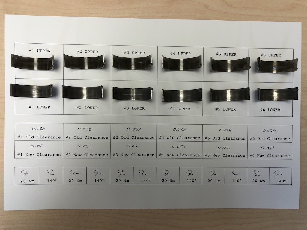

I checked clearances before and after with Plastigauge.
Name:  3 Lower.JPG
Lower Bearings
Name:  4 Upper.JPG
Upper Bearings
I used King replacement bearings, which provide slightly more clearance (0.051 mm) than original (0.038 mm).

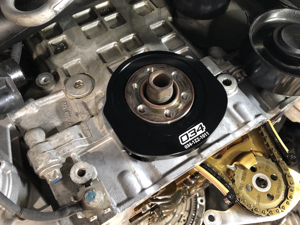

There are a few options when choosing a crank seal guard. I chose one by 034Motorsport. With the intercooler, radiator, the crank pulley removed, installation of the guard is easy.
Name:  5 Guard.JPG

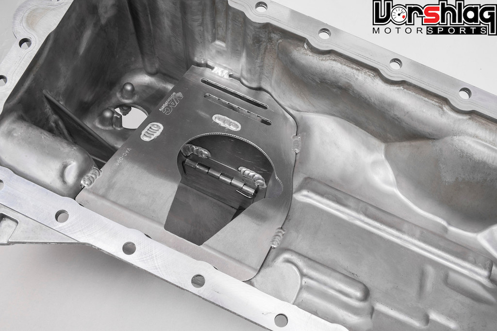

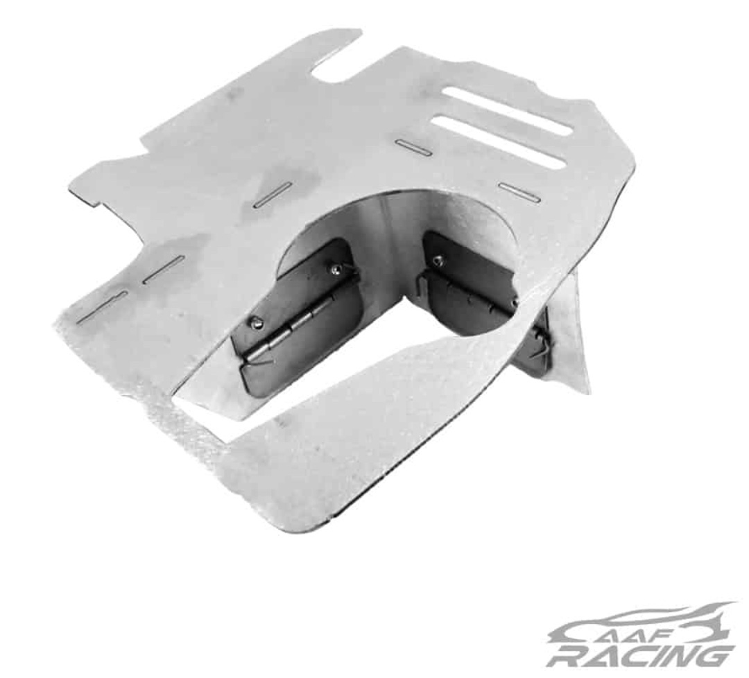

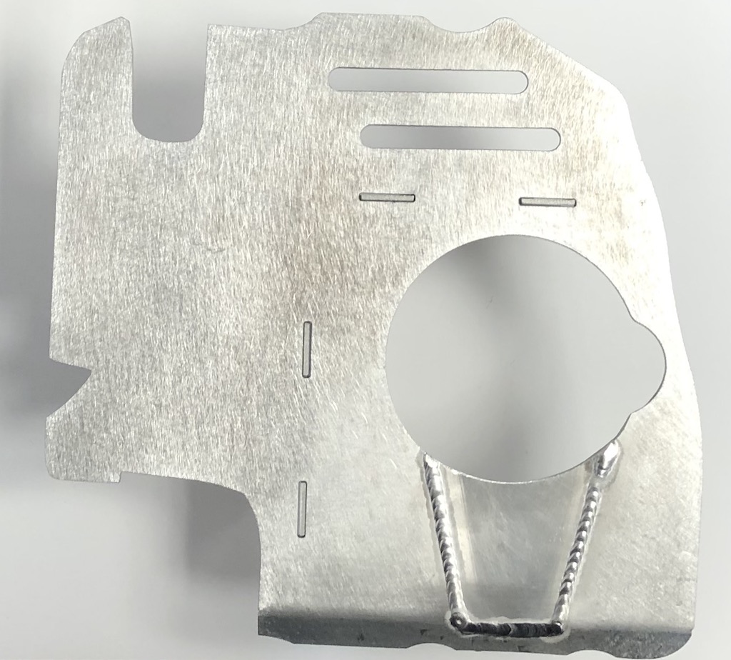

When it comes to the baffle, there are a few choices. I chose the AAF baffle because it encloses a larger oil volume than the VAC baffle.
Name:  6 VAC Baffle.jpg
Name:  7 AAF Baffle.jpeg

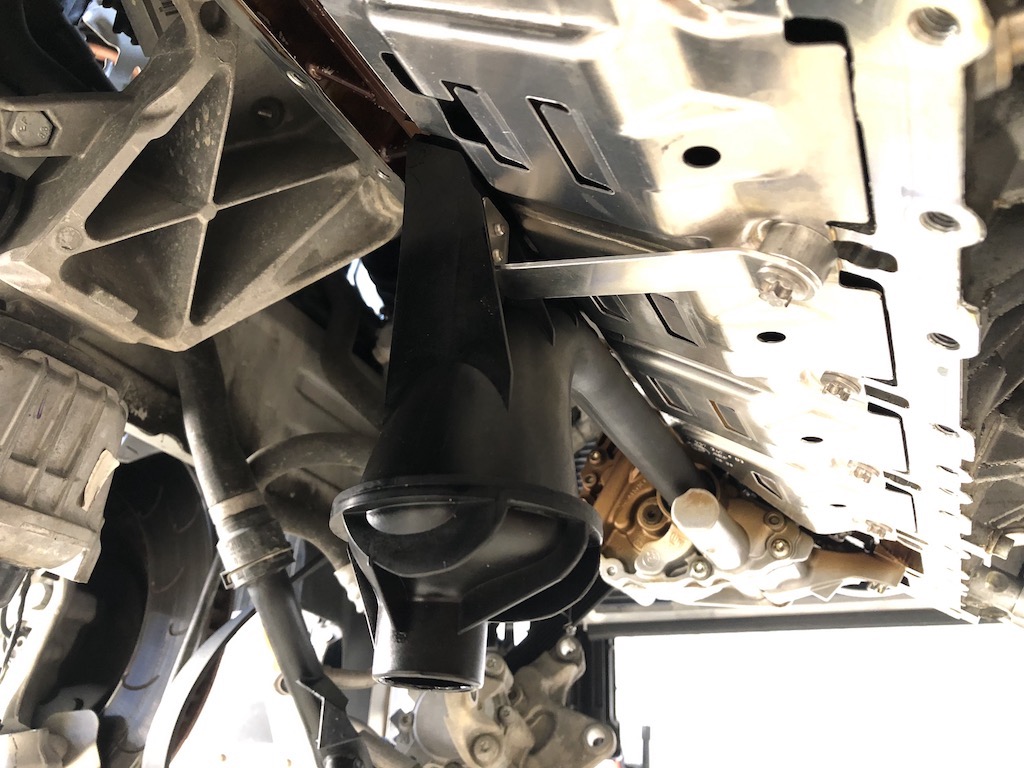

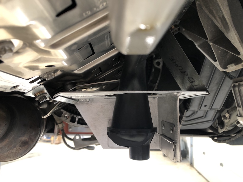

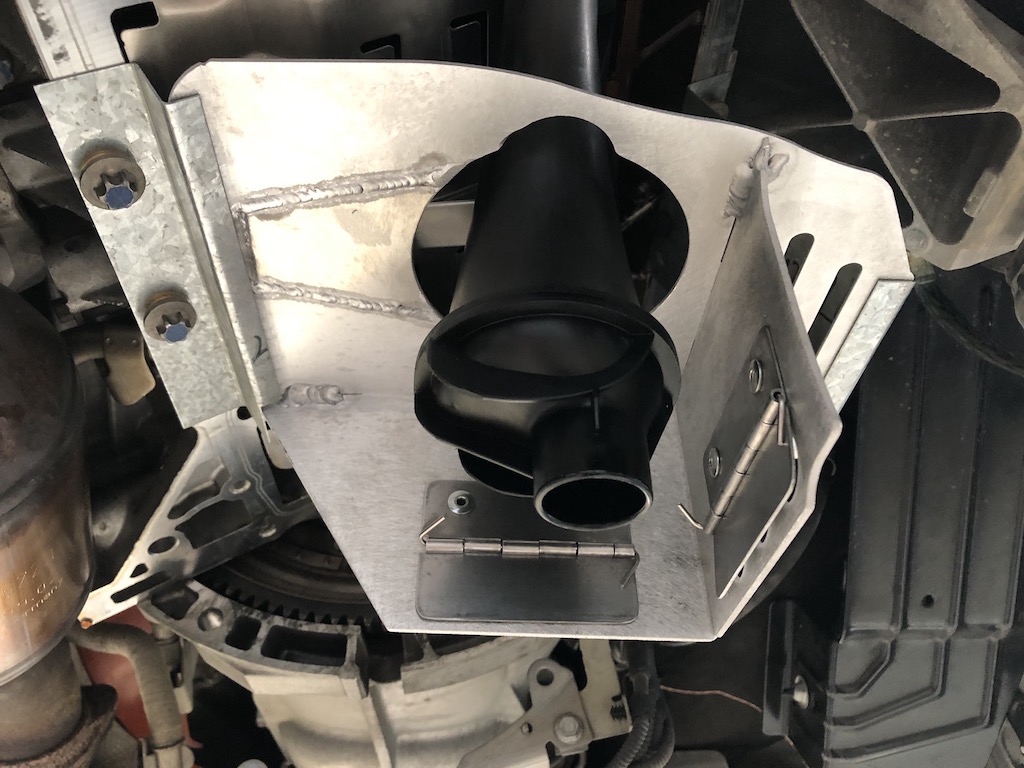

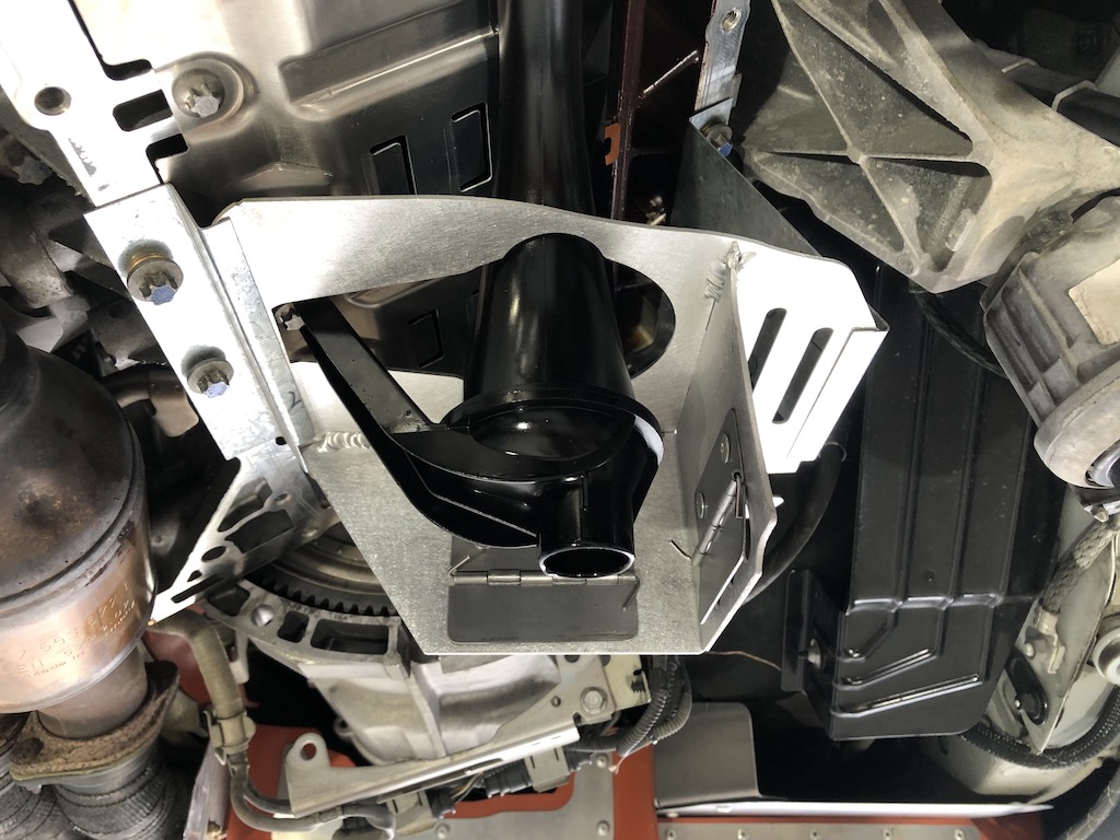

Both incorporate a keyhole shaped cutout to accommodate the support leg on the oil pickup tube. To my eye this is a serious deficiency in the design, as the keyhole slot will allow oil to pour out of the sump through the slot under left turns. Essentially, the slot negates the whole point of having a baffle. The following image shows the relative position of the pickup and baffle without the oil pan in place.
Name:  8 Unmodified 1.JPG
Name:  9 Unmodified 2.JPG
The above images show the baffle as built mocked up in place.

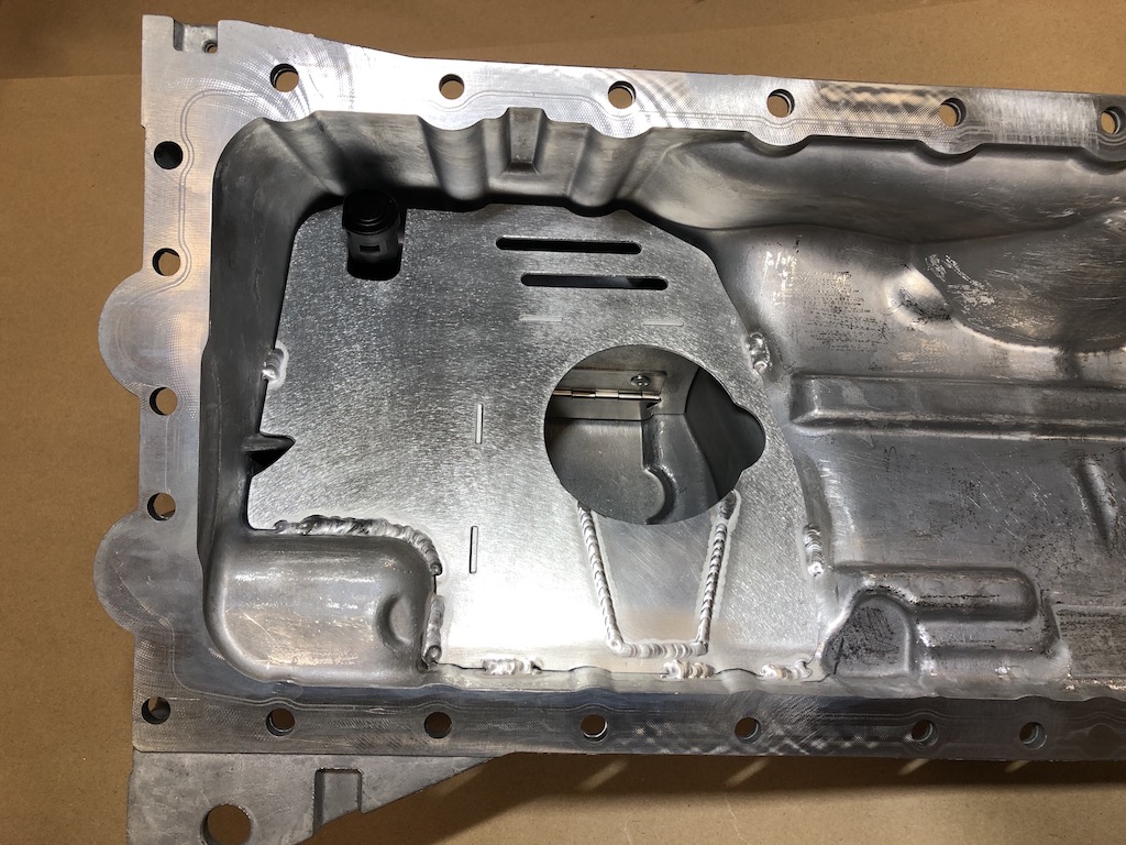

To address my concern, I welded a plate to block the keyhole.
Name:  10 Keyhole Mod.JPG

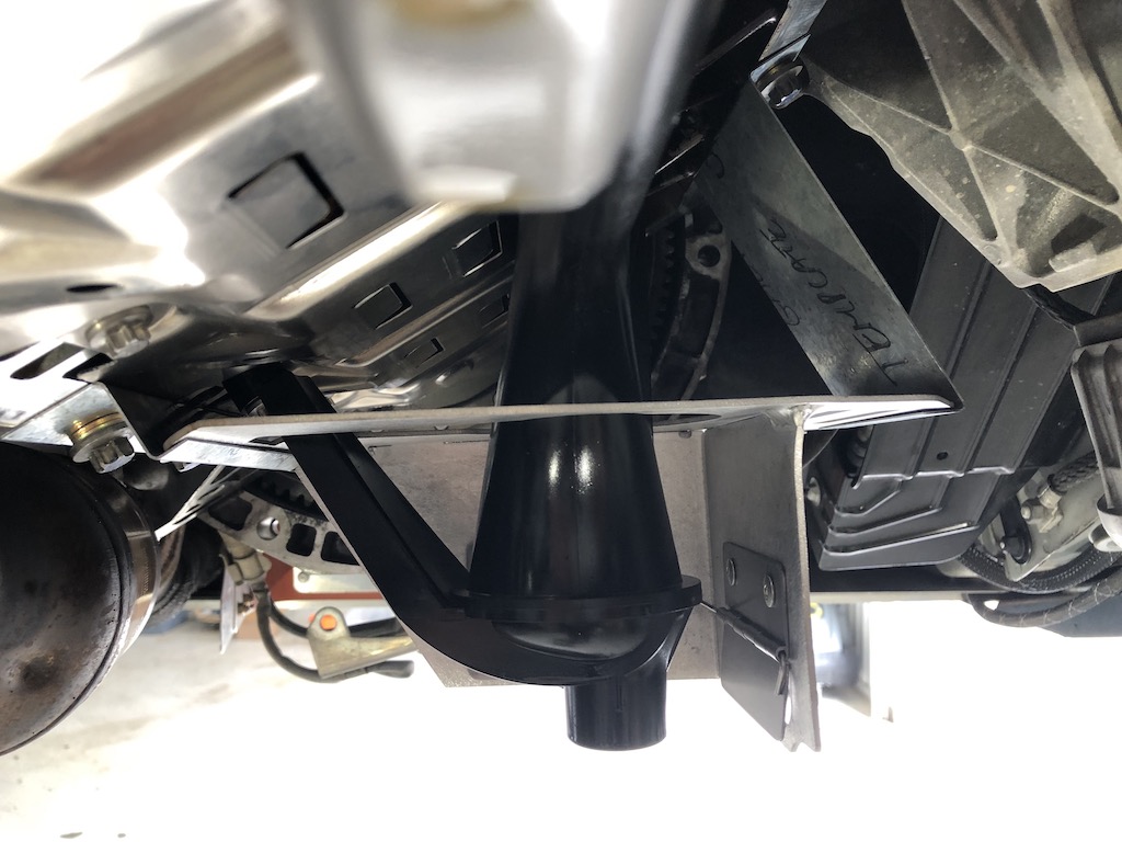

Blocking the keyhole required removing the diagonal brace from the oil pickup tube. To recover some strength and stiffness, I installed an aluminum brace.
Name:  11 Oil Pickup Mod.JPG
Name:  12 Modified 1.JPG
Name:  13 Modified 2.JPG
Of course the baffle needs to be welded into the oil pan. The pan came with no instructions for installation, so welding is up to you to figure out. The sump is ENAC AC-46000 alloy (BMW conveniently casts the alloy identification into it). This means that 4043 filler is a good choice for welding. The sump appears to be anodized, so it is necessary to abrade off the anodic layer before welding after first thoroughly cleaning and degreasing the sump. I preheated the sump to 100°C and welded with TIG. The baffle required a small amount of fitting to form a tight fit on the critical right hand side. The sump was no worse for the wear after welding, showing no signs of distortion.
Name:  14 Baffle Installed.JPG
The total oil volume below the baffle top plate is about 4 liters of which perhaps half is effectively constrained and available during cornering. Assuming an oil flow rate of 40 liters per minute (about 10 gpm), the engine will consume 2 liters in about 3 seconds. In other words, the baffle might provide only a few seconds of protection unless inflow into the sump replenishes the volume.

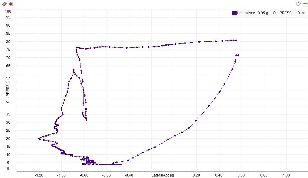

I intended to write up my results, and started doing so, but basically found that I was splitting hairs so fine as to be indistinguishable from confirmation bias. I looked hard expecting to find a benefit. One big challenge is that the low oil pressure transients are very sensitive to oil level, so controlling for that in back to back testing of the with baffle and without baffle is difficult. Add to that the fact that the baffle does virtually nothing and it is easy to see what you want to see. The other real difficulty is finding a test track that reliably produces consistent transient responses. I have such a track close at hand. At the critical corner the transient trigger is very distinct and occurs at about 0.85 g (initiated by a dynamic transition from fast RH corner to long slow LH corner after with braking and unweighting at the transition). The depth of the transient and the time taken for the oil pressure to recover is alarming if the sump is not overfilled.
In short, I really couldn't come up with any conclusion except that the baffle does very little, if anything to improve transient oil pressure. I don't believe a baffle makes things worse, so I am not about to take it out. In my view:
1) overfilling 0.5 to 1.0 litres is essential regardless of configuration
2) an accumulator helps a bit but will be defeated if 1) isn't satisfied
3) a baffle provides no meaningful benefit
