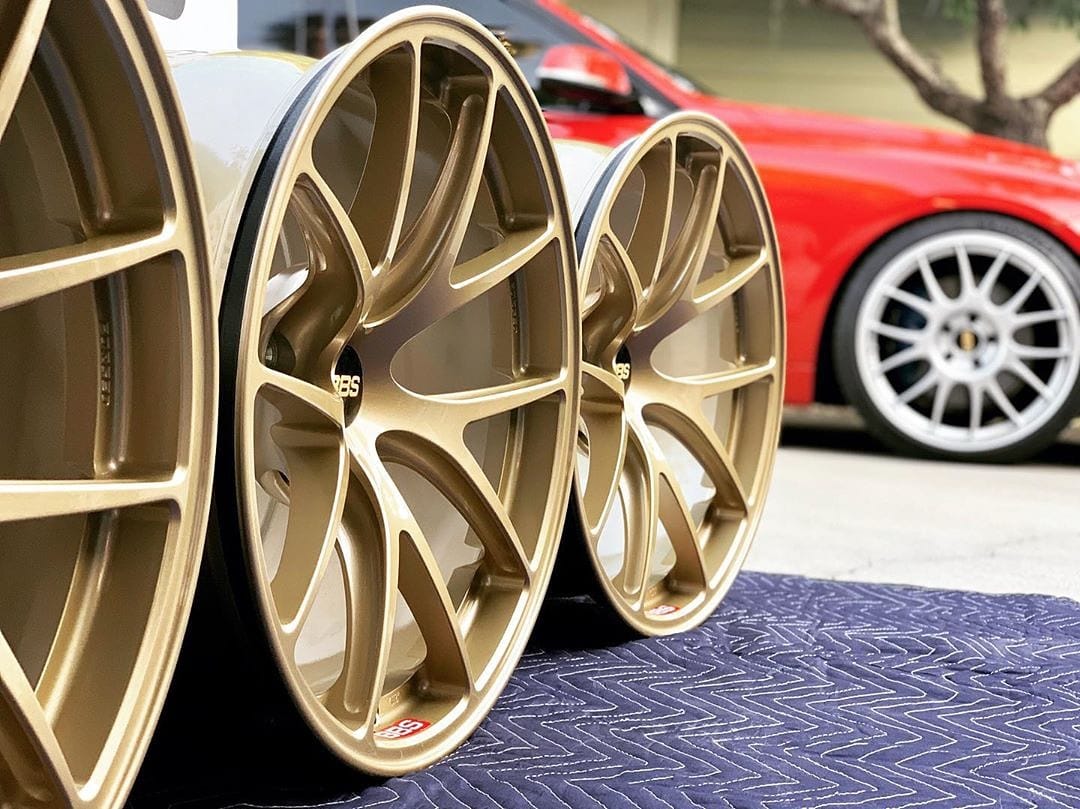

Ever since I saw the Blue M2CS with gold wheels I've been obsessed with gold wheels for my Montego Blue 1er.
I've always wanted BBS wheels which are basically custom made for virtually every BMW in history EXCEPT FOR THE E82!!!
Lo and behold, BBS makes a gold finish on the RI-A wheels which will supposedly be offered in a 18X8.5" size with 34 mm offset. With 7.5 mm spacers, this would be perfect for a square setup on my 128.
I know I could fit 225 mm tires because I have them now on a 17X8" wheel with a 40 mm offset. I just don't know if I could wedge 235s under there.
Am I crazy or should I just get my OZ HLTs powder-coated in gold?

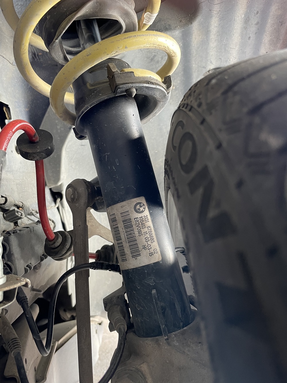

Originally Posted by Thunderguts View Post
...I don't see how I could fit 245s in the front...I'm almost sure 245s would rub, but it would depend on the profile of the tire and the struts you're using.
Originally Posted by $iriu$black View Post
Is that true? Calling in Suprgnat
Currently Koni/Swift, 17x8.5 ET40, MPSS 225/45-17, ~323mm from wheel center to fender lip, ~2.75° camber. Clearance is good to the fender. Clearance is good to the strut and perch.
YMMV
Awkward perspective photo:
YMMV
Wow! That's a TON of clearance. I'll need to jack up my car this weekend and give mine a more thorough inspection. I'm only on 17X8, but you have a lot more camber. Maybe, just maybe a 245 is possible. Any idea what your ride height is? I've got T1 BMWP springs which are a lot softer than Swifts. I think it's supposed to sit 20 mm below the M-Sport suspension.
YMMV
Thanks for chiming in Suprgnat! Weird perspective indeed, from that pic, it looks as if the 225/45 PSS is too “narrow” for the 8in BW wheel.
Now if only anyone can show pics of anyone who is running Öhlins coilovers w a 17x8 wheel with 245s, that would help a lot our OP.
8.5 inch. It's the maximum approved width for that size Michelin tire per Michelin. Also, the BW wheels have beefy inside lips (and yet weigh under 17 pounds).
