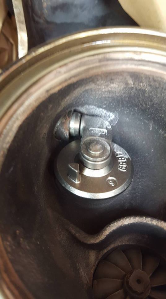

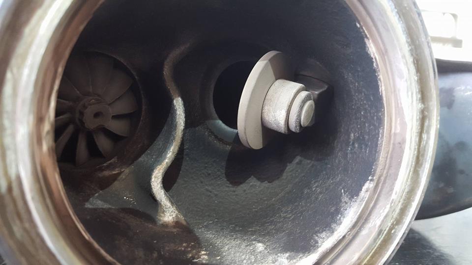

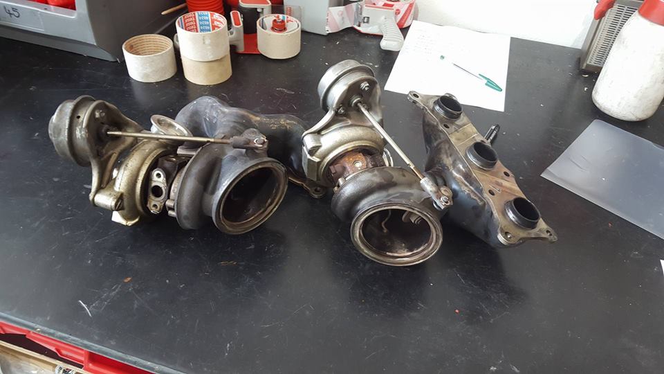

A German friend of mine with a 2008 tuned 135i developed the dreaded WG rattle last year. He found a shop in Munich that rebuilds turbos. They replaced his WG valve and actuators - and his rattling went away. He's quite happy with the outcome. It was a lot of work R&Ring those turbos though. think he paid about 500 euros(new BMW turbos are around 1K euros each over here) for the new WG's plus he paid another shop to R&R his turbos. This fixed his rattle in his 135i with 400 PS.
Name:  Wastgates 135i  11903941_10153456785603567_9169551274529777467_n.jpg
wg before...
Name:  Wastegates 135i   11873717_10153456785848567_6263372842914780824_n.jpg
wg after... notice the larger triangular weight on the WG valve.
Name:  Wastegates 135i  11885109_10153463655528567_5386154452180217981_n.jpg
