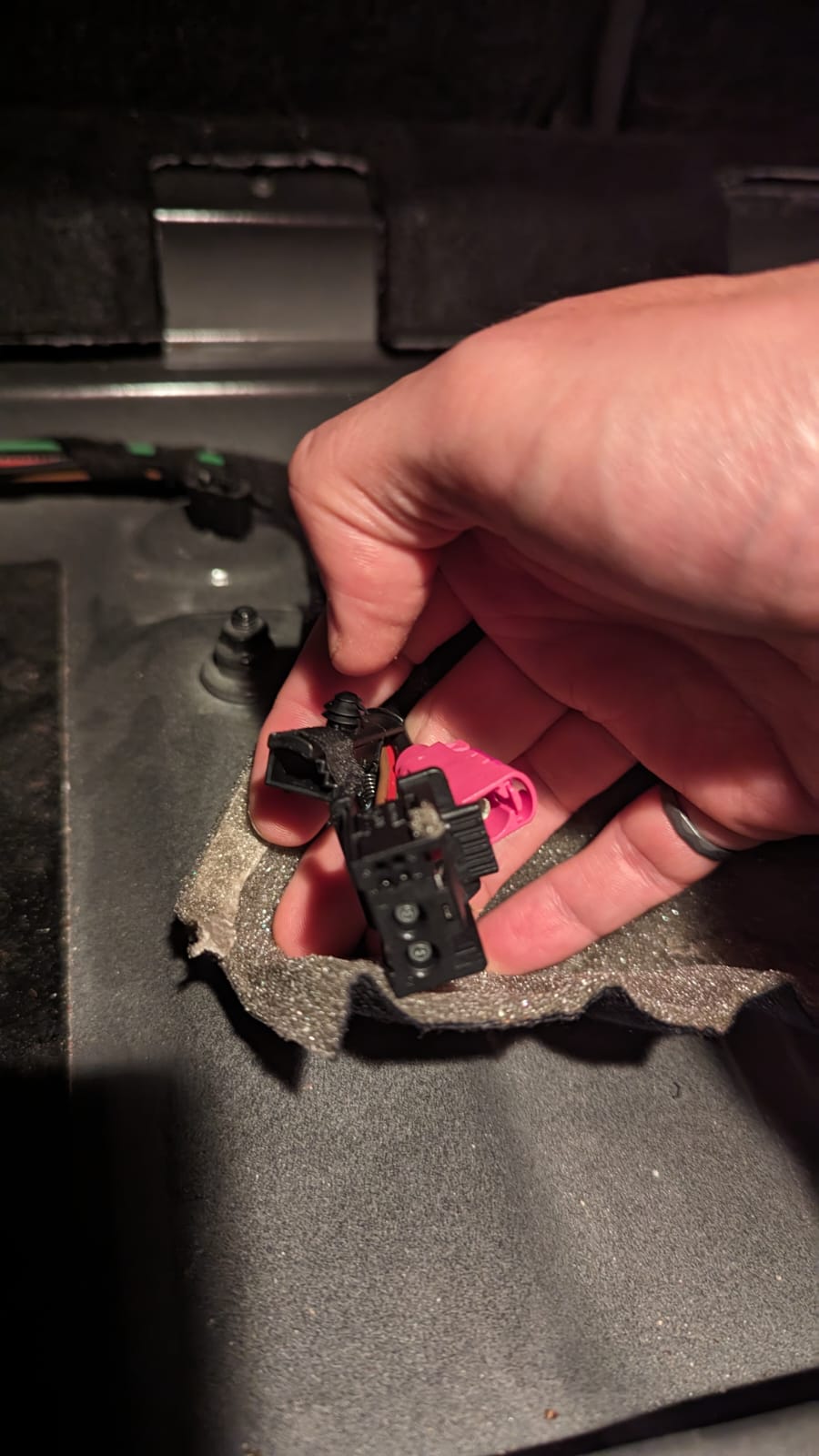

I'm deciding what kind of work I'd need to do to install a combox that works with my BMW Professional unit, I looked at the back of my 09 128i and found these cables. Do you know if I get the correct combox that I'll able to connect to bluetooth audio and make calls?

Did you ever get this all sorted out? I'm looking to add BT audio streaming (for 3rd party CarPlay unit) and upgrade the BT Phone sound quality in my daughter's 2012 E88 with the Business radio. Right now the phone sound quality sounds very low-fi. Would just swapping in a newer multimedia combox from a CIC car address this? Plug and play?
