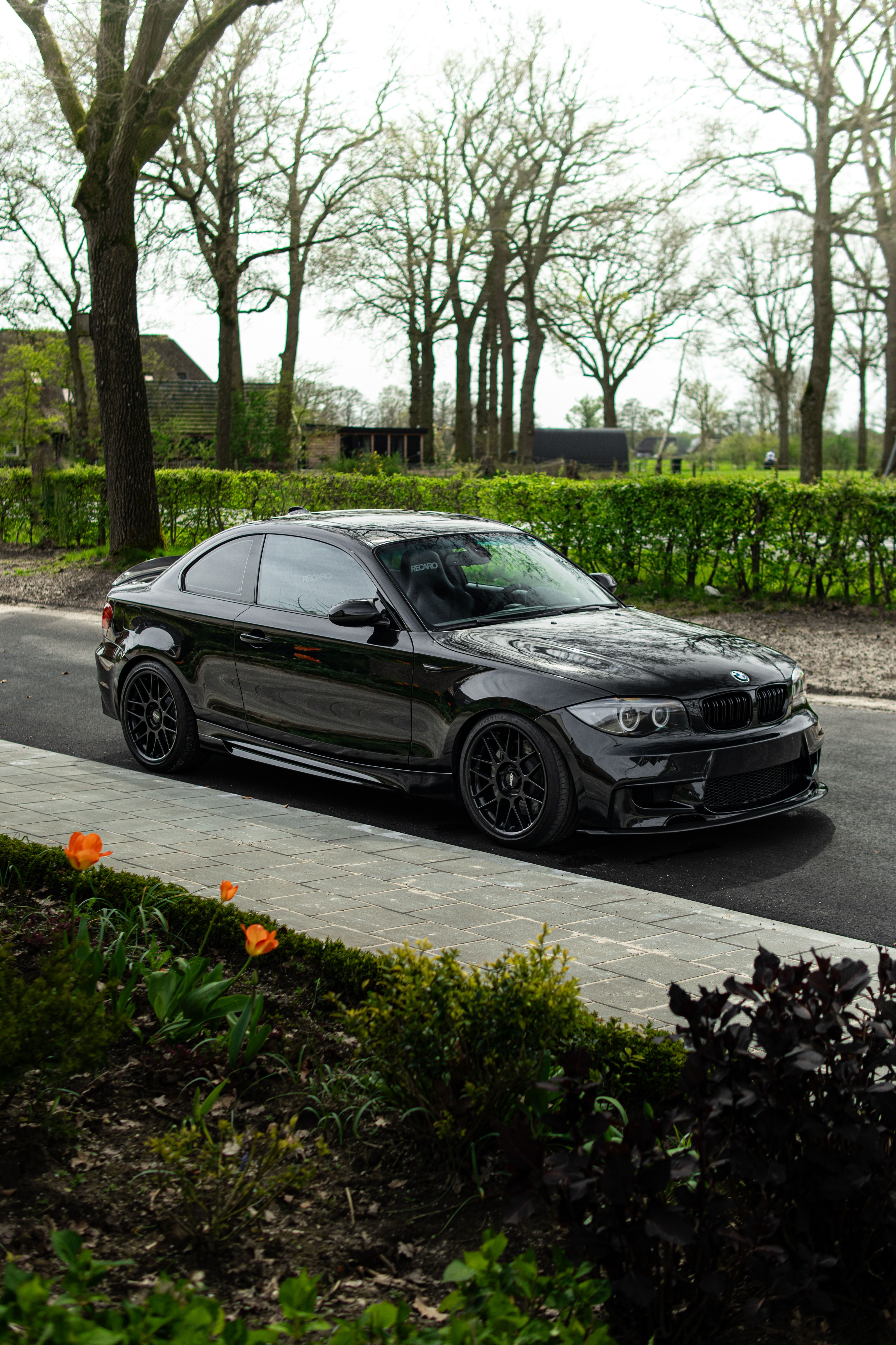

Photo Credit:
Owner's Instagram: @nieves.e82
Photographer: @msdfoto
18" staggered ARC-8
Wheels:
ARC-8 in Satin Black
Front: 18x8.5" ET45
Rear: 18x9.5" ET58
Tires:
Goodyear Eagle F1 SuperSport
Front: 225/40-18
Rear: 255/40-18
Photo Credit:
@veldmannn

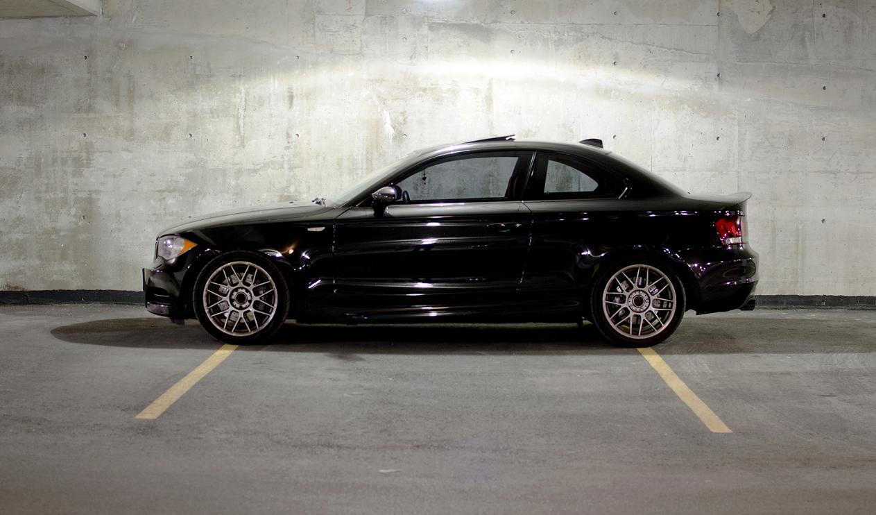

Total Lubricant's 135i:
  • ARC-8's, Hyper Black, 17x8.5" ET40
  • Maxxis RC-1 Tires in 255/40/17
  • Eibach Suspension
  • Negative camber in the front
  • Rear fenders rolled

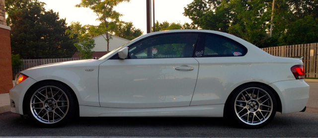

1987 911  [0.00]
2011 135i  [0.00]
Here is mine:
- M3 suspension swap
- Dinan Camber plates
- 245/35 square michelin pss
- ast4100/swift
- No Rub or Fender rolling
