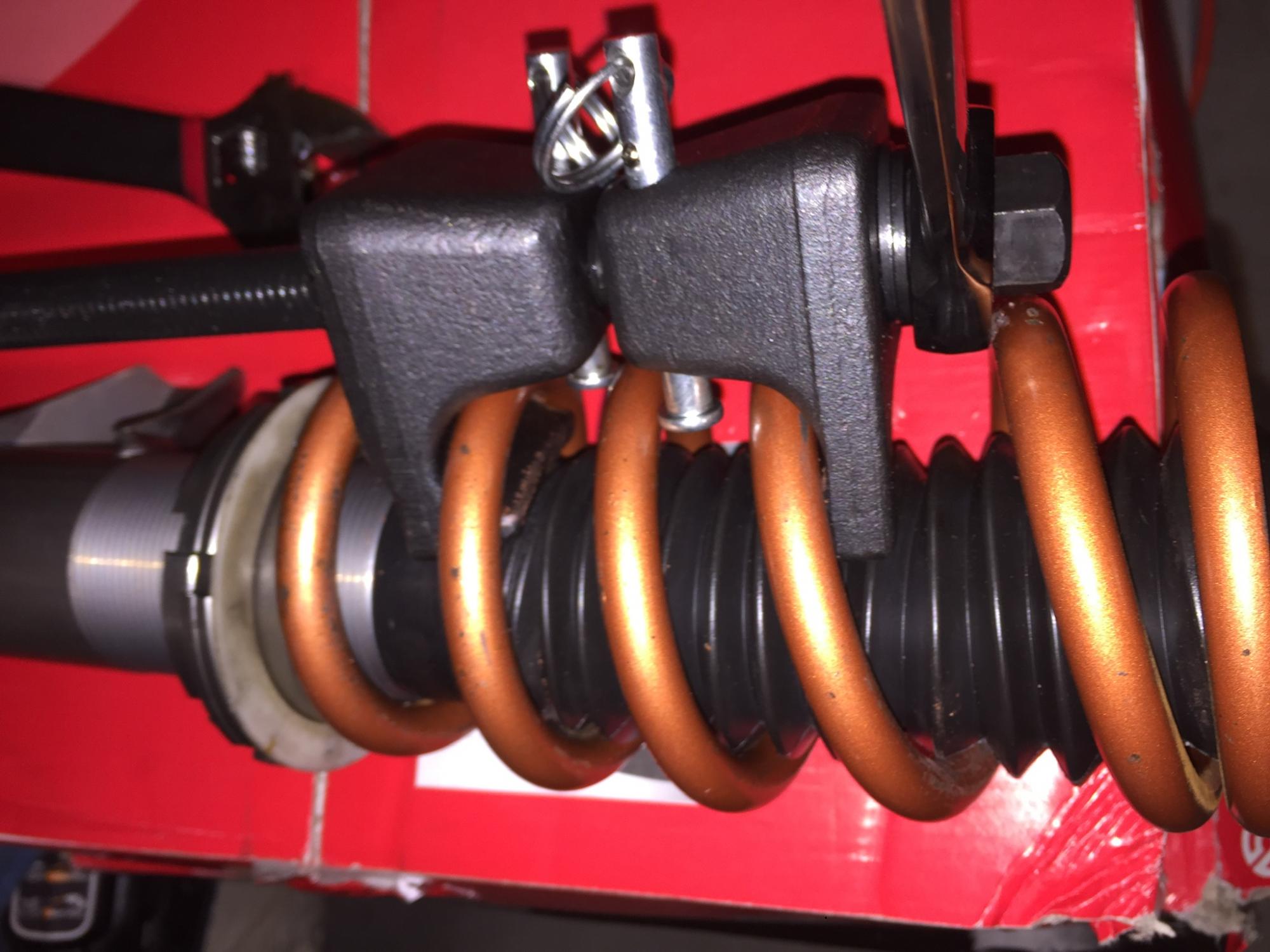

Spring compressor mistake - ratchet tool is stuck
So being a newbie to this tool (made all necessary safety measures), I mistakenly used a box end ratchet (not open-ended) 19mm and as I tightened one compressor, the box end got stuck under a coil Can’t take the tool off! To make matters worse, it is stuck in the “tightening” direction. More I move it, it gets tighter. I stopped short already, just so I have a bit of space in case I have no choice but to cut the compressor. But this poses risk of course since the spring is compressed. What an idiot I am
Hopefully that made sense. I used the run of the mill OEMtools brand compressor and realized that it “barely” fits on a Swift front spring. I still insisted and was able to get it in there but the other pair can barely “bite” the spring so now it’s all lopsided, biting on one side and stuck to the new strut.
Is there a way to get this without cutting the thing?
Help!

Springs flex. Probably take a bit of leverage, but it looks like you've got some room to move it out of the way of the wrench, at least long enough to unstick yourself.
Yeah if I can just raise that part of the spring that’s directly hitting the ratchet, I would be good. But I ran out of ideas earlier and gave up. These cheap compressors are the worst. I didn’t know why I tried to make it work when it clearly didnt.
I don’t have a bench vise that will help with leverage which is too bad. I was thinking of a way to open or spread that gap up, but again, my idiot mind ran oit of ideas. Clearly I’m a novice in this area🤦🏻
Someone told me to just cut the wrench close enough so it will not spin, then use another wrench since there’s enough of the nut still exposed to loosen it. Cutting the compressor itself is not a good idea I keep telling myself.

Do not cut the compressor! That spring is under hundreds of pounds of load. You will almost certainly hurt yourself if you cut the compressor. All that energy stored in the spring will be released suddenly. You will have a spring, two halves of a spring compressor, and a cutting tool all flying in different directions.
I do think cutting the ratchet as short as possible, then using a different wrench on the exposed part of the nut is the right move. But cutting tool steel isn't fun, and less fun when there is a compressed spring attached to the tool. And even less fun without a vise. Whatever you do, be careful. A shop might be better equipped to get this done safely.

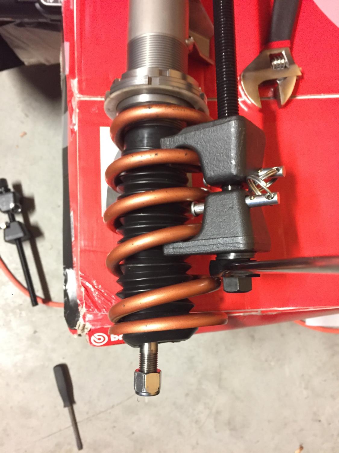

Can you use the other spring compressor to take some of the pressure off? or a ratchet strap to take some pressure off so you can release the other one?

I don't have a solution for you other than to get another set of compressors to take the strain off of the stuck one.
I have to ask though; why are you using spring compressors on coilovers? My Öhlins have plenty of thread to completely unload the spring for installation/removal purposes...

I assume you bought the horseshoe type of compressor? They come with different size 'shoes' and I think you should be able to get them set up to compress the assembly.

Double nut the bolt side. Should be able to turn it from that end.
Thanks for the advice and kind words. My problem is the stuck tool is a ratcheting box end. So it basically blocks any further rotation going the other way if I try to loosen it up from the bolt side up top, does thatmake sense?
I believe I don’t quite understand the double nut method on the bolt side i mean I’ve done double nut methods on installing studs on wheels but that’s it.
Thanks for the advice. I think the ratchet method will be my plan B in case using another conpressor with smaller claws won’t work.
Problem too is since the spring is so narrow, having the compressor clamp on to one side of it pushed it stuck into the shock body so it’s harder since I’m working with the strut along with it.

Solved
Thanks to all for the sage and useful advice.
I've used another set of spring compressors with smaller claws, freed up the coil from the strut. Then, with careful planning this time, positioned the new compressor on the coil to free up a gap above the ratchet. Swore to myself never to use that compressor again.
Glad I did not have to cut anything, my tool or god forbid the compressor. My tools are mostly of the GW brand, not expensive but not cheap either.
As chris_flies said, I screwed the height adjusters low enough to tighten the top nut and used a 5mm hex to counter. Still have to torque it down to spec.
