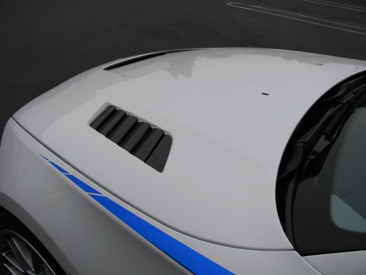

Since you bumped this insanely old ass thread, im kind of curious bout the Vors hood. First, are the vents open? If so, what about water getting down into the intake side, specially with a dci? I know the vents arent as close to the middle as say the ICarbon csl hood but still, same question. Also, are these still in production and if so from who and can they be painted before shipping?
