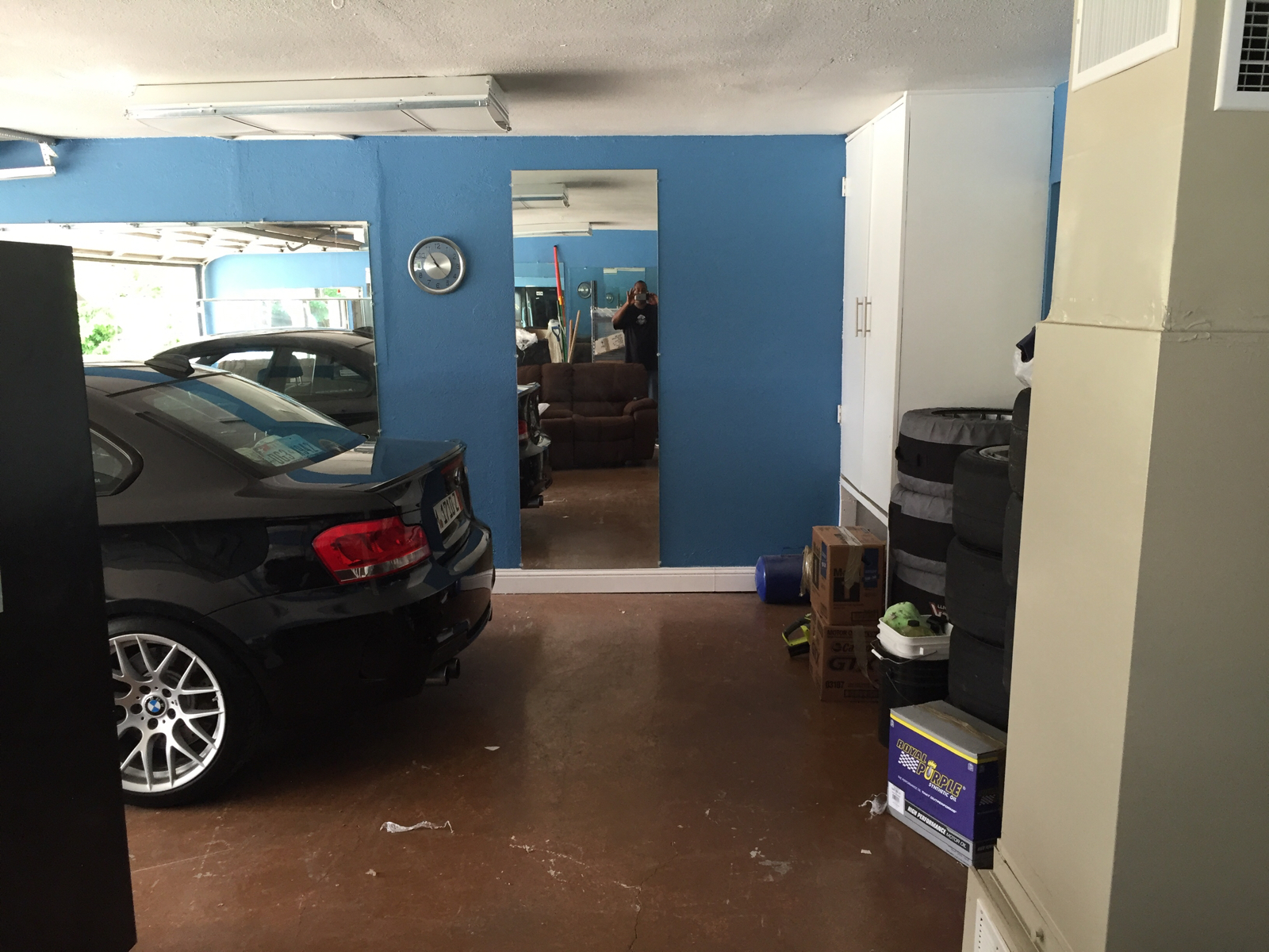

The garage pic shows the 285/30 Bfg R1s in Tire Rack covers stacked next to the 275/35 Maxxis. Yeah it's that much more tire. !
Note - The third stack of tires was either 5
loose tires or 18s for my X1 with a loose tire on top.
