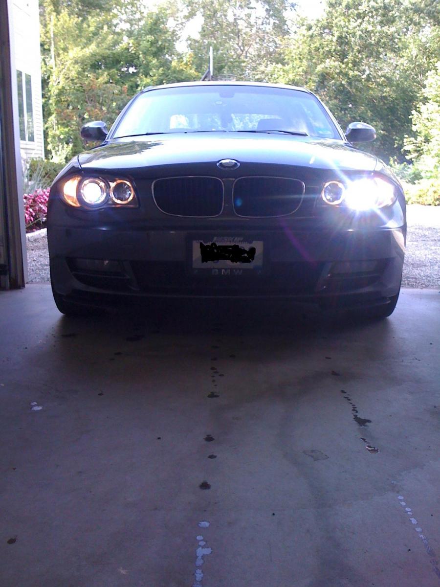

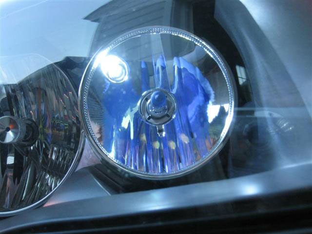

Do you guys know if this LED (pic 1) fits the AE for the Depo's??
Bulb is 194 T5 which does fit the OEMhalogen headlights parking light bulb location on our cars. (pic 2 is my car with them in)
I'm considering ordering the depo's, these LEDs for the AE and maybe an HID kit (or at least 6000K Halogens). I just hate the yellow AE look.

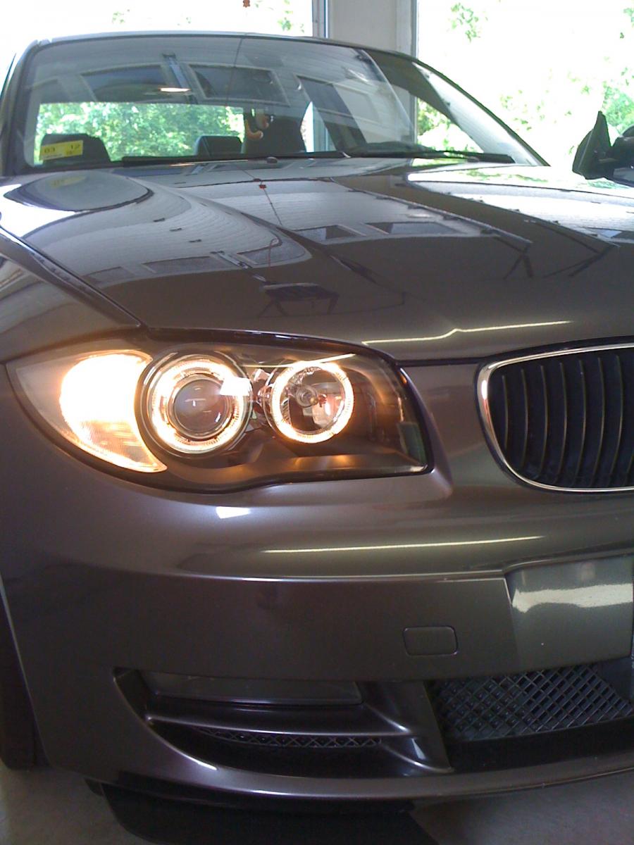

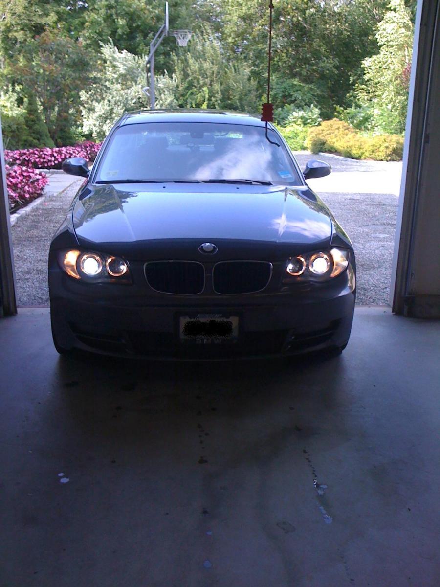

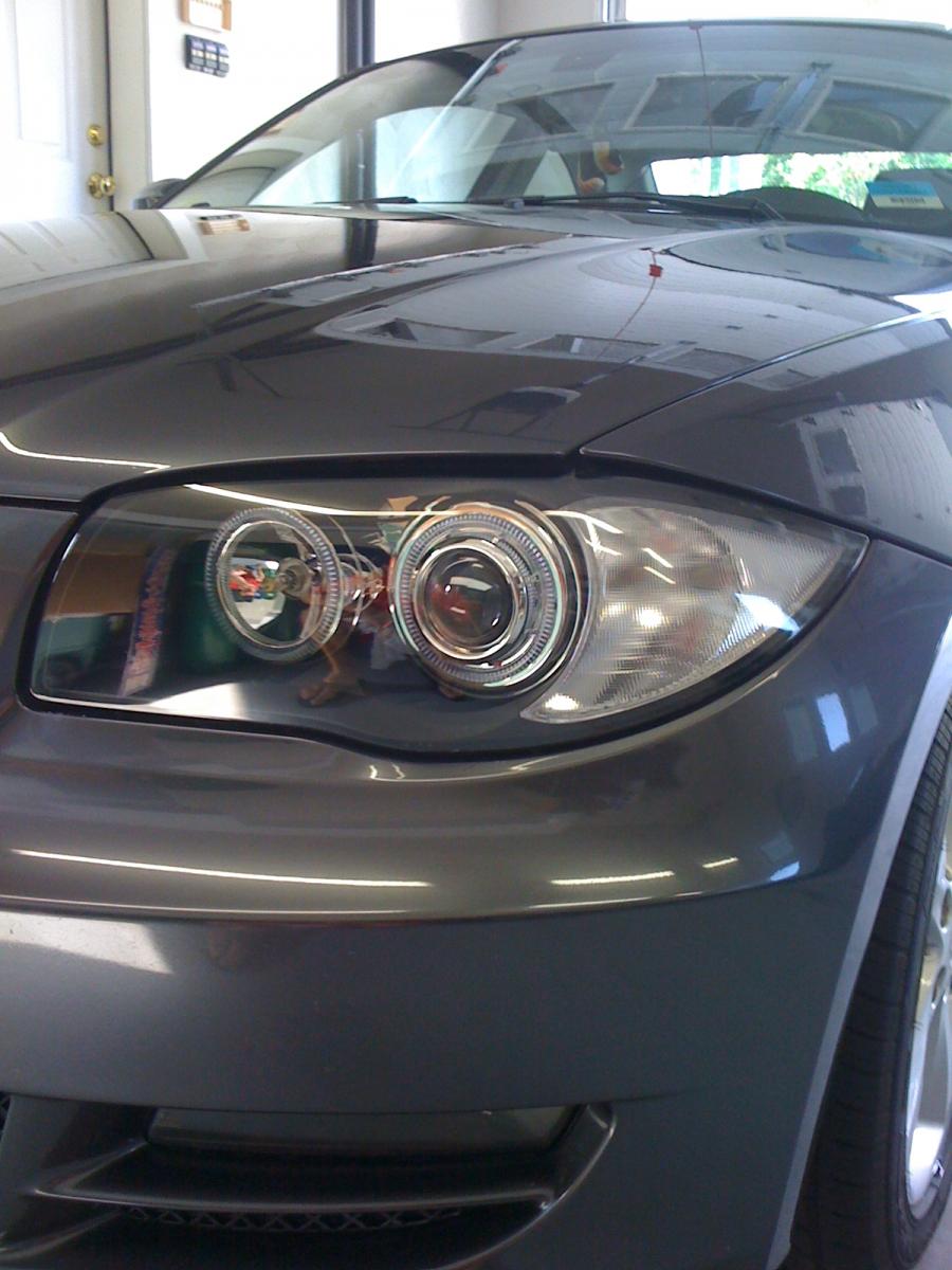

Finally, here are pictures of the depos installed with my HIDs
