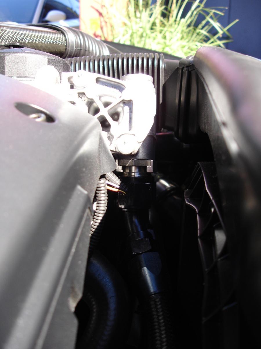

Very nice, agreed. Would love to see pics installed and a rough idea of the difficulty level.
Thank you,
here are some installation pics.
FYI,
the Stage 1 kit is very easy to install and does not require the removal of the front bar.
Lastly the mounting bracket visible in the pics was just the prototype made from aluminium, the finalised production bracket is made from laser cut 3 mm steel, that is subsequently powder coated.
Cheers,
JD.

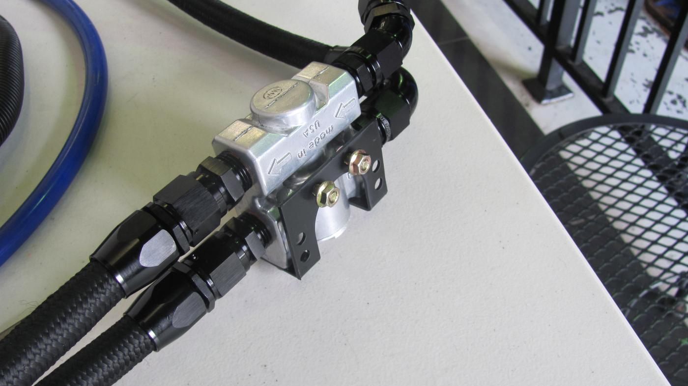

Hey Gents,
here are a few pics of our revised Stage 2 kit, being test fitted to our shop-car prior to delivery to another local customer.
This kit incorporates our revised choice of hose ends, fittings and oil line from Aeroflow, as will all future Stage 1 or Stage 2 kits.
The hose ends pictured are competition spec 550 Series "Full-Flow" fittings from Aeroflow.

To Justin@Advan:
Looking at the picture of your oil thermostat bypass plate....I've read that the left hose port (towards passenger side) flows out to the oil cooler and the right hose port (near drivers side) flows back into the oil filter housing. Is that correct?
I'm asking because in the picture you have the opposite flow going into and out of your external thermostat.?.?
Thanks,
S-
