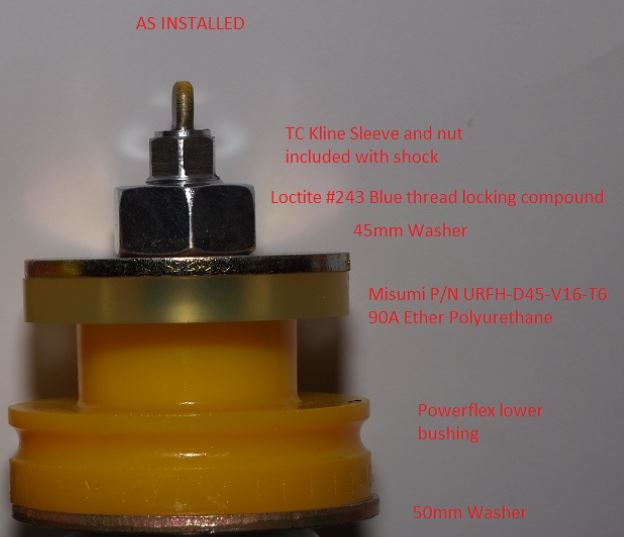

Hey Suprgnat I got a question...
What is this misumi washer for? I'm slowly working on my rear sus stuff and was curious as to what this was for.
The thinner upper bushing was needed to get sufficient thread to engage the mounting nut. I have TC Kline 1M/M3 SA rear shocks to go with the 1M/M3 camber arms and I guess the threaded portion of the upper mount on the shock
is shorter than stock. Others commented at the time about needing a solution to the same problem. They're the same Koni 8241-1200Sport TC Kline sells for the E36 and E46, at least the shock body is.
Inertia is the enemy!

Ahh okay I see. I was thinking that was done as a way to make the mount stiffer. Thanks for the clarification.
