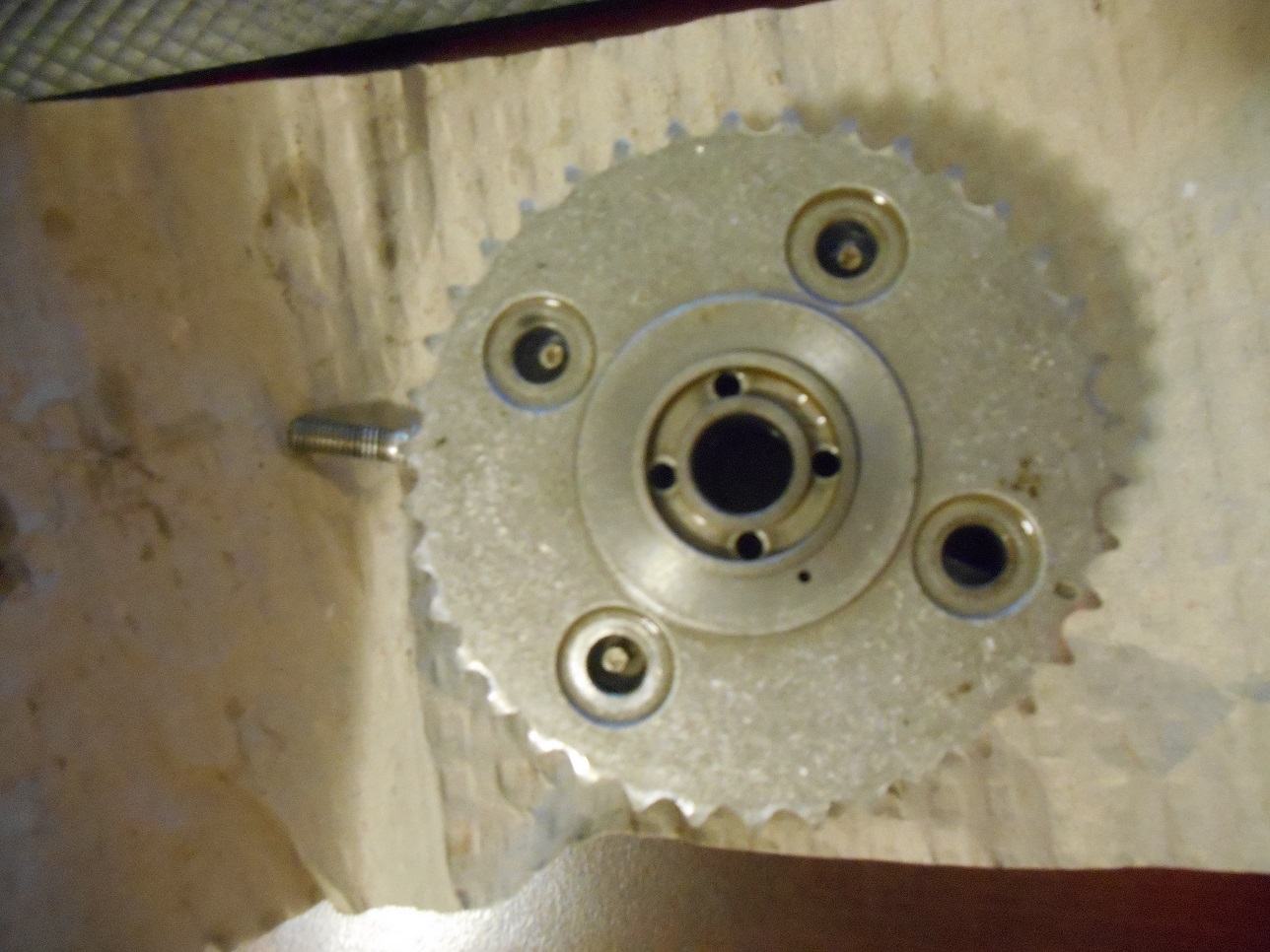

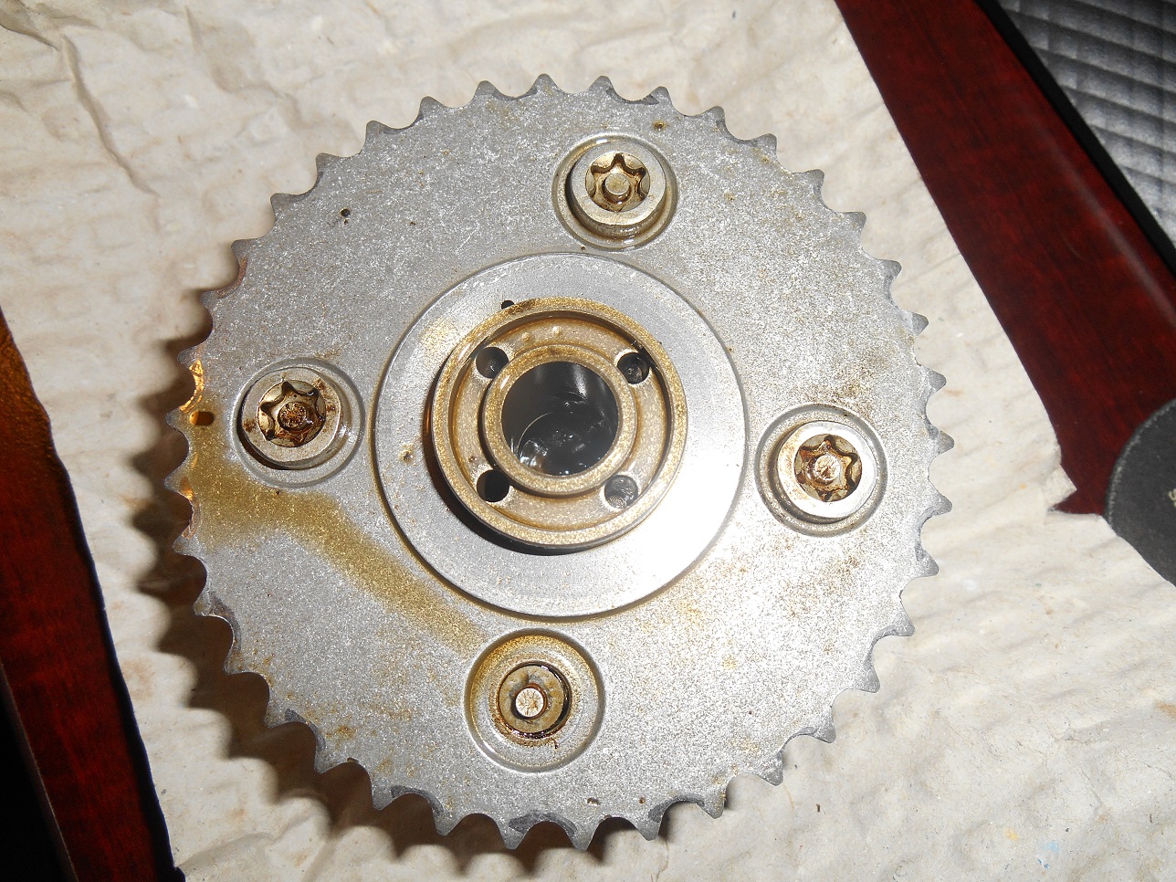

      10-02-2013, 11:40 PM   #61
SinCalgary
13
128
Drives: AW 2011 135i DCT M-Sport
Join Date: Aug 2010
Location: Calgary, AB Canada
Just got my 135 back today after having sheared off bolts on both Vanos units. MY car is a 04/2010 production date. I am 4,000 Kms out of warranty so I got the pleasure of paying for the repair. I will be giving BMW a call to discuss some goodwill as this is obviously a defect and I was unlucky enough to have it last through the warranty period just barely. Expensive and annoying to have to deal with.
      10-02-2013, 11:49 PM   #62
Slyncka
Drives: 335xi
Join Date: Jan 2011
Location: Minneapolis
Definitely do that, the more I look into it the more it's clear these engines have a manufacturing defect.
I thought this was interesting too. Maybe not important, but the amount of data out there is pretty large.
