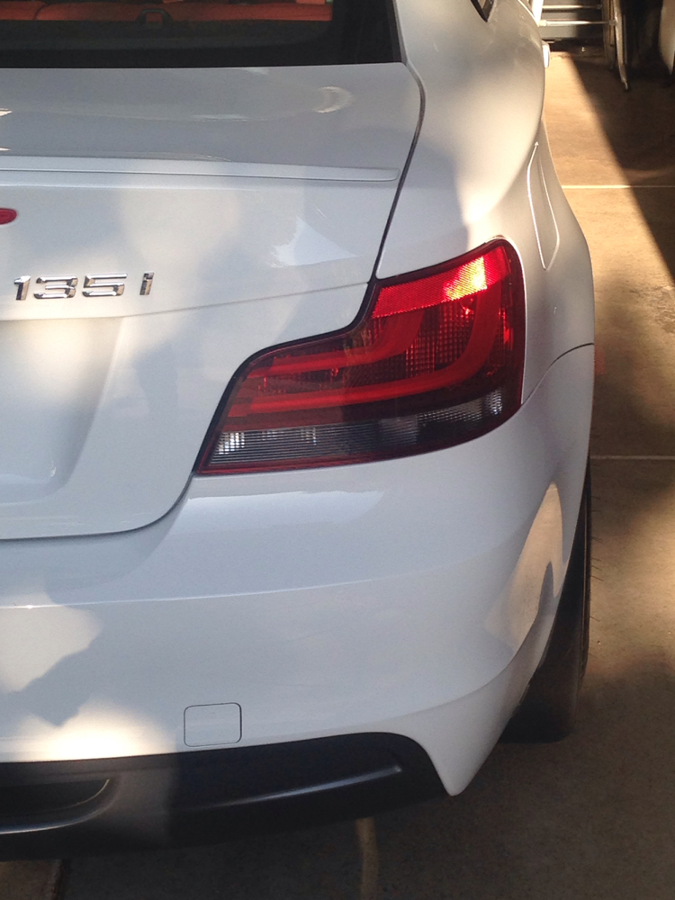

So when I got my '08 135 last month, I learned here about the tail light issue I was having. I thought about haggling the dealership for replacements, but I happened upon this thread and I was sold on these beautiful tails. I ordered from Schmiedmann, and spoke with a nice guy named Peter. They shipped via Fedex on Monday, I received the package on Wednesday. Today I grabbed an 8mm socket and installed them on my lunch break.
The reason I'm posting is to thank everyone who chipped in useful info in this thread, particularly Dackelone. You folks gave me tons of confidence to order the tails and do this swap myself. Cheers!

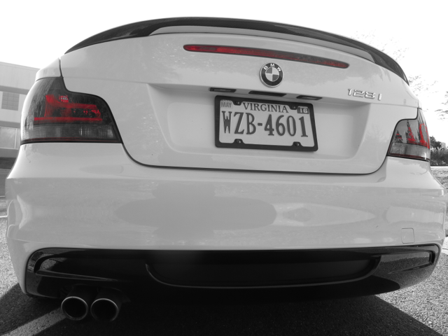

Here's me trying to be fancy but not working out so well. Haha. Too much glare and reflection. I'll post some better ones later. Thanks for your install guide Dack.
