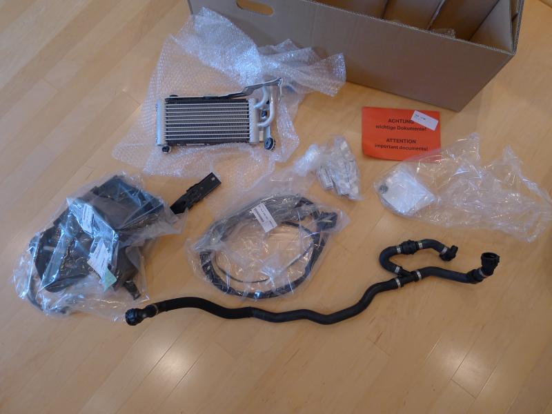

Don't know if anyone has ever posted the parts which make up the PPK2 but here ya go:

Well, considering there is an orange envelope there that contains the code to install the PPK program, he probably just bought a PPK2 kit, not individual parts.
Also, looks like you are missing the plastic vents that are required that do not come with the kit?
Yes, I ordered the whole PPK2 kit.
The plastic vents are in the plastic baggie in the first picture to the lower left of the auxillary radiator.
Ah yes, my bad! Enjoy the PPK2, you will really like it.
