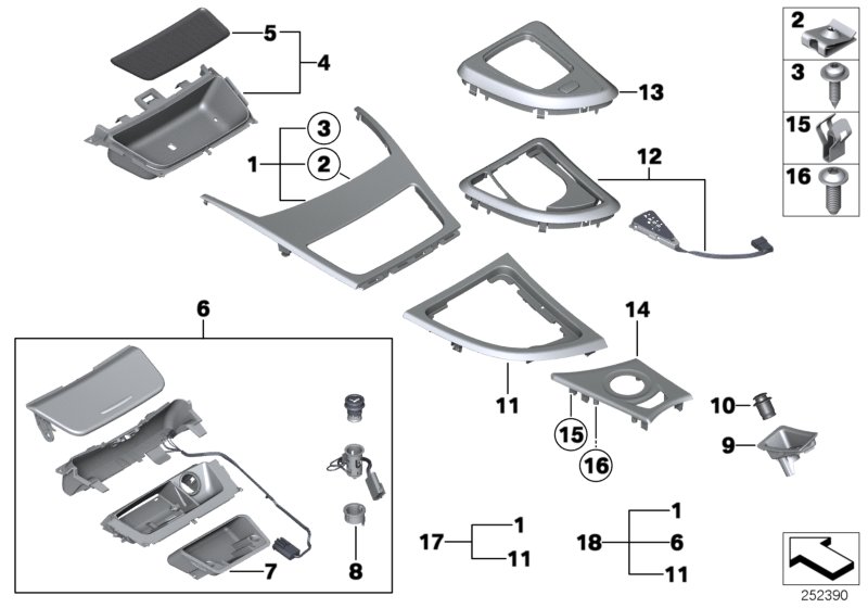

Hello all,
I'm installing the smokers kit in my 2011 E82 so i can get some power in the front. I've got the center console all apart and I'm ready to put it all back together but I don't see where I get power for the cigarette lighter? It has a plug on the end of it but I can't find it's match.
Shouldn't there be a cable for me to plug this into? Everything so far has been pretty much plug/play and idiot proof.
Thanks in advance for anyhelp.

When I removed* my ash tray to put in the storage box, the power cord came from the back side of the shift knob foam (I have a 6 speed). Is it possible that only cars that had the smokers package from factory would have the power cord?

My 1M has no "smoker's package," unlike my 135i coupe or my 135is convertible, both of which have them. I had a battery drain issue which turned out to be due to an unknown Lojack device installed under the back seat by the previous owner. Finding it required the entire interior to be taken out, or at least most of it, and there were wires and cables everywhere. Given the expense of this detective work, and already having the car filleted open, so to speak, I was looking for any tiny bit of value add I could get from this disaster. I asked the lead technician if I could have the front cigarette lighter adapter installed, e.g. smoker's package, before everything was put back together. What he said was that there was no way to do that, that a retrofit kit for that did not exist. I suspect he was talking in terms of whether BMW provides a kit like that for installation after the vehicle is produced, as an option.
But, this does not mean, obviously, that one could not take the required parts and find a way to hook up the circuit from a power source in the car. I'm sure that this could be done, but it might mean that a car assembled without the smoker's package lacks an immediately adjacent power source to connect, since the car in question was not assembled with that package. You might just have to cobble together something from the fuse panel.

Yeah it's starting to look like I'll have to rig up some molex connectors and tap the cables for the power adapter in the center console. I don't smoke but I need more power connections.

Just run some wires from the fuse box behind the glove box and be done with it. You can even use +12v that's on all the time or +12v that's only on when the engine/key is on.
That's really the solution, and also gives you the option of wire thickness and current draw, since you could choose what size fuse to run off of.

Can you supply part numbers and a source where you got the parts? I might be interested in doing the same.
Thanks.
51168051991 is the part number. I just ordered it online.
Is this one part sufficient, or do you need anything else, other than wires and fuses to grab the power? Thanks.

champignon View Post
Looks like that's all you need...
picture #6 p/n 51168051991
http://www.realoem.com/bmw/enUS/show...42#51168051991

I ordered the part from ECS, and it finally arrived. I plan to put it into my 1M.
Is this a job I should do myself, or should I take it to the dealer? There were no instructions accompanying the parts box. Does this parts set just click in where the panel over the area would come out?
For the Littlefuse part, do I need the ATO version https://www.amazon.com/Littelfuse-FH...A200BP+ATO#Ask Or the mini-ATO: https://www.amazon.com/-Circuit-func...s=FHA200BP+ATO ?
Was there any need to disassemble the dash for running the wire(s)? I am assuming you need to run some wires with crimpers on them to reach the fuse box.
