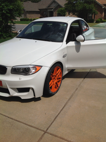

I mounted 275/19/30's on the front stock wheels re11's. No issues. I planned to install a 305 on the rears but had issues sourcing them.
I then moved the 275's to the rear and bought 255's for the front.
Andy Hollis (hollis racing) will tell you that you don't want to go much over 10mm up on stock sizes.
It is just for street / looks, you can get 275/30's on the front and 315's in the rear.

275 in front
