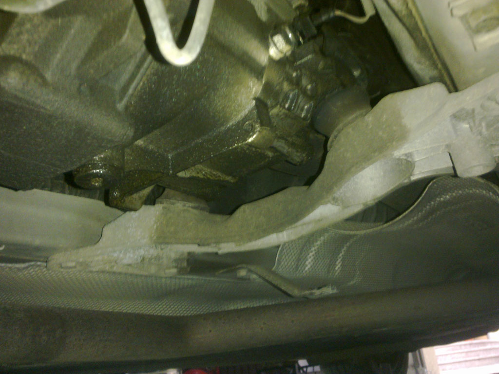

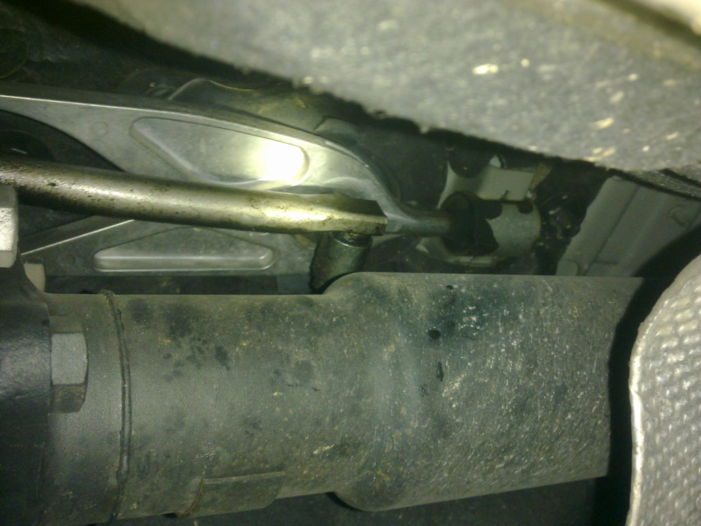

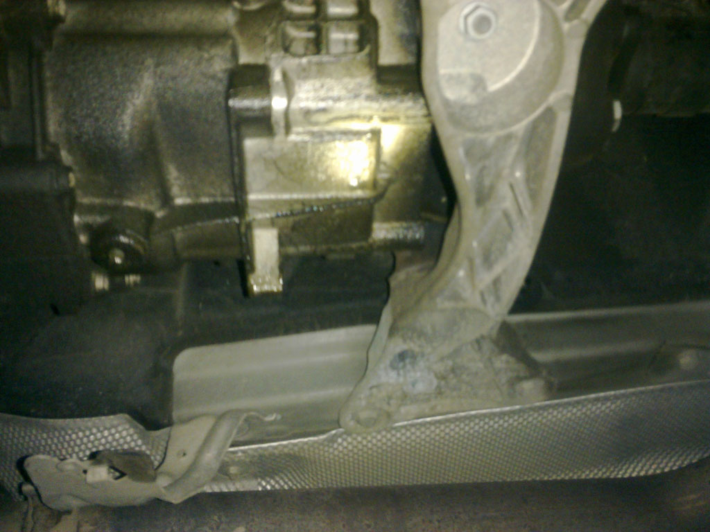

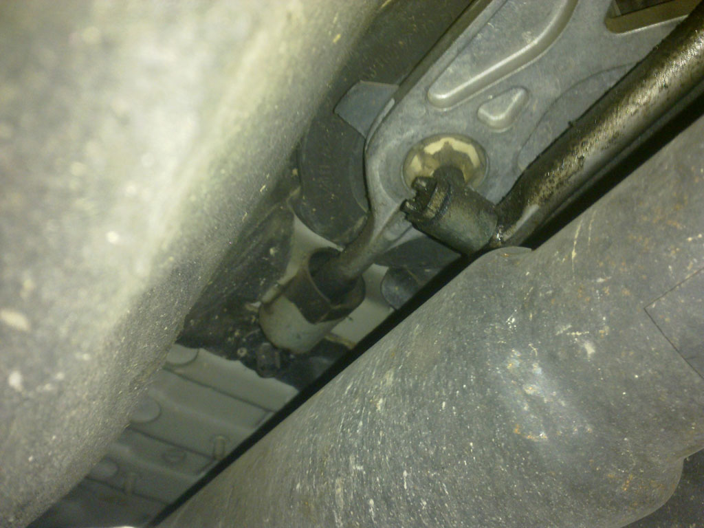

Leaking in tranny area
Hello guys! I'm new here so consider me a rookie and treat me accordingly . Yesterday managed to do the regular maintenance of my beemer, as for some time i am the only one having regular contacts with it , yes, cause of the big love there is between us. Maintenance consisted in oil change, filters change and now i've done a differential oil change aswell. So far so good, car runs beautiful but... i've noticed oil leakage beneath the transmission oil pan.
Inspected with the lamp and the oil doesn't seem to come from the pan gasket, neither the draining bolt but from somewhere up, where the shifter lever gets into the transmission.
Now i didn't had the idea yesterday to unscrew the filling bolt to check the oil level with my finger as it's clear that the leakage is quite important but maybe some of these days after i get proper transmission oil (just in case) i would definitely do.
Is there a reason to be worried? Anyone has any idea?
Here are some pics:

You posted several pictures but it's still hard to see what is going on. Are you sure there is no oil on the back of the engine? I'm not sure it's coming from the transmission but perhaps that's because I can see what you see. In any event, if it's full, then you haven't lost much. If it isn't full, then you need to fill it. I used, and like, Red Line MTL but many people use something thinner - automatic transmission fluid. It doesn't take much to change and fill it.
If the oil starts on the engine I would not suspect the manual transmission. I would especially not suspect the manual if I could find fluid in the fill hole (i.e. it is basically full). Most cars with a few miles on them show signs of oil on the back of the engine and the transmission. It isn't necessarily leaks. It can be spills from an oil change.
The key parameter is whether your transmission is full of fluid. If it isn't you need to get it full and monitor it. If it is full, I would clean off the transmission and check it again in a month or so.
Jim

Nope, not from the engine, everything clean there, not the smallest leak. Oil comes from the sleeve that contacts the gear change lever to the transmission, and from speed all that bar is covered in oil. Underneath the car i've never seen any oil but on the plastic shield there was a big stain. I will order these days 2 liters of oil, hard to get Redline in Romania, but think i'll put some Fuchs Titan Sintofluid as it's approved and think ok for the 120000km on board. Will clean the oil with some gas and in a month or two will check again to see how bad it leaks. I guess to change that sleeve is a hard job and maybe wil leaks after that too. Weird though, on my old Golf with three times the mileage i had no leak at all.

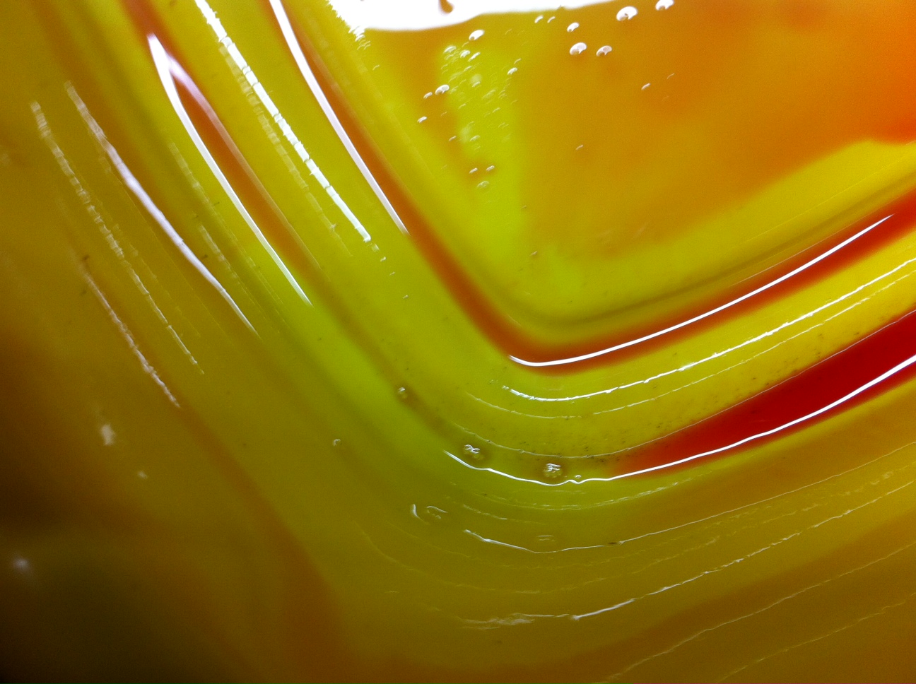

Just a data point. Switched to Redline D6 ATF about 27,000 miles ago. Changed it again today at about 47k miles.
Old:
New:
Kinda surprised how dirty it got in 27k miles.
