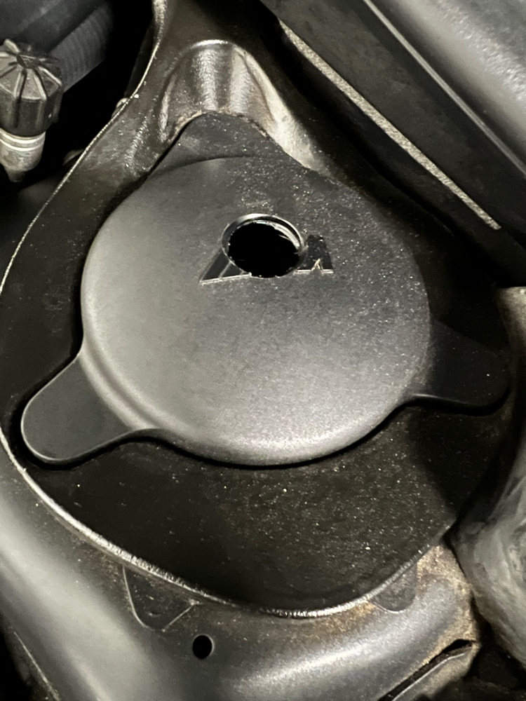

Dumb question but would it be required to drill into this to install Ohlins?? Just now noticed the shop did this…wtf
Bad news bears… certainly wouldn’t be necessary, especially since all adjustments are made from underside. Maybe someone else can think of why they might do this

The front strut has an inverted damper. The damping adjustment is access from the bottom of the strut. Just turn your wheel to full lock and reach around the tire to access. There is no need to drill anything.
Assuming they failed to read the instructions for their first install on the Ohlins R&T.
