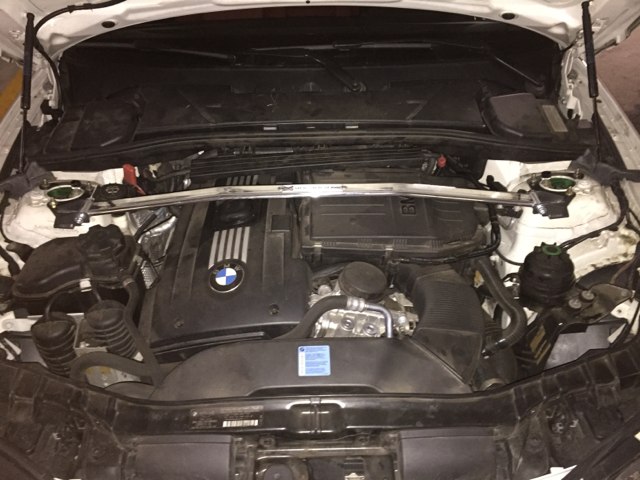

This is the best I have

so when you change your oil you gotta take it off it looks like?

Yeah, that's what it looks like. You can remove the two bolts on either side of the bar and pull the bar off the mounting points though.

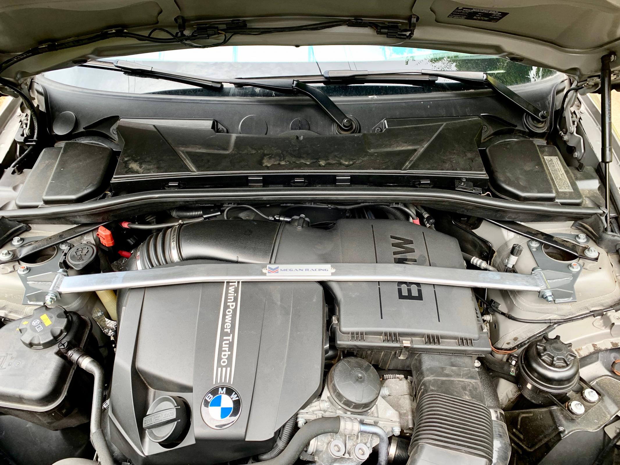

I've gotta say, I was skeptical about this upgrade, but I figured why not, since the 1M does have an improved strut bar, and there's even a BMW performance strut bar (that I've seen crack before, so there must be at least some movement.)
Well, I've been driving around for a week or two with this Megan bar, and I don't think the car feeling stiffer is a placebo effect. I have M3 front arms, Dinan camber plates, a M3 front sway, and Bilstein B12s up front, and adding the bar really makes the car feel stiff like my old Porsches for the first time. I do get a little NVH, and, when I start the car, there's more of a shudder that I feel in the pedals.
I don't know, I don't think I'm imagining things, so anyone thinking about trying it should probably give it a go, since it is so inexpensive.
On an N55, you obviously have to remove a bolt and lift the arm to access the air filter, but you also need to loosen a couple of screws and move the coolant tank forward a few millimeters to completely remove the coolant cap on the left, which still isn't a huge deal.
Yikes, my engine bay is dirty!

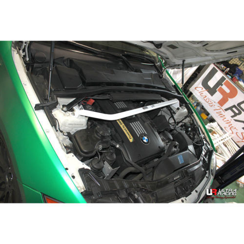

I've been looking at this Ultra Racing strut bar. It is listed for the E82 but i'm worried it won't clear the stock intake. And it covers the oil filler cap.
Also I like the solid mount design, I feel like the pivot points on the the Megan bar (and a lot of other cheaper ones) ruins the point of having one.
Old ebay listing:
https://www.ebay.com/itm/Fit-BMW-1-S...p2047675.l2557

Interesting how it's angled. Wonder why they did that.

To position it directly above the oil filler cap.
