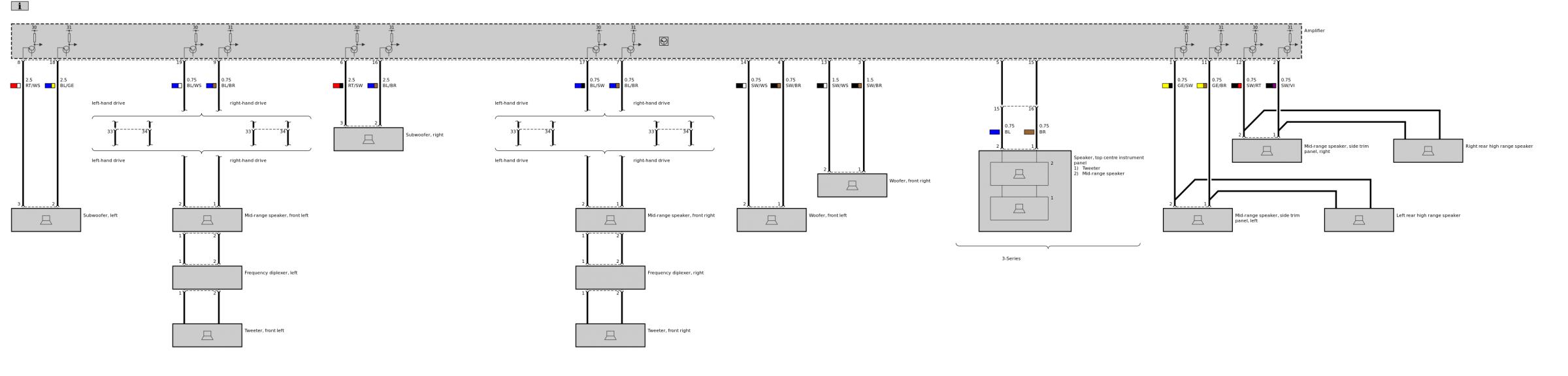

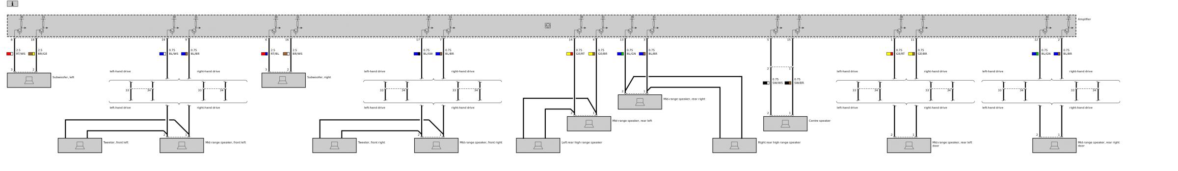

reisf Hello ,I had top HiFi f07 m verst amp from e92. But my car is E90 which diagram i should use from BMWTIS? I buy more staff because it has a difference in the rear shelf speakers. After all, I had 16 speakers right now.
Thank you if someone also helps me. I will appreciate it.
Both the diagram are inaccurate for E90 Individual speaker configuration.
You can to use the first diagram as base reference. But For front door speaker, center dash use the 2nd diagram because you have a crossover for the front door. 2nd diagram is for E92, not E90. They are not the same
E92 has speakers & tweeter on rear doors only whereas E90 has midrange on rear doors and midrange +tweeter on rear parcel shelf.
Note: You need to be able to route wiring into the rear doors if yours dont have any yet.
