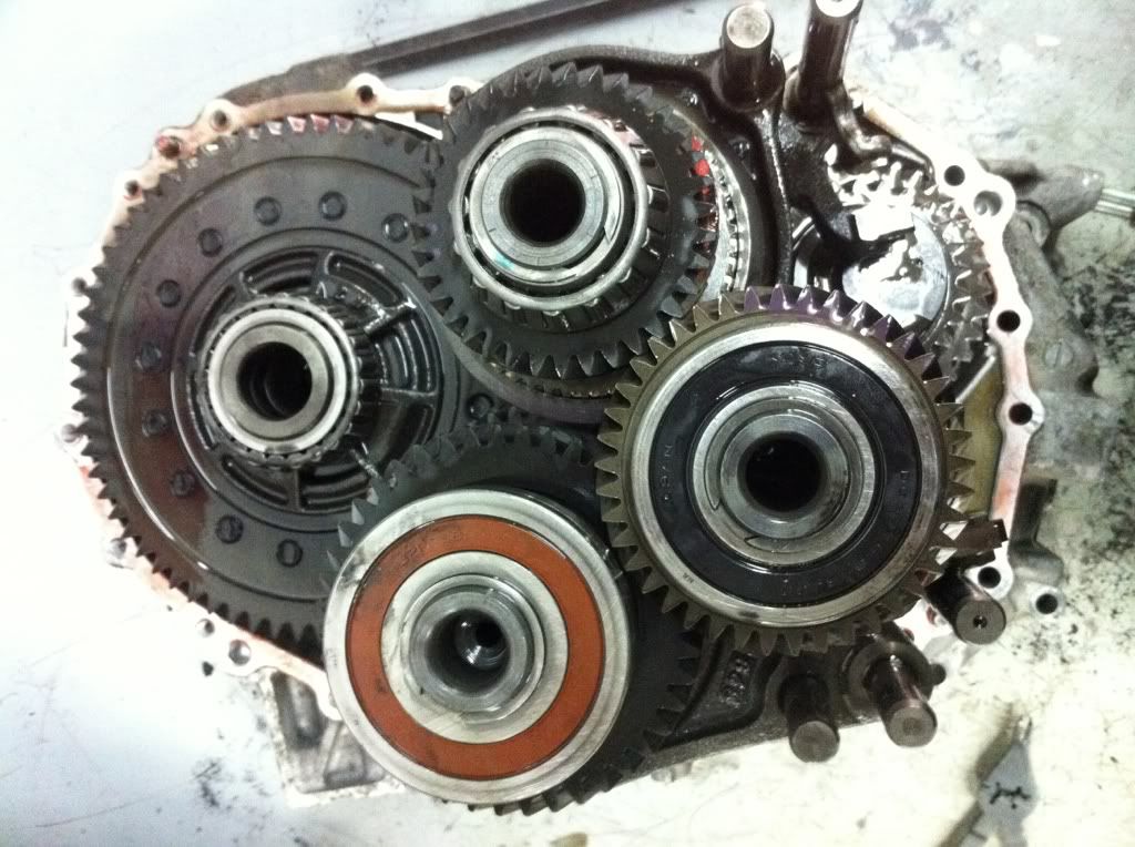

If it's not too far off topic for this thread, what's the reason for being gun shy on rebuilding/servicing the 6MT?
I would expect things like synchros and shift forks to be basic wear items needing service/replacement, not a reason to scrap the whole box? Often things like the OE shift forks come with nylon or plastic pads and upgrading to brass is a huge improvement.
Dackelone11163.50
      08-02-2017, 02:10 PM   #34
Matticus91
Matticus91's Avatar
3614
3,722
Drives: 2013 135i
Join Date: Aug 2015
Location: Washington DC
You can't buy the parts, BMW only makes it available as a whole unit
"Tobias" 2013 135i ///M-Sport 6MT • Pure Stage 1 • XDI 35 HPFP • 404whp/440wtq
Dackelone11163.50
1and11993.00
      08-02-2017, 02:19 PM   #35
11164
Manufacturers have figured out that its just cheaper to throw in a new or rebuilt transmission than to pay a "tech" once or two or three times to repair a trans for a customer under warranty. Many techs are just parts replacers and can't trouble shoot a repair. IF there is no code there is no problem.
And when it comes to transmissions... it can be very expensive... for the Manufacturer to pay for the repairs until the car goes out of the warranty period. So... most manufacturers just throw in a rebuilt trans and call it a day.
BMW does this too. But unlike just about every other manufacturer... BMW does NOT sell individual transmission parts - thru their parts dept. It's all or nothing with BMW.
Btw... on a side note... I use to work at a fairly larger VW/Subaru dealership... the top techs were making $100K plus. 18 service bays, etc... anyways... we had this one guy... he was the "unit man" for Subbie. Unit man means he did all the trans and engine jobs. So when a car came in with a trans problem... he would get the car. But he had no idea how to rebuild a Subbie A/T trans... so he would out the car on his lift... drain all the trans fluid out... then take the car into the back lot... rev the engine in gear until the trans failed. Then tow the car back onto his bay and replace that ($8K!)AT trans. Subaru of America couldn't figure out why our transmission replacement rates were so high! Our parts & service managers always won the quarterly sales contests and everyone was happy. lol
This is why you don't want just anyone to overhaul your trans. Not many techs can do it. And these days I bet its very few guys who know how to do it correctly without you having to pay him to "learn" on your car!
Dackel

What about wear on the 1st gear synchros? I usually avoid shifting into 1st if the car is moving due to the high rpm gap that the synchros have to spin 1st gear up to. You can feel it in the amount of force required to get the stick into 1st. So if I really need to get into 1st I'll double clutch it and it goes right in, even up to 30mph. What do you guys do?
Dackelone11163.50
      08-02-2017, 08:24 PM   #38
11164
Yeah... anytime the shift lever doesn't want to move... its not good for the trans. I would do the same as you... double clutch it.
But normally I would avoid doing that all the time. Every once in awhile is ok. But perhaps you can get by just using second gear.
It's the same when I am at a traffic light... I never shift first into first gear. I always move the shifter into 2nd, and then first gear. When you move the shifter into 2nd gear... the trans internals stop spinning - or so I believe. It just feels better to me and my trans. I also go into 2nd before shifting the car into reverse as well. Even though reverse gear is synchronized on BMW's.. it's just a habit I have from my VW days with a non synchronized reverse gear.
Dackel
Hey Dack - genuinely curious; are you saying you move the trans into second gear while rolling, and then once totally stopped you shift to first? That would make sense then, the internals should not be turning if the car's wheels are stationary and the clutch is disengaged/not mated to the spinning flywheel.
Dackelone11163.50
      08-03-2017, 05:28 PM   #41
11164
Yes, sometimes. But more often I will just stay in whatever gear I happen to be in... say third or fourth... then, when coming to a stop... I will push in the clutch when the revs fall under say 1,500 rpms... Then while I am stopped... I will put the trans into second gear(first) and then into first gear(of course depressing the clutch pedal).
When you put the trans into second gear, it stops the trans internals from moving. Then when you select first gear... there will be no resistance when you move the shifter into first gear slot. Hope this makes sense.
Also... one should never sit at a traffic light with the clutch pedal depressed and in gear... when you have the clutch pedal depressed... you are putting pressure on the clutch disc and flywheel... in turn pushing the crankshaft forward. Over time... this can wear down your engine's crankshaft thrust bearings.
So... sit at the light in neutral with your foot off the clutch pedal. hopefully before the light turns green, depress the clutch pedal, select 2nd gear and then move the shift lever into 1st gear. This is the best way for long trans & clutch life/wear.

Some of the comments and suggestions here are correct and some of them do not have any technical basis. I have built thousands of automatic transmissions and a few manuals and replaced dozens of clutches on a variety of cars. But my knowledge is not current since I am retired. How many of the folks offering advice here have ever even seen a transmission apart? In many instances problems are related to clutch malfunctions and the trans is not the problem. The "internals" of the trans do not stop in second gear. The gears and shafts stop rotating only when the vehicle is stopped and the clutch is disengaged. Like when you are stopped at a light with the clutch pedal in.
(Or the engine is off and the car is stopped. :-) )
The throwout bearing acts on the fingers of the pressure plate moving it "backwards" and when the clutch pedal is depressed the clutch disc is no longer able to "grab onto" the flywheel. The crank only moves forward and back to a very minor extent, a few thousandths of an inch and this has no affect on shifting performance.
There is no technical reason why shifting into second before shifting into first should make any difference. If you think this is important, please explain why. Similarly, there is no harm caused by resting ones hand lightly on the shifter while driving. Again, please explain why you believe this will damage the transmission. Lightly being a key word here. There is no technical reason why you can't skip a gear while shifting. I go from 3rd to 5th quite often and have been doing this for years. It is easier to rebuild an auto trans than a manual in my experience. As I said, I have R&R and completely rebuilt over a thousand automatics. I have seen Fords with no second gear, which shifted from 1st to third and the owners did not even realize they had a problem.
The most obvious reason synchros malfunction is because they crack and lose their ability to grab onto the cone portion of their corresponding gear. In that case the trans must be disassembled to repair the defect.
