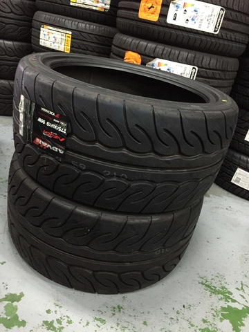

Was running PSS but the rears started losing grip after ~10,000kms or so.
These ADVANS AD08R's are pretty amazing.. still going strong > 10,000kms and grip is in a different level. Wet performance safely drivable but way down on PSS.
What sizes?
      05-28-2017, 11:49 AM   #43
OneM
25
117
Drives: 1M
Location: Australia
245/35 n 275/35.
At the time 255 weren't available so got 245 instead, .. the car understeers and has been driving me nuts, recently ordered 255.
But you're running RE71R's, the ADVAN is a step down I believe
