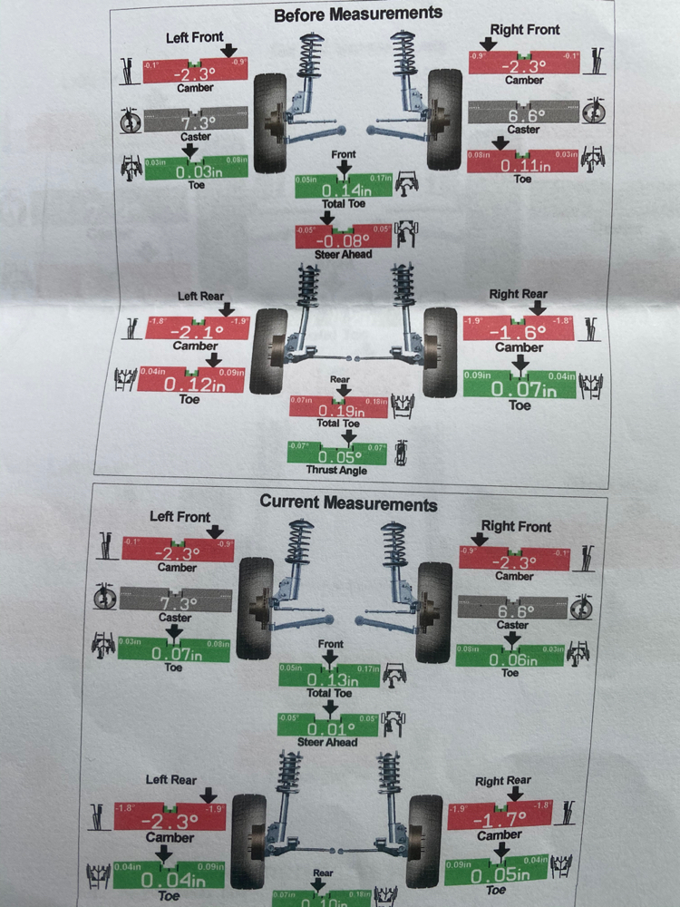

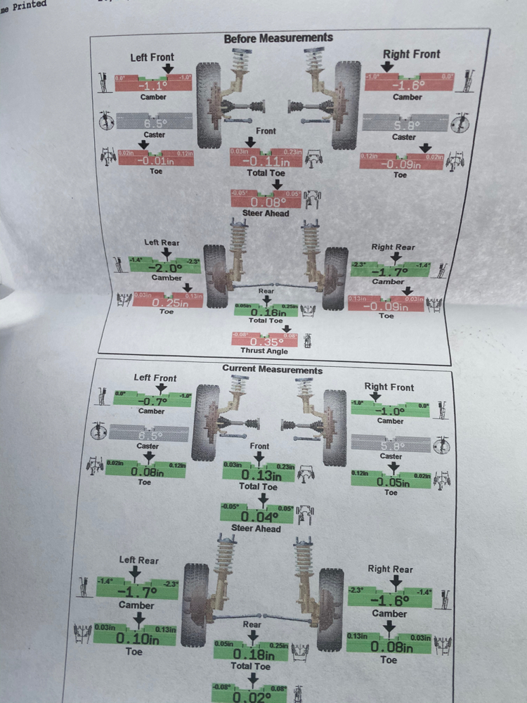

So after much run around...
Balancing the tires myself...
And finally getting a shop to road force my tires...
The results state that my tires have uneven wear(due to negative camber which the Dinan plates provide)...
Choppiness on the outside of each tire and the aggressive pattern of the tire(nitto neo gen) equals a bad combination for smooth riding...
I'm assuming that the reason that I dont have any wheel shake from, 0-60mph or from 80-faster than 80mph, is because(I'm assuming) the tire rides balanced at those respective speeds but not between 60-80mph...
I'm not a tire expert, but I know for sure that all my suspension parts are in great condition...

So how much tread is actually left on these Nittos? I never caught which style these were are they aggressively racing or lower profile like 35's on the front?
Reason I ask is for 3-4 year old tires that I'm assuming were already fairly low profile and stiff to begin with, AND after letting them sit, AND there's the possibility of some interior dry rot eating the tire away from the inside.
Do you know how much camber you're running in the front?
Have these shops showed you specifically how much wear there is on these tires and how it would only cause mph specific vibrations?
I mean..there's only like 5k other people on this site running camber plates with heavier camber than stock so on and so on and not having vibration issues at all..because that's the better way to drive this car.
My bet since it's so mph specific is that there's either some bushing degradation going on with your cv's or arms, etc. if you haven't replaced any of those and depending on your current mileage, this could cause some wiggle.
That or the tires are shit and need to be replaced. I agree with the other above dude about asking the shop to temp swap out a used set of fitting front tires on ur current rims just to test it. No vibs..there's your problem!

So I was able to get discount tire direct to send me out another set of tires up front(225 40 R18)...
I should know after they are installed if the previous tires were shitty...
Pretty aggressive tire(nitto neo gen)...
Was told by the discount tire rep that the tires are a soft compound...
But then the Indy that serviced my car said the tires were a hard compound!(when I had my car serviced previously)...
I have M3 upper and lower controls arms front/rear, M3 sway bar front/rear and coil overs...
Was thinking that maybe I could have some tie rod play(haven't replaced those)...

So update...
New tires on, no steering shake...
Maybe we conclude on uneven wear on the old tires?
They told me that my negative camber was the issue(and they could t correct it)...
Dinan camber plates etc...
I included to pictures...
The first picture is my alignment when I initially got the tires(this was done by the better mechanic known for his suspension and alignment work)
The second picture is the alignment done a couple weeks ago...

You have a bent control arm or something. My opinion. Have since the first alignment.
Just quickly looking over other alignment pics, caster should be virtually identical. Adding/subtracting camber by knocking the alignment pin out isn't going to change caster.
To do that you need to adjust front to back, which the holes in the tower don't allow. Camber plates may, I haven't looked much at them.
I hate to steer you down an incorrect path, but I kinda think a bent arm is what you'll find here. Might be able to look through one of fe1rx's threads for length specs of the arms.
Agreed - never seen caster that different side to side, at most a .1 difference but not what your alignments are showing. Indicates something else is off somewhere - which could be leading to uneven wear and other problems (that they tried to blame on your plates potentially)
All my control arms are new(as of 2018 from fcpeuro, trw "m" kit front and rear)...
I'll get down there again and check though just to be safe...
I did a full inspection a couple of weeks ago and found nothing out of place, but it doesn't hurt to check again...
What do you guys think i should do?
Could it also be that it wasn't aligned properly?

Well it's going to be something the same from the first alignment to the most resent. The difference has not changed, 0.7*. And for that to remain constant between 2 different shops rules out shop error.
I can't tell if Dinan plates are tapered, which could point to installation error (you can look up the install instructions). But again, if this is something new from the first alignment, it's not it.
Only other thing I can come up with is maybe the subframe is out of alignment. I'm not sure how much it can move or what directions. I've had mine loose but honestly never paid attention. Had it aligned after, no alignment prior (for a baseline).
If the subframe has ever been dropped, it's something to think about.
But just go through your list and cross off what was done after the first alignment and what was done before. Before is going to be where more answers will come from.

Yea honestly from all I’ve read and been through I know that -1.7 camber in front would not wear the tires unevenly. If anything it would bring the wear more centered as stock the car has next to no neg camber which can cause excessive wear on the outsides.
Now if you’re running -2.5 or more you may see some inside wear but that’s expected.
Obv your arms are newish but that doesn’t mean there still couldn’t be an issue with them. A crack you didn’t see, a fucked up bushing same case. It’d be hard to tell unless shit starts to go south after the install. Have you considered just taking her to the nearest non-shitty dealer and having them just do a solid once over on the front end? Suspension and all. Sure you have aftermarket but you can just relay that to them and say you’re feeling is something else is causing tire wear or vibration. Cause it’s almost like this back n forth bullshit with the other shop is getting old and nowhere
