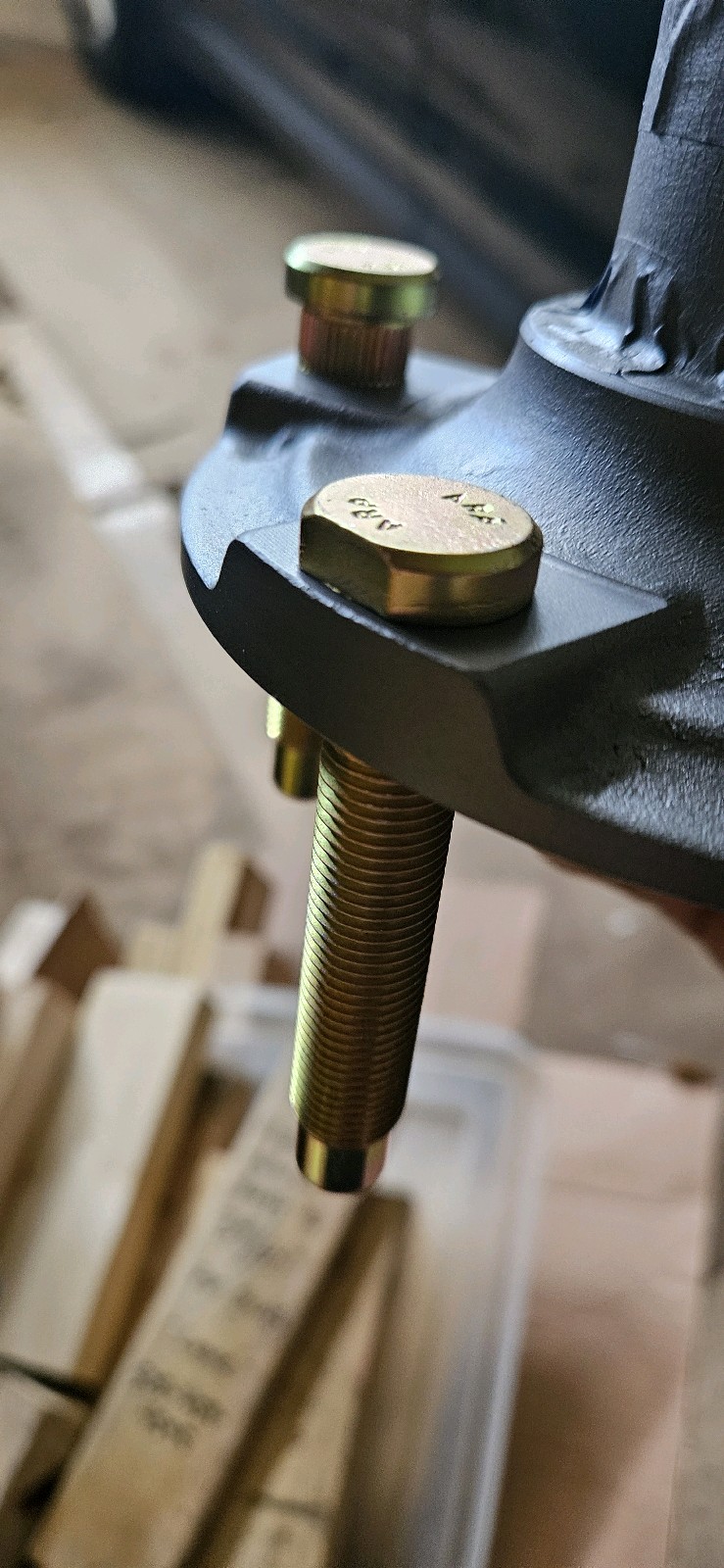

Got some adjustable upper control arms to pull the wheels in enough to clear the fenders and started cutting away some of the quarter panel. I tried drilling the E9x xdrive front hubs but just kept destroying bits so I took them to a machine shop. Then I pressed in some ARP 14mm studs. The studs I got for the rear F8x hubs are from Vargas Turbo and they convert 14x1.25 to 14x1.5 to match the ARP studs.
