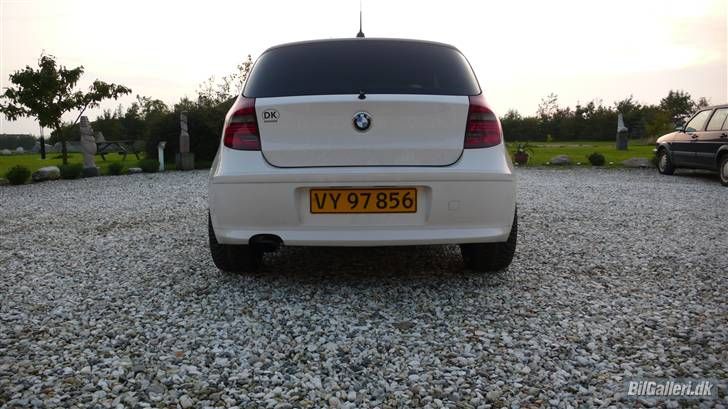

Nemizis
Drives:
Join Date: Oct 2008
Wheels: Raplica, M6 m325
Front: 8,5 x 19" ET 35
Spacer: none
Rear: 8,5 x 19" ET 35
Spacer: nonce
Tires:
Front Budget 235/35R19
Rear Budget 235/35R19
Suspension/Fender Mods/Camber:
Orignal M-sport (15mm)
Notes:
rubbing in back while taking a speedbumb with 30kmt+
Note that I dont have backseats in the car, so it is lightweight.
I have allready sold them because off the rubbing. To spring i might but them again, and get them drilled a little, or might go with somw 20"
