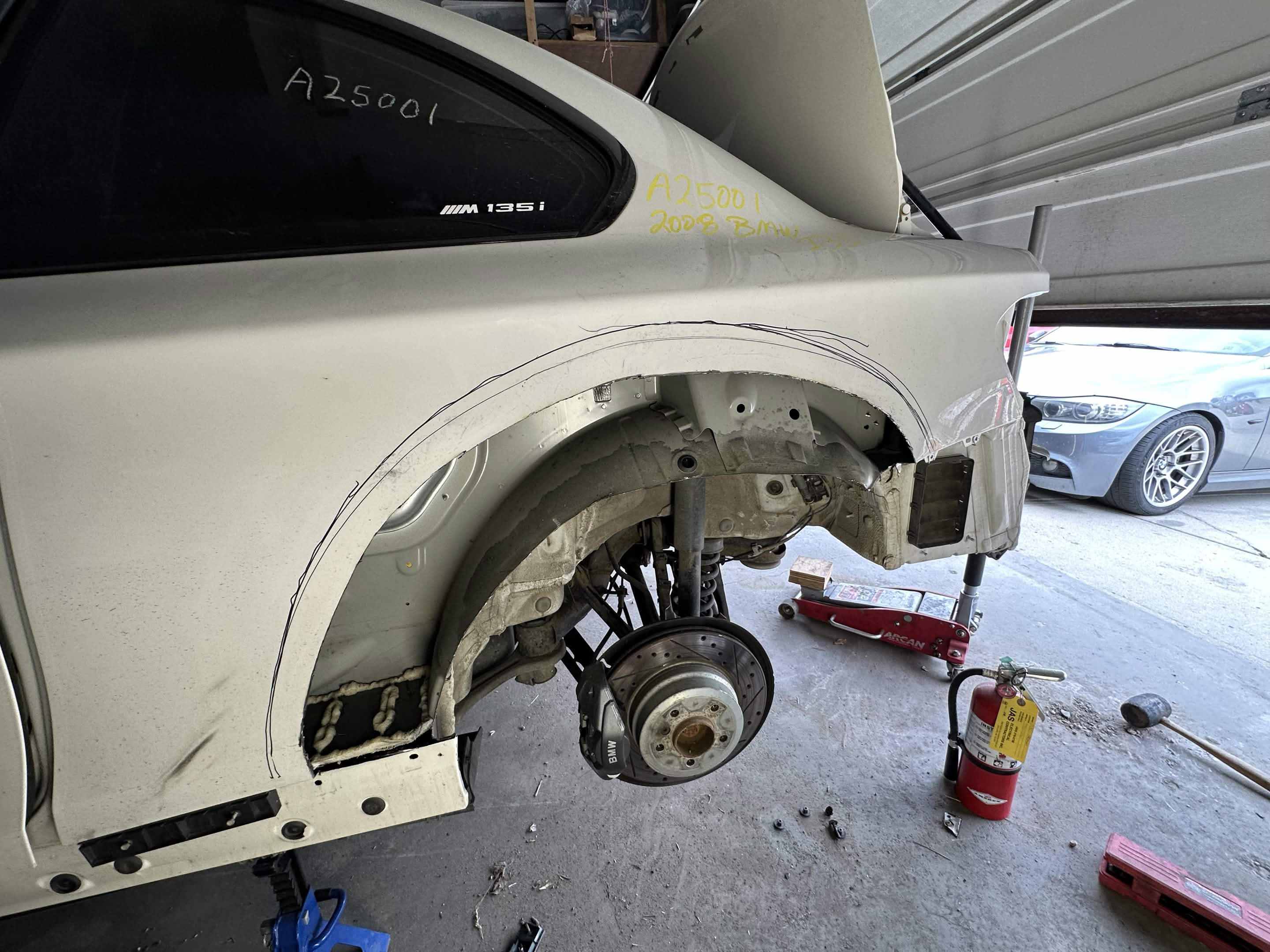

Originally Posted by Burnout View Post
First off the workmanship and crafting looks top notch, amazing job!!
What region of the inner wheel well patch would need a different profile to allow the liners to fit? Does it need to be more set inwards?
Thanks! I believe I slightly angled the patch downwards, instead of going straight out (horizontal) if that makes sense. This wouldn't be an issue if I simply test fit the fender liners before welding in the patch, but being the first one to do this project I was bound to make mistakes. The fender liner hits the patch right at the peak of the liner, where it would be furthest away from the axle. So my thought is to heat up the liner and see if I can get it to sort of remold around the new wheel arch. but if that fails, I'll get a large Kydex sheet and truly heat form custom liners

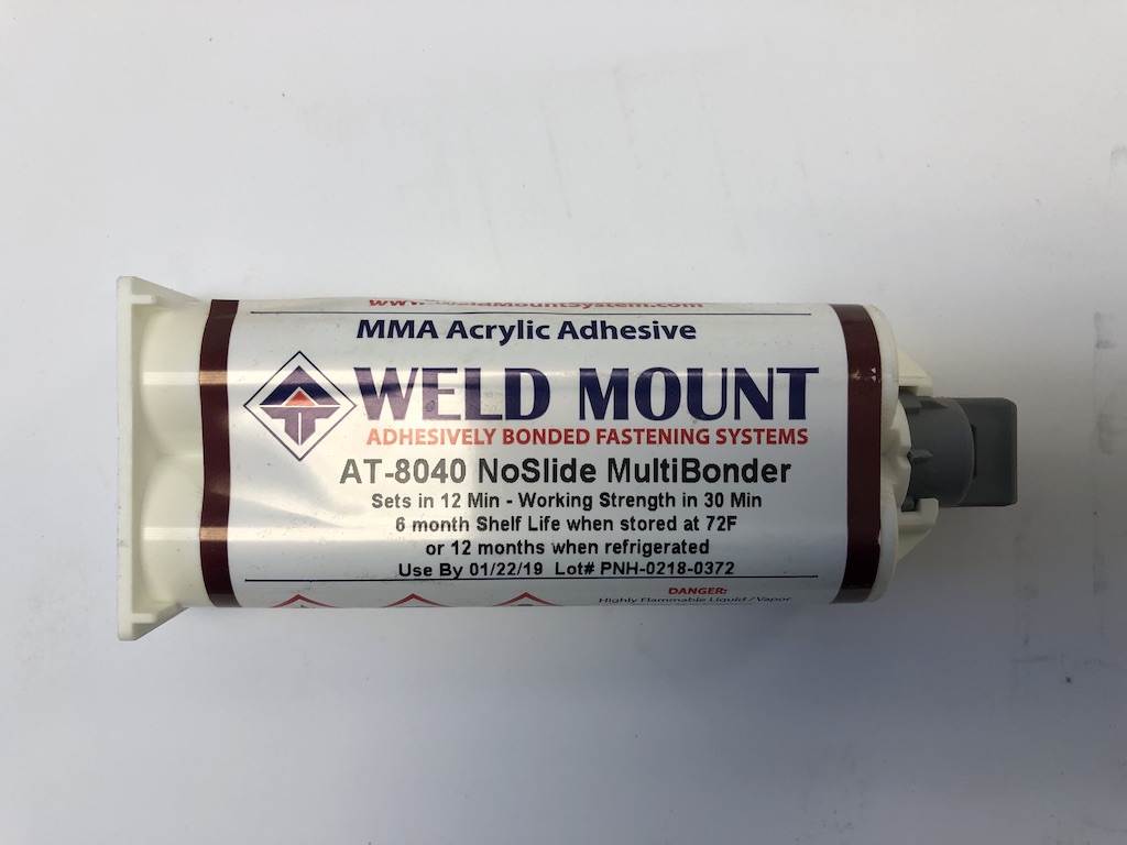

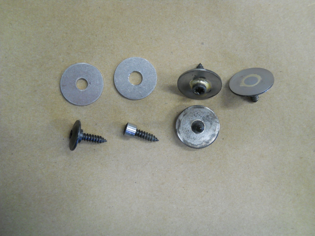

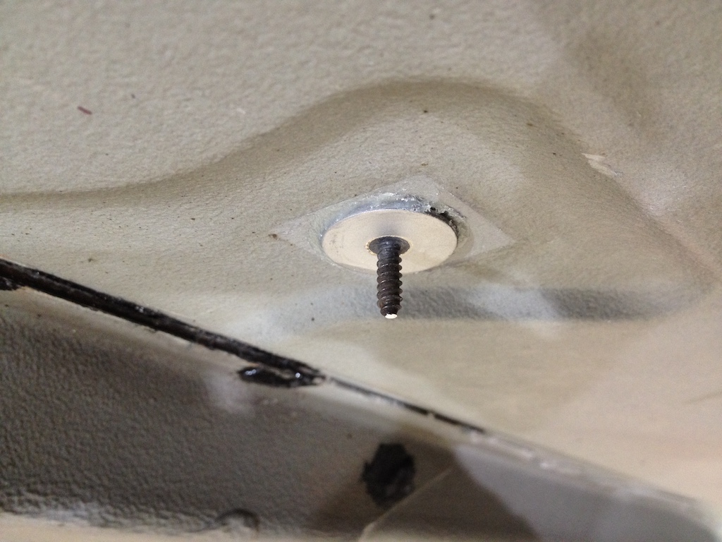

Regarding the missing studs, if you haven't resolved them yet, you might want to consider the approach I took on my Cayman to replace a few of the underbody attaching studs that had broken. The attached pictures should be clear, but I used Porsche's p/n 9A7 007 517 00 4.8 x 19 tapping screw as a starting point, silver brazed to a stainless washer, and then adhesive bonded to the vehicle.
The adhesive I used is intended for applications like this. Those studs are still standing 5 years on.
Attachment 3898363
Attachment 3898364
Attachment 3898398

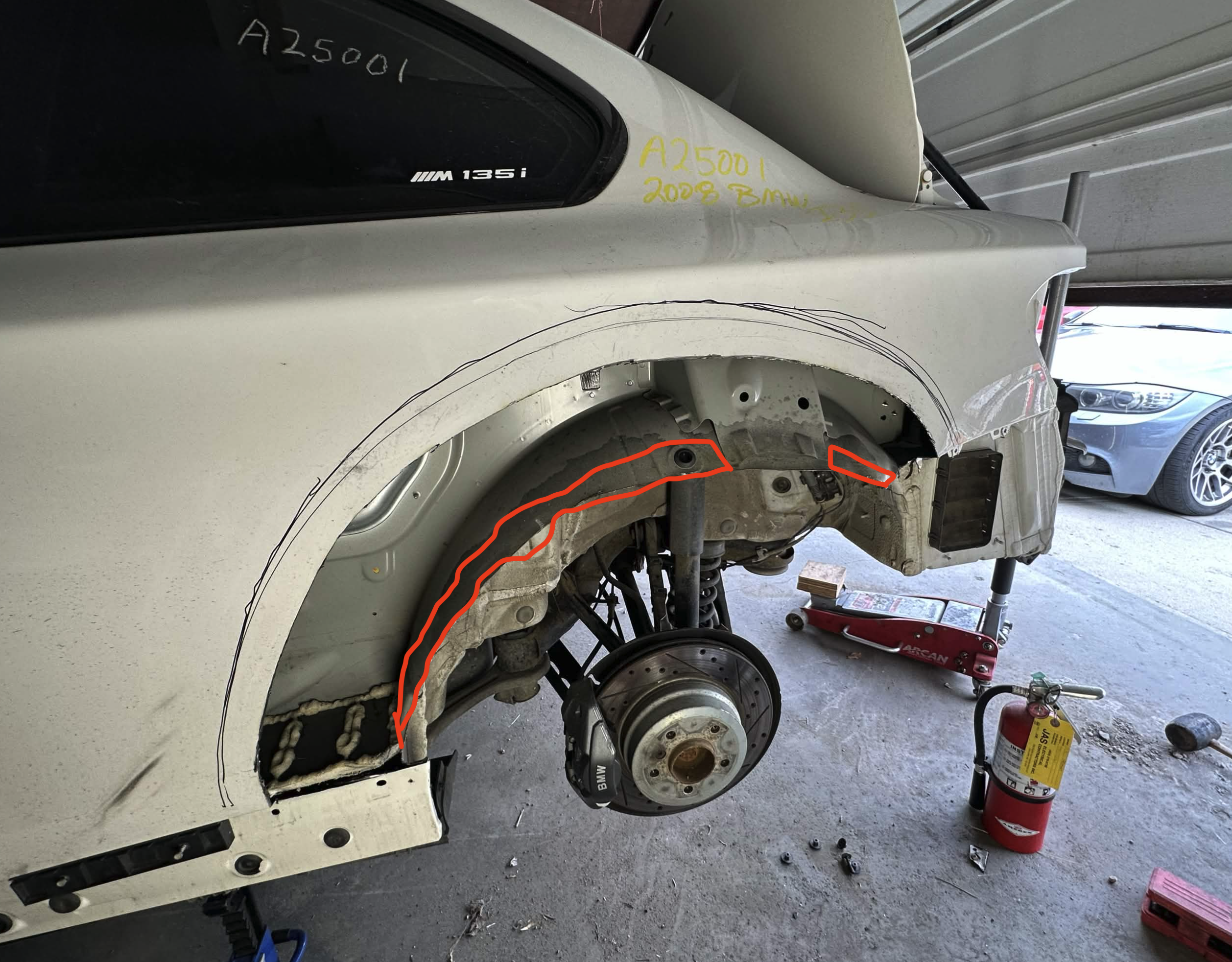

Took a bit of a break, life has been hectic lately but I finally got that lower plastic bit which separates the interior of the frame rail from the interior of the quarter panel replaced. I used 1/4" ABS sheet I had lying around and some window and door spray foam to get it in there. Using an automotive grade 2-part expanding foam would've been the better choice here, but this stuff should be okay as well- we are simply trying to emulate what the factory did and get the area sealed off again.
Name:  Screenshot 2026-02-04 204100.png
On the left you can see the open space on the driver side where I had to remove the OEM piece to make room for welding and sealing. You can also notice how dirty it is down in the frame rail area compared to above it- this partition is definitely warranted. The idea of the ABS sheet + spray foam seems sketchy, but you can see from the remaining piece that that's exactly how BMW did it originally. The right side shows the passenger side after I got the ABS sheet foamed in place. I used a bit much, but I have minimal experience with this stuff and wasn't expecting as much expansion as I ended up with xD Either way nobody will ever see it, and it does the job it needs to do, so I'm happy with it. At this point I can finally put the interior panels back on, and just have the bodywork & paint left to do (+ custom/modified wheel liners)

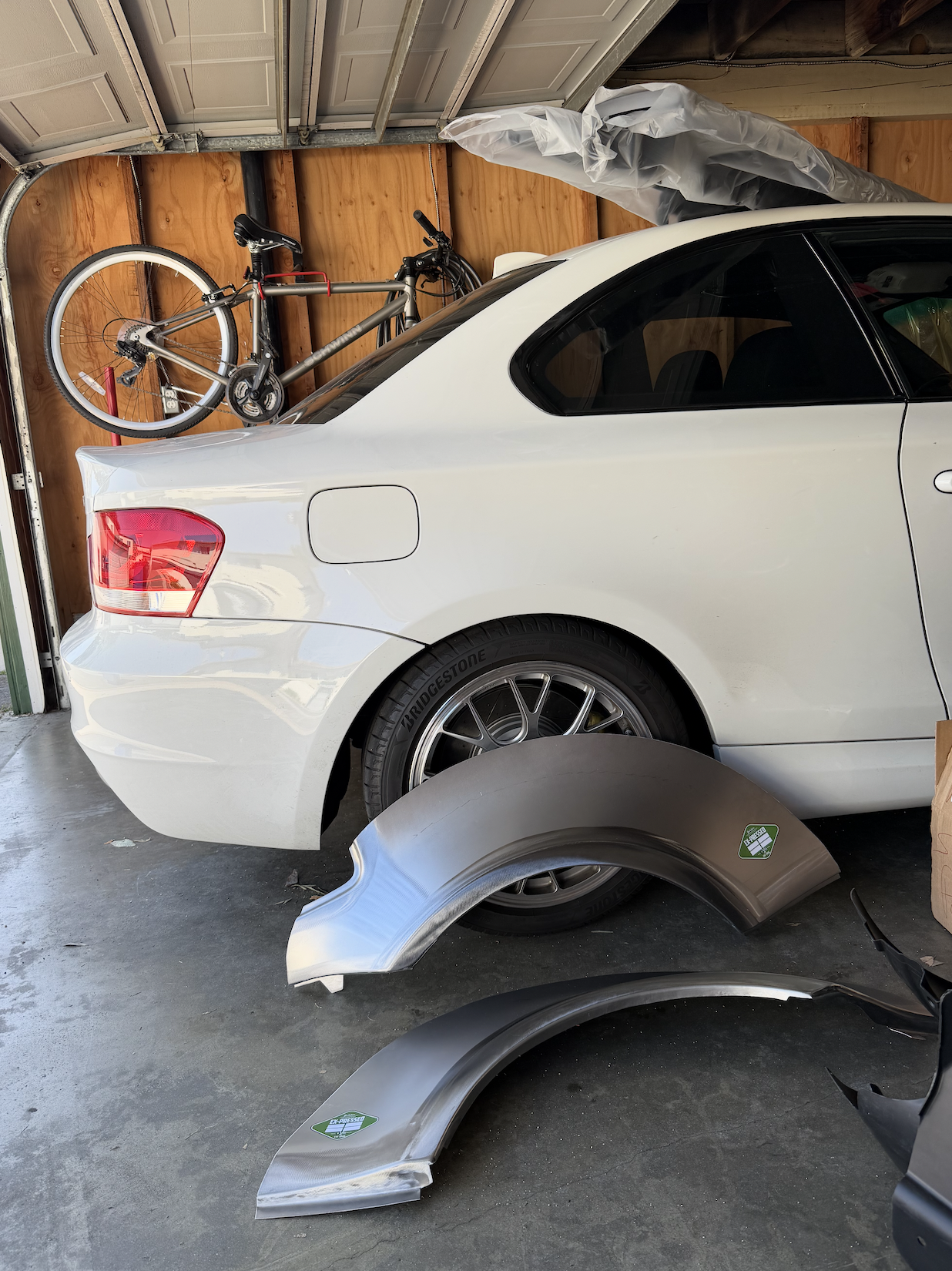

Did a rough cut today to just take a peek inside. Looks like I'm gonna go with keeping the inner tub mostly intact and just weld a thin 1-3 inches of variable width strip of sheet metal to close up the small gap between tub and inside of new flare.
Wheel well lining fits perfectly. I'll clean up my chaotic initial cuts first, then butt weld the new flare on, then seal up the cavity with my strip (I'll spray some epoxy primer up in there as much as I can maybe with a 360 wand or something; cavity wax later on that maybe I can feed through the trunk).
Just wanted to add my findings as most people might be starting off with virgin quarter panels like I am, whereas OP already had previous pie cut work and had to cut the whole tub out.
