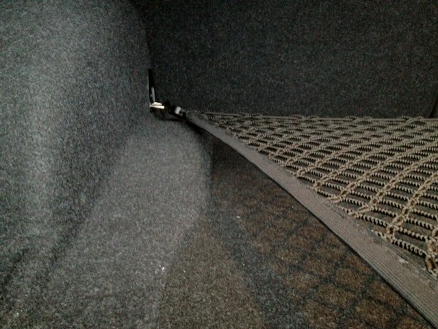

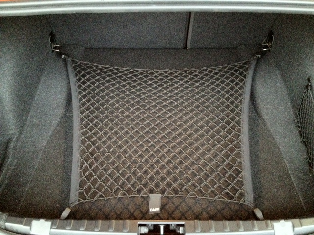

Here are pictures of the completed install with the net.
TJ

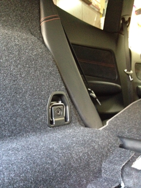

Did mine this weekend.
The only thing I noticed, on my car atleast, was that the hole location was a bit less than 2" and a bit more than 1 5/8" from the corners shown on the OP. Also, once you get the initial bolt location setup, use ej4144's steps and bolt the outer plastic piece and use that to make your template. I covered the area to be cut in blue painters tape and then used a sharpie to mark around the outer piece. Worked perfectly.
And again, use ej4144's recommendation of removing the 2 plastic rivets on each side so that you can pull the carpet away from the body and get the inner piece installed without having to snap the 2 locating legs off.
I initially used an exacto knife to cut through the carpet, but it is pretty tough. I ended up using a small pneumatic jig saw that worked through it alot easier.
Thanks again to neilq for making this thread.
Here is a pic:

TJM129 Net Part Number
TJM129 is the net part # 51470010557? It fits very well. I'm still using a couple of ratchet straps. I like the way yours fits. Thanks for the pictures.
Yes that is the part number of the net I used, and that is what is pictured in my pics above.
TJ

Originally Posted by CM View Post
This is awesome. I ordered my parts yesterday and will try this over the weekend. Both ej4144 & flzrider suggested removing the 2 plastic rivets... where are they located?
Thanks,
CM
One of them is just underneath the number 1 and the other is where the number 4 points to.
Once those 2 rivets are out you can fold the back seats down and pull on the end of the liner and it will pull away from the body of the car, giving you room to place to install the inner piece.
