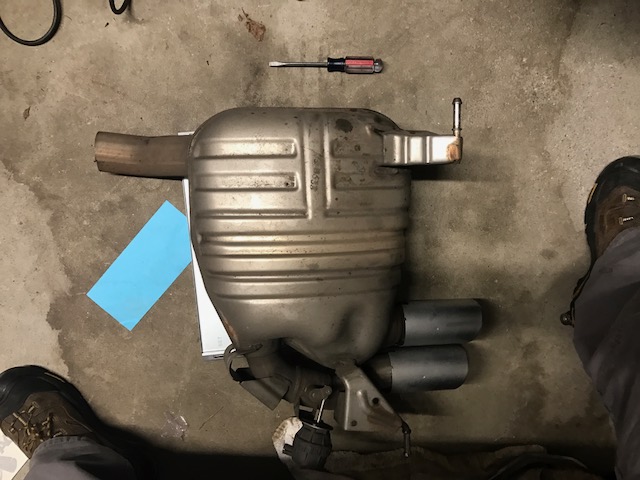

I got that part about a month ago and installed it, I torqued it down to 22-27nm (can not recall exactly) and it came with the required bolt and had thread-locker pre-treated.
On stock exhaust system it removed virtually all the drone in the car, as well as outside drone.

Damper: 18303413587
Bolt: 18407540023
I noticed that the exhaust flap inside my muffler is broke, so it is always open. Someone said to me that my 125i sounded louder than normal, we checked the vacuum actuator and the hose, all is connected. When i lifted the car i tapped on the muffler and it made that typical sound that something is loose inside.
A performance exhaust is needed nice excuse i guess but last on my list.

FYI i could not find anything in any manual with regards to the torque of that bolt. So i used 23nm since it is a rubber piece, one does not want it to be too tight so it can "dampen" or too loose.

Got mine installed on my PE today and torqued the bolt to 17 foot pounds as suggested here. Not sure it sounds any different / better, but I like the way it sounds...
