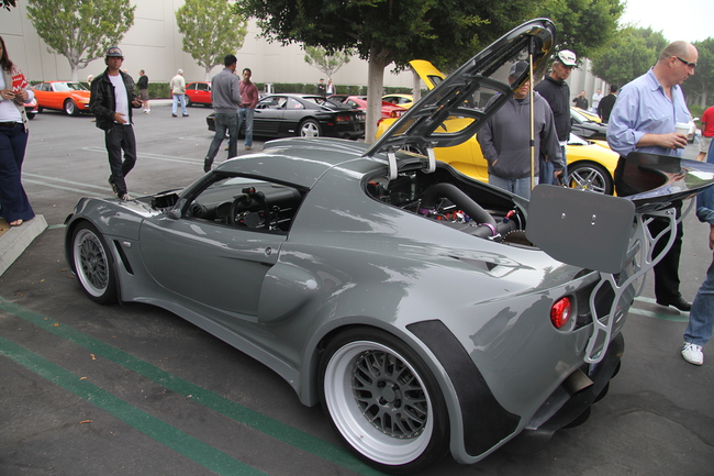

Hi guys I'm the nut case 680 whp ronin exige..
I had a great run last Sunday up hill with a 1M and I gotta say I was impressed with the car and the driver behind the wheel..... He pushed it for all it had and knew when enough was enough, it's good to see egos kept in check..
We had a nice sprited drive up and over the hill, again I was impressed to see him toss the 1M into the twisties without lossin a beat...
If anyone has a question on compound charging feel free to ask away, Id be happy to help out if I can...
I did own a M1 at one time...
Cheers,
Frank

That exige is badass. I can watch those vids all day long. What is the weight w/o driver?
BMWCCA #454364

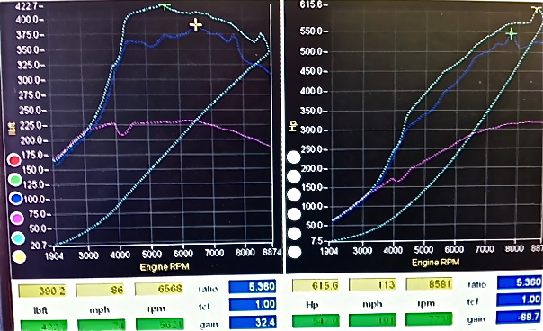

If we say the supercharger makes 7PSI boost at 7k RPM, you will have less than 1.5PSI of boost until the turbos are pushing out all 14.5PSI or whatever they provide. So 99.9999% of the time, the supercharger would actually cost you horsepower due to parasitic drag. You'd see a benefit from idle to 1500rpm in first gear.
Now the follow up argument is that the supercharger will increase throttle response and to a point it will. But with MDM enabled, the N54 uses the wastegate to keep the turbos spooled up for quick response.
Unless you plan on increasing the turbo size and introducing more lag into the system (and can't utilize the MDM wastegate tuning), the s/c isn't going to pay off for the added complexity. And the same thing applies, once the turbos are spooled the charger provides little benefit.
First off the supercharger makes whatever boost it's displacement and rpm will allow so if it's 7 psi at 1,000 rpm it will be 7 psi. at 8,000 rpm...
It does not rob HP when compounded since the presure out put from the turbo offsets the parasitic losses and helps to spin the blower... There is no free ride but if you want instant throttle responce and zero turbo lag this is the only way to go....
There is no 1.8ltr gasoline engine making 420 ft tq at 3,800 rpm that I know of on 91 octane.
You can not get the power from small turbos alone, if you want big power you need a larger turbine housing to rid the exhaust gas pressure and heat and with that you get lag.... Unless you keep your foot planted you will always have lag in the real world with a big turbo setup alone...
It is the superchargers instant pressure and the exhaust heat and pressure that will spool the larger turbo....
My car at 70 mph cruises at 3,000 rpm if I touch the throttle I get an instant 16 psi.of boost by the time it hits 3,700 rpm I have 35 psi. I have never been in any car with this kind of responce..
Remember it's only 1.8 ltr and pulls like a freight train al the way to it's 10,000 rpm redline in any gear....
Compound charging works and it works better than any turbo alone setup...
Oh yeah my charge temps are never more than 10*f above ambient at 35 psi. due to my chargecooling setup... Here is a 27 psi.pull on 91 octane
Thanks it's 2150 with a full tank..

Oh I'm not sayin you should, i think it's cool as is and I've seen it pushed to it's limits..
I just came across this while surfin to find out more about the 1M after seein it do it's thing by a skilled driver...
I don't think you'd want 800 hp in a car with such a short wheelbase and high CG.

In a compound setup the supercharger is for the entire RPM range, it spools the turbo at any RPM. The larger turbo is needed for increased CFM for power and the larger turbine housing is needed to allow for the exhaust gas to flow out you don't restrict the flow with a small turbine housing.
I'm just tryin to give the facts on compound charging.. Too many guys get it wrong.
Also dyno sheets don't tell you anything when it comes to the responce on the road in different gears..They only show you what you will get if you leave it in one gear with the throttle floored..

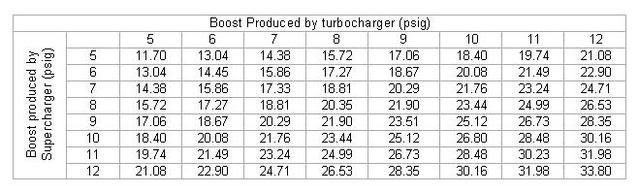

The supercharger spools the turbo at all RPMs it doesn't stop or go into bypass.
The supercharger alone boost output is detrmined by pulley size it doesn't go up or down with rpm, it works as a boost multiplier with the turbo...The larger turbo is also flowing air at every RPM it just doesn't flow enough CFM to create useable boost at low RPM...Put them together and you get as much airflow as you can use when ever you want it at almost any RPM..
My turbo flows into the supercharger - chargecooler and then intake manifold...
This may give you a better idea what happens with the boost..
