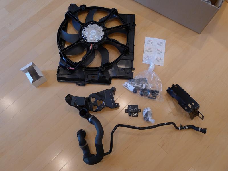

lol. Sorry I probably wasn't very clear. I'm asking about the small radiator that goes in the driver side bumper. I saw some people posting that the replacement hoses you use to connect that small radiator to the main radiator may have clearance issues if you use the stock fan. I think that PPK fan is more thin. I am hoping to use my stock fan but just want confirmation the new hoses will clear the pulleys.
the 335is I believe shares same fan size and has the extra coolant hose going over to that additional cooler.
you should not run into any issues with contact with pulleys. n54 have upgraded inlets that sit way closer.

lol. Sorry I probably wasn’t very clear. I’m asking about the small radiator that goes in the driver side bumper. I saw some people posting that the replacement hoses you use to connect that small radiator to the main radiator may have clearance issues if you use the stock fan. I think that PPK fan is more thin. I am hoping to use my stock fan but just want confirmation the new hoses will clear the pulleys.
It's the opposite. The PPK fan is much thicker. I'll verify as I have the full PPK2 installed and still have my stock fan sitting around.

Back from the dead. Curious if anyone installed the ppk2 radiator with the stock fan. Is there sufficient clearance between the hoses and the pulleys? I have a csf radiator so that may make clearance even worse but just trying to find out if this is possible for the time being.
Fan shroud is different and the pipe attaches onto it. No way to use the setup with cfs radiator because of it. I have removed the pipe and used regular rubber hose. The hose is actually thicker than the pipe but is pliable and you can route away from stuff.. Do same if you have fitment issues.
Fan isn't thicker, is just stronger fan, same on 335D and some 5-series models, 850w vs 600w for non IS/PPK fan. The shroud is different.
That's what I meant to say. The shroud/housing IS thicker. And from what I recall, the motor itself is more substantially sized. I didn't look too closely at the actual fan blades so I'll have to take your word for it.

To follow up on this, I'll have to take a measurement of the shroud to get an exact figure between the two fans. I forgot that the stock intake snorkel is in the way so I don't have a clear shot of the installed heavy duty fan. I also looked at the fan blades. From the angle I can see of the PPK2 fan, the fan blades are wider. The stock fan blades taper to the outside edge.

Thanks for the replies. For some reason i didn't get notified so i had no idea you guys posted.
so feuer, can you please give me more specifics if possible? Such as the size of the hose. Is it a AN -10? Did you use fittings from the two PPK2 kit, cut the hose, and add your own hose/hose clamps?
On the right side pipe is connected to the hose that goes to the coolant pump. Cut the clamp carefully as you don’t want to cut into the rubber. You need barb connector there with different sizes on the the opposite ends. Don’t know what size. Need to check. It has been years. On the left the pipe is connected to a short hose with quick disconnect fitting that attaches to aux radiator. Install your hose directly to that fitting.

Thanks. Then what do you do on the auxiliary cooler side? Just slide the hose on and use a hose clamp?
Correct. The car isn't with me. In week or two I will get it back. I can tell you sizes then and take photos too. The barb connector i got from Autozone or Advance. Is plastic. The middle there is flat section and sits nicely on the shroud edge. I think this is it: https://www.mscdirect.com/product/details/48711741 so the hose you need is 3/8 I guess.
