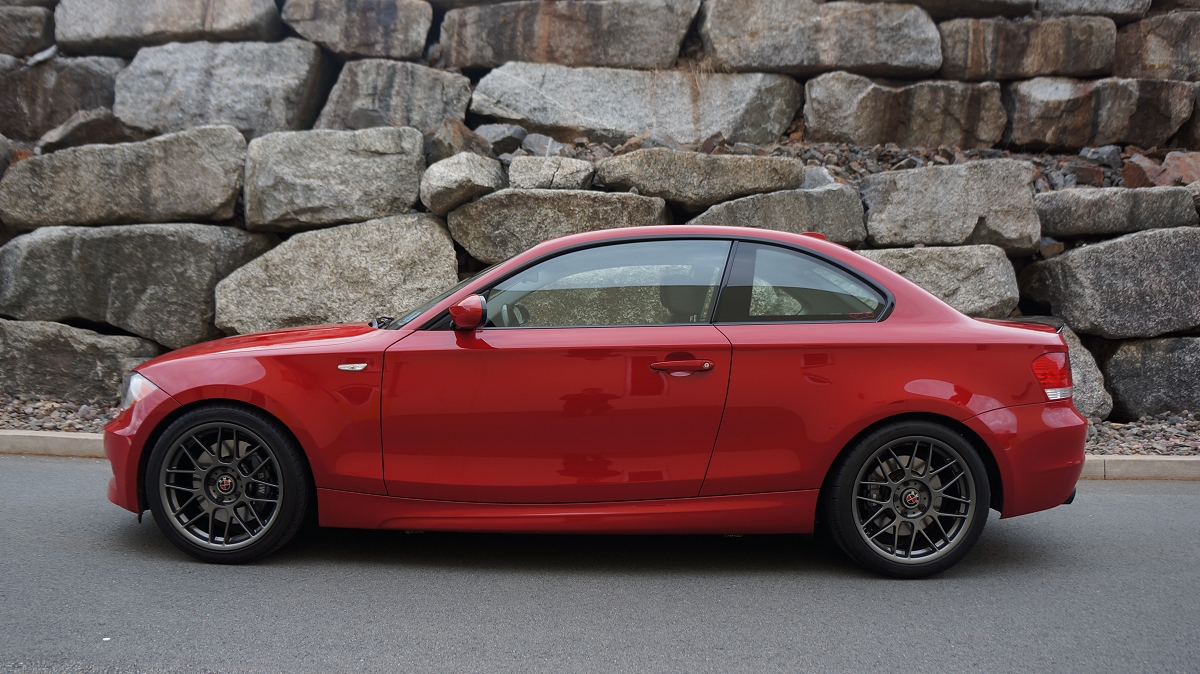

235 / 265 PSS, 3mm front, 15mm rear, front fenders untouched, rears shaved.

2011 135i Coupe  [1.00]
EC-7, Black, 18x8.5 et45; 18x9.5 et58
Hankook Ventus V12 235/40/18f, 265/35/18r
TC Kline SA Coilovers with drop about 1" all around. Dinan camber plates running about -1.2 camber front and -1.0 rear.
Fenders untouched and no rub at all.

245/265
8.5/9.5
PSS10 2.7*camber up front, rolled rears, no issues or rubbing.

Not too good of any pictures yet. But these will do for now.
ARC8s - Hyperblack
Tires: Dunlop ZIIs 245/40/17
Suspension: TCK DAs
Ride Height (Ground to bottom of side skirt) - 4.5" Front, 5.25" Rear
Camber: -3.0* Front, -2.0* Rear
Caster: 8* Front
Fender Modifications: Minor Roll Front, Heavy Roll Rear
* 5mm spacers to clear front strut up front
