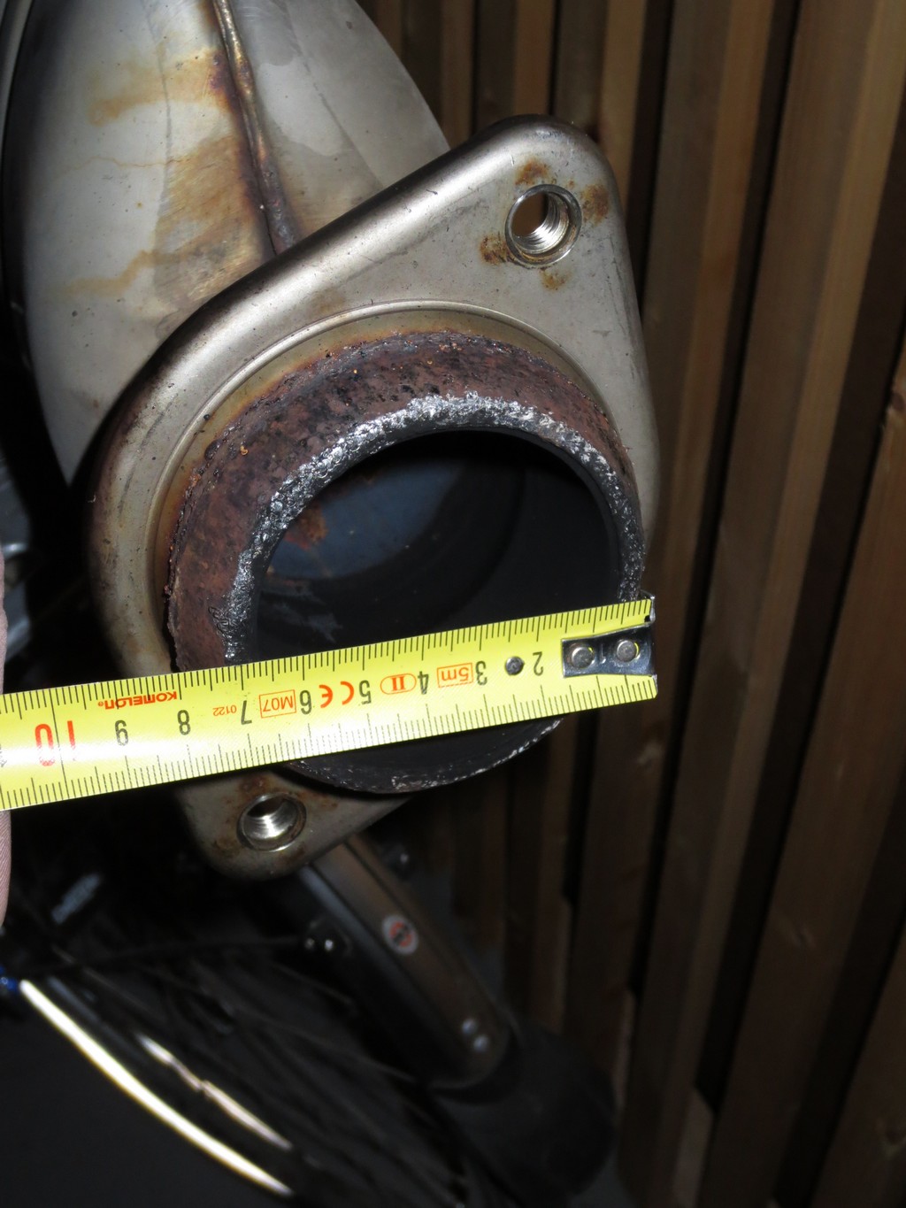

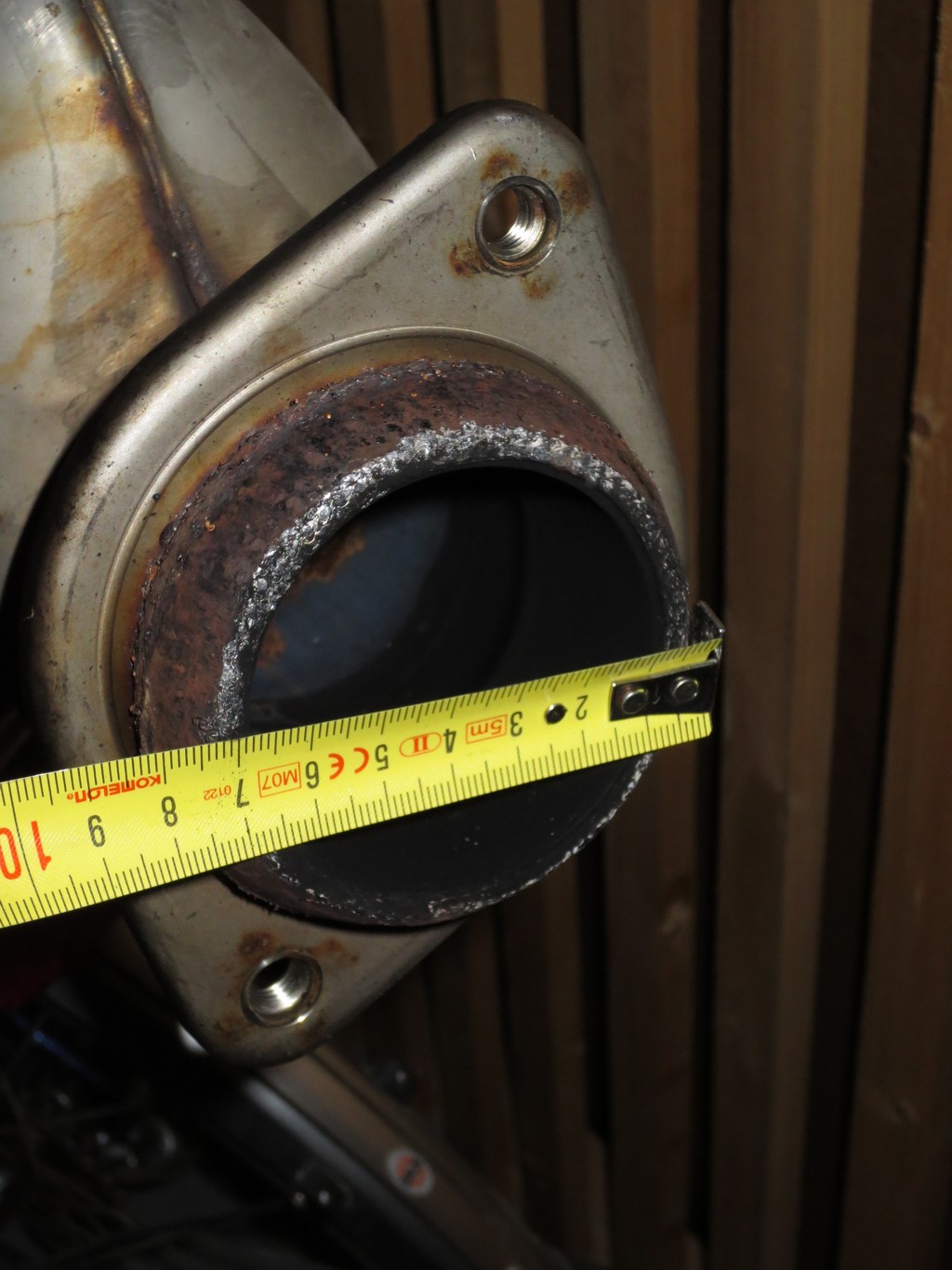

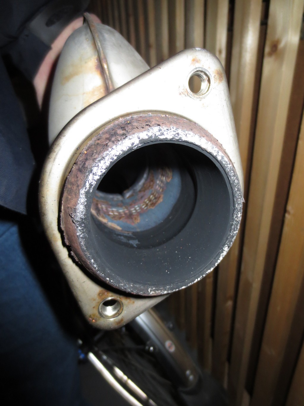

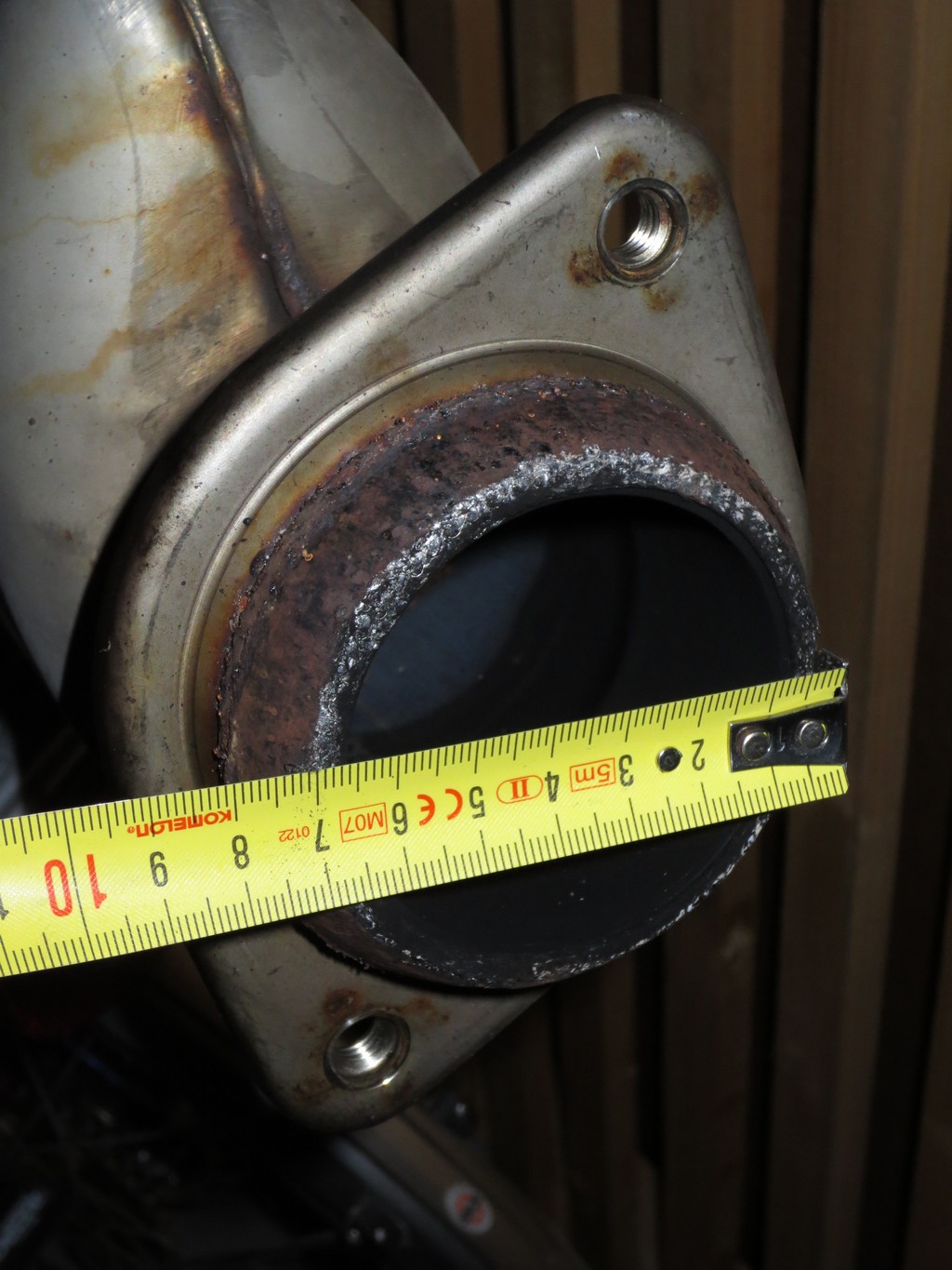

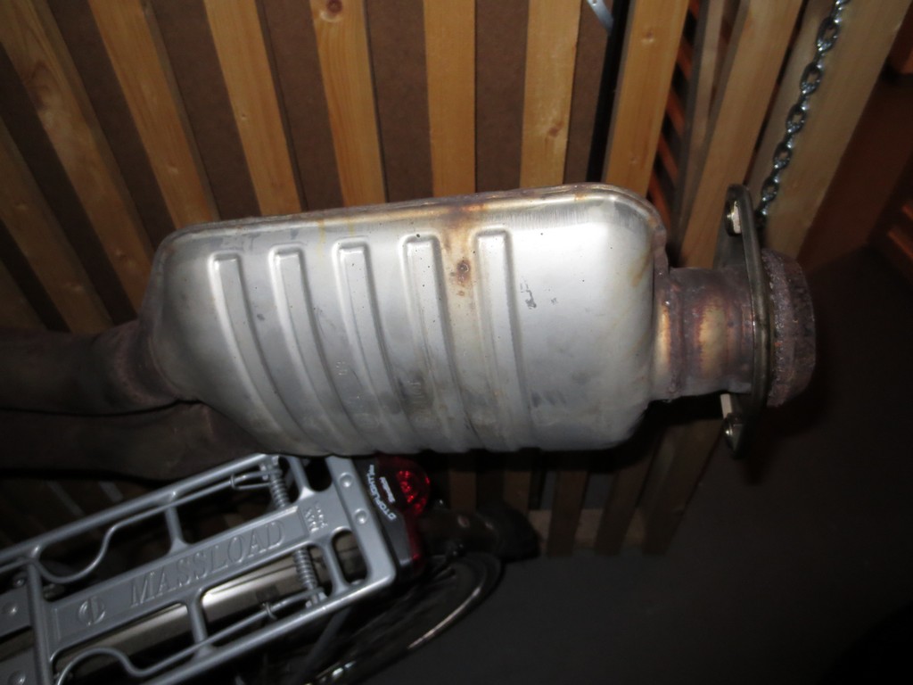

Originally Posted by Dackelone
Originally Posted by Weasel410 View Post
Dack,
By any chance do you still have the donut gasket? If so, could you please measure the ID, OD, and height? Thanks!
For future reference, the axel back OEM tubing is about 2.75'' diameter.
Ok, here you go... I took some pics today.
OD is about 78mm's and ID is about 65mm's. 78mm's is just over 3"!
Attachment 815058
Attachment 815059
Attachment 815060
Attachment 815061
Attachment 815062
Seeing a measuring tape in cm is odd for me. Haha.
