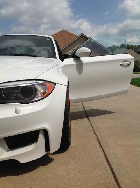

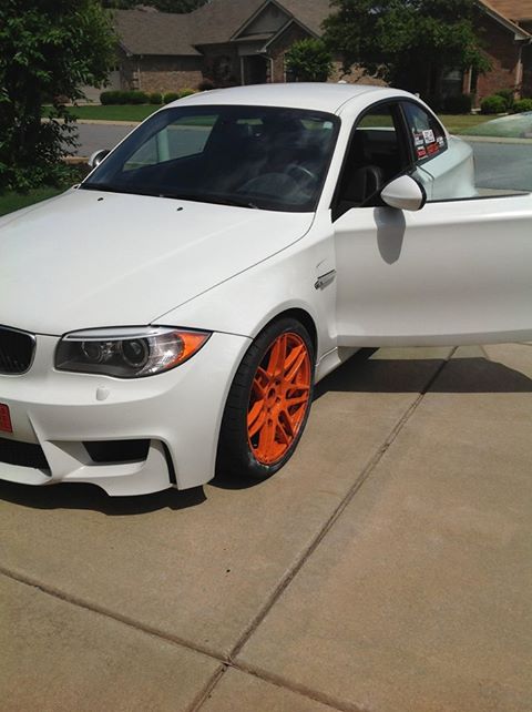

Test fit this morning no issues on stock size 19x9 with a 5mm spacer

So just to review. You are running stock suspension with no changes but 5mm spacers front and rear? Also stock size and offset wheels? Camber maxed to factory settings?
I might be totally off on this, just trying to remember.

Koni d/a with stock springs and perches.
-1.5 camber, no plates
So this setup will work on a stock car with a 5mm spacer on a stock wheel
I plan to run a 305 on the rear.

no issues other than the 3 days for the tire install ...
I imagine that no spacer would be needed for a 9.5" wheel or 10" wheel with the correct offset.
glad it all worked out!

Me too. Figured they were going to have to be rears but they worked.
Now, i ordered the 305 after the test fit but. They may be on back order....
