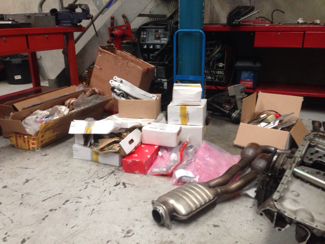

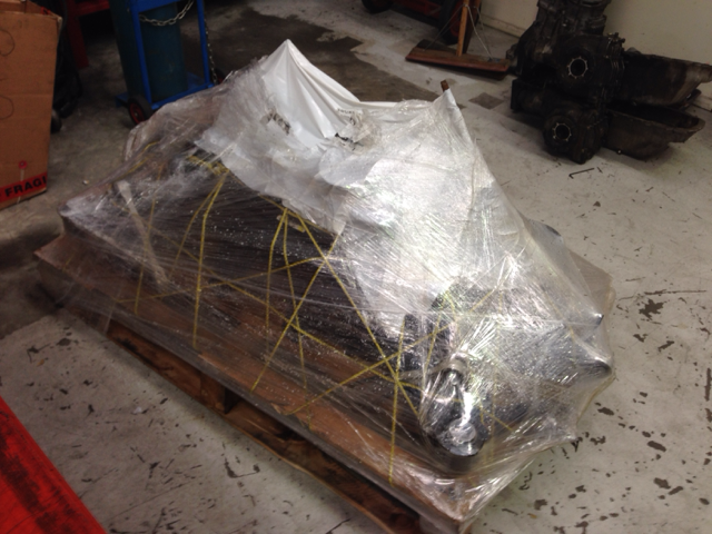

My M3 rear axle just arrived at Advan!
There are a few mounting bolts and gaskets I'll need to order. Also there's a fair amount of rust on the subframe itself so I'm planning on getting it sandblasted and powdercoated. If I can, I might get it powdercoated in Phoenix yellow or the closest metallic gold-ish yellow to match the performance brakes and front air scoops.
Hopefully once the bushings, front control arms and mounting bolts arrive from the US, I'll be able to drop the car off to the shop for a 2-3 day install before the end of this month!

Good to see that it finally arrive dude!!
Cant believe they used that shitty rope to secure it to the pallet haha then again its probably better then how mine arrived with 4 mile of bloody glad wrap that was a bitch to cut through and remove everything from the pallet.
What gaskets bolts do you have to order in? Hmm i would love to look at those Al bushes and possibly machine a set up myself

Thanks Shane! Yeah it was a long wait. Expensive too. Ended up getting stung an extra $400 to "steam clean" it as quarantine...
My one didn't come with the axle shaft to diff bolts and stuff. Rear of it can either be taken from my car or reused I hope. Not sure if all of those Aluminium bolts on the suspension arms are supposed to be replaced or reused. Do you know?
