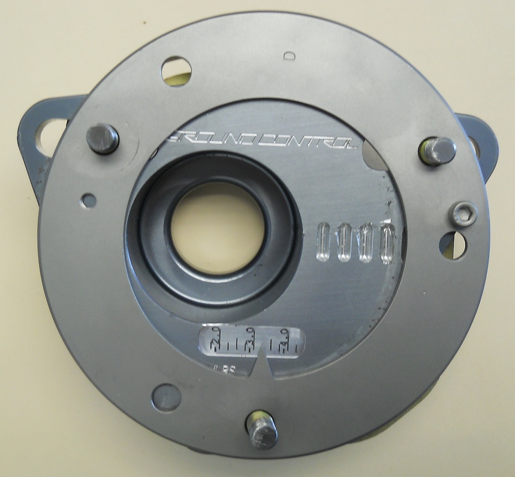

Back to the camber plates. When I first installed the plates, I modified the indicator plate by welding a stainless cap screw in the threaded hole provided by GC to act as a locating peg. They don’t tell you the function of this hole when you buy the plates, but it is perfectly located for a locating peg, which biases the plate location in the direction of maximum camber (in the slotted holes in the strut tower).
Name:  2 Modified Pointer Plate Installed.jpg
Without this locating peg, the indicator plate will float within the range of the slots and repeatable camber settings will not be possible. This little addition really is essential.
Name:  3 Camber plate top.jpg

I have taken this opportunity to complete another modification to the Ground Control camber plates. The slotted holes in the camber plate body are a loose fit on the mounting bolts. One could charitably call this a feature that permits small adjustments in caster to be made. If one intends to make camber adjustments at the track though, this slop really just results in a lack of repeatability when making such adjustments. My solution is to fit the bolts with 7/16” OD x 5/15” ID oilite bushings to take up the play. After opening the slots a few thousandths of an inch to adjust the fit, the plates now slide perfectly smoothly and without any slop in the caster direction.
Name:  8 Oilite Bushing Mod.jpg
At the same time, I have re-engraved the body to provide a direct correlation between the degree readings and the actual front camber setting for my configuration (which includes M3 front suspension arms). This too will simplify making repeatable camber adjustments at the track.
Name:  7 Engraving.jpg

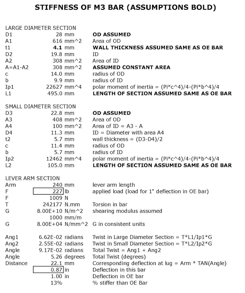

To get an idea as to the stiffness of a 28 mm hollow (M3) bar I have repeated the calculations with several unverified assumptions (I don’t have an M3 bar on hand to measure):
Name:  8a M3 Bar.jpg

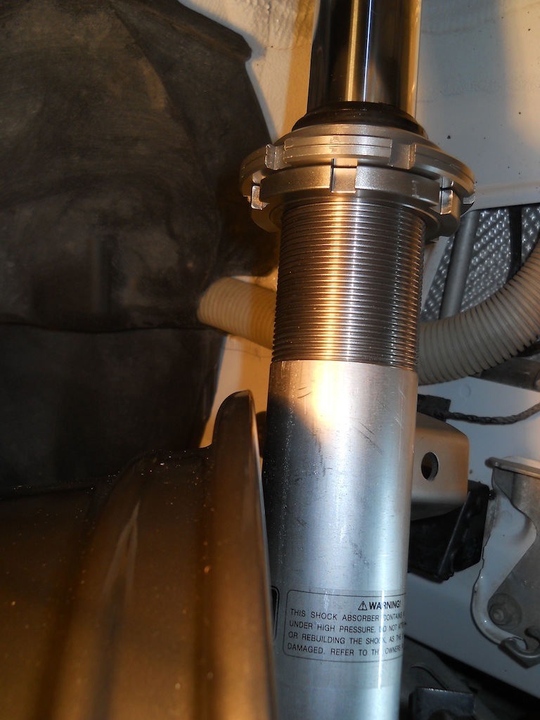

It depends on what type of adjuster you are using. The Ohlins adjuster sits in the cup. In this respect it is similar to the AST adjuster.
Name:  AST Adjuster.jpg
