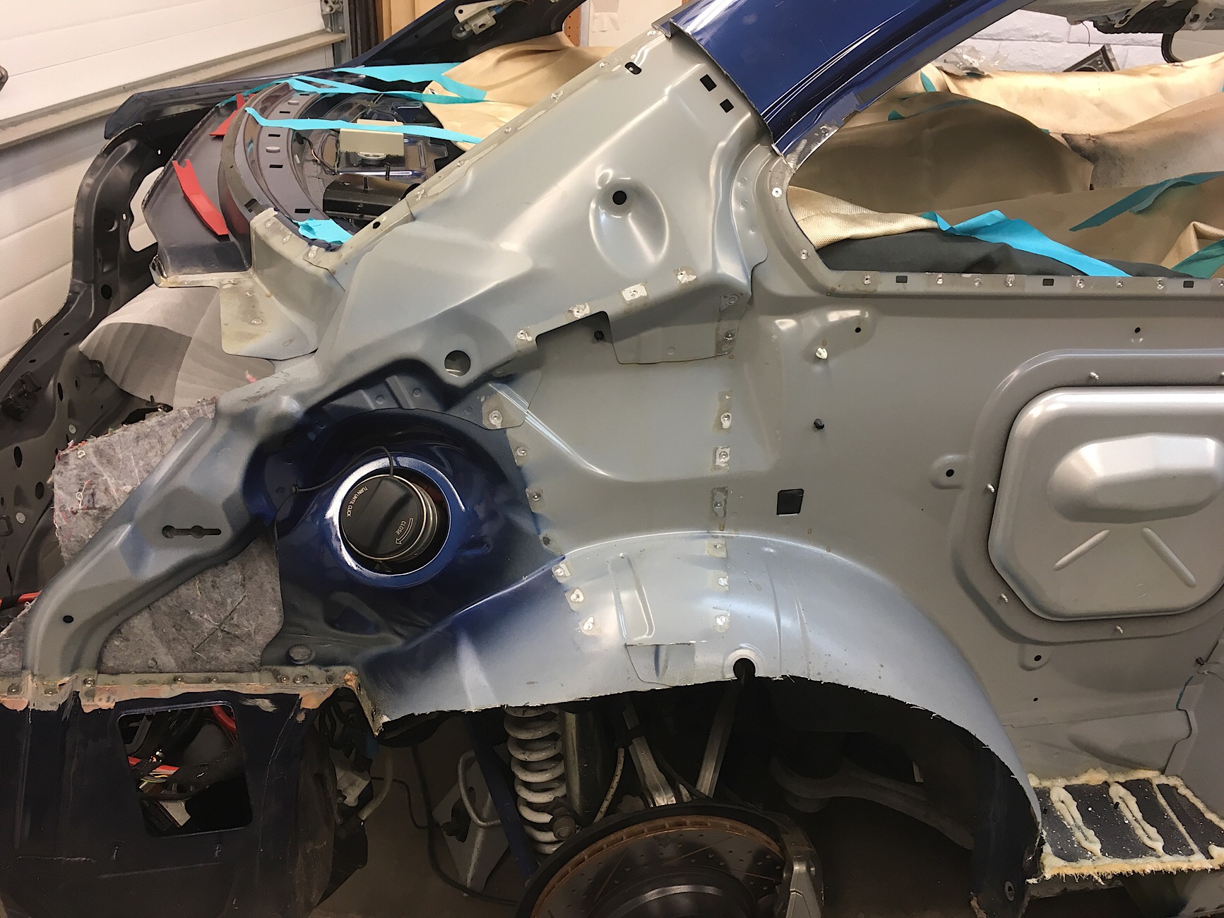

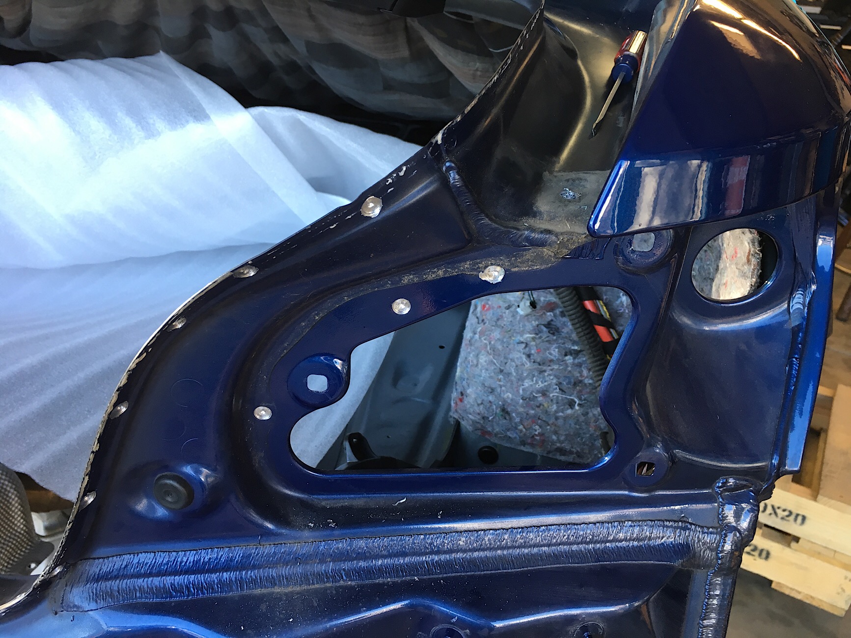

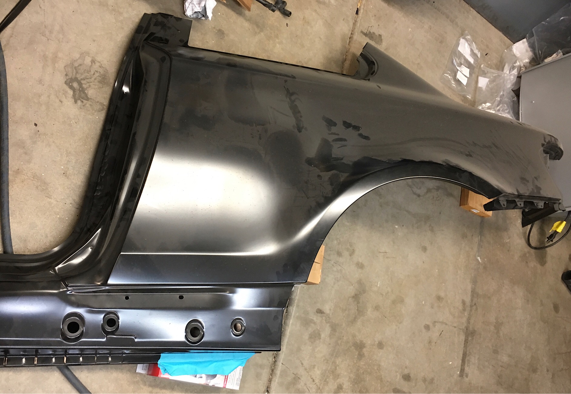

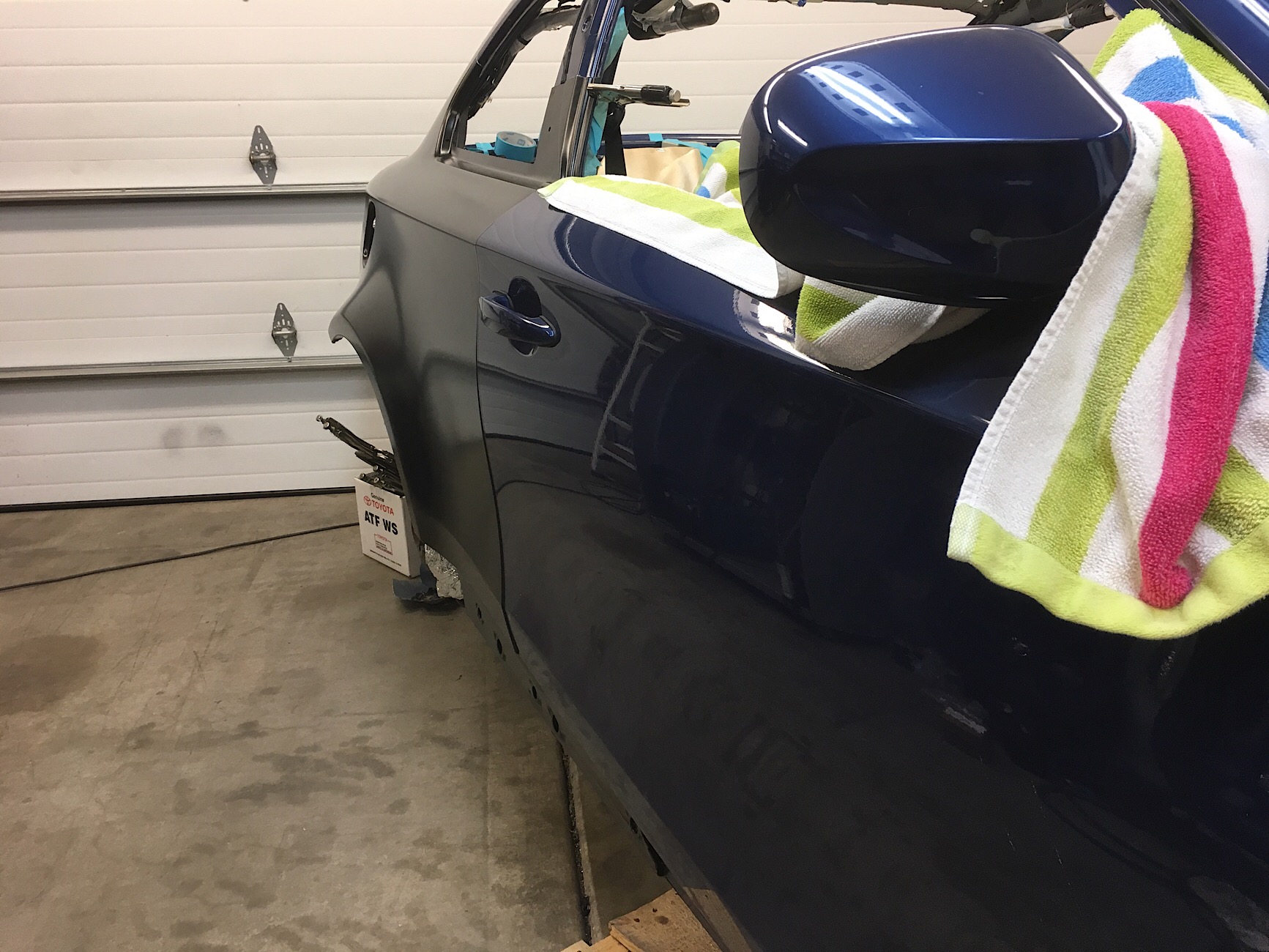

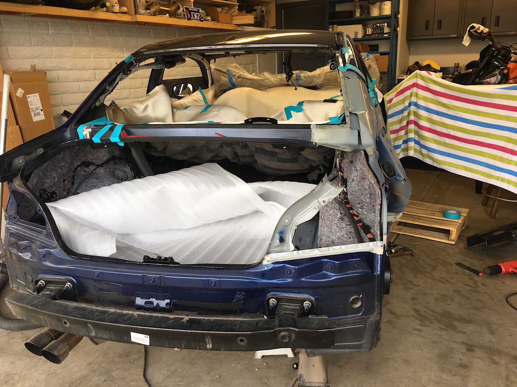

I did stuff!
Some progress this afternoon. RH 1/4 is off.

199
Drives: Toyota Tacoma
Join Date: Dec 2015
Location: Glendale AZ

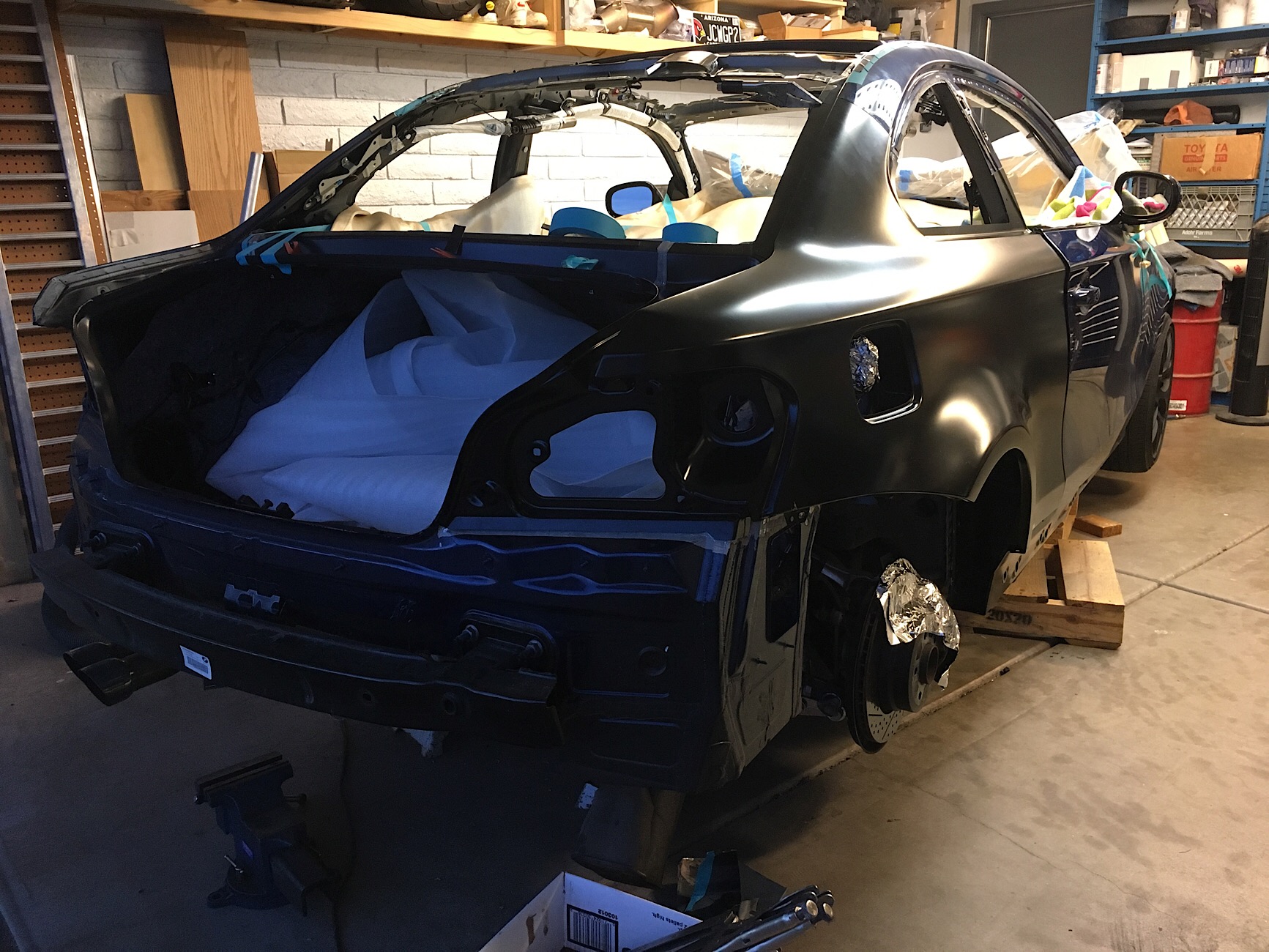

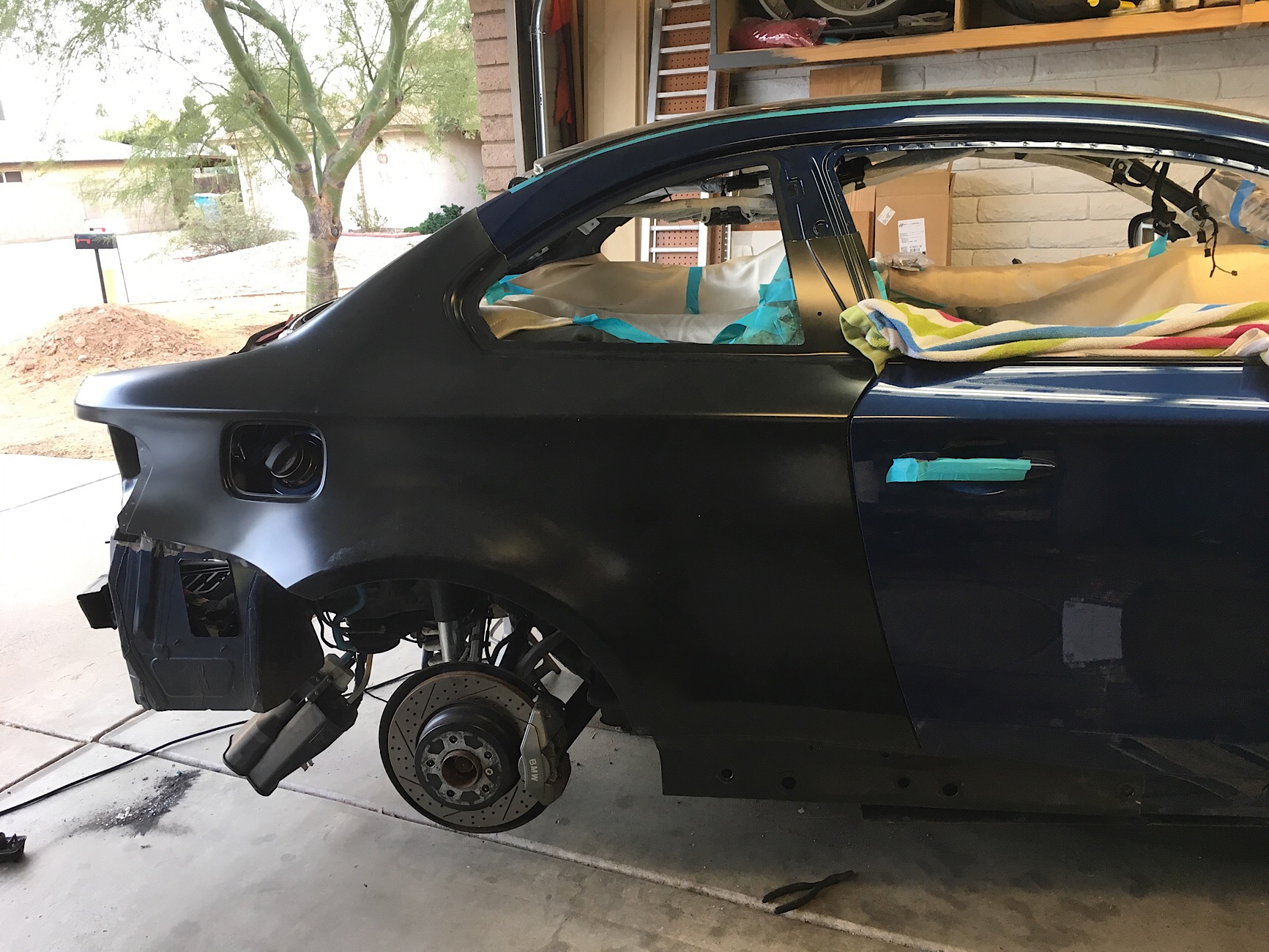

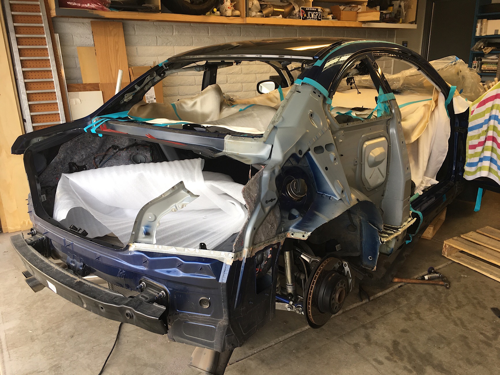

Just for shiggles
Threw it up there just to see.

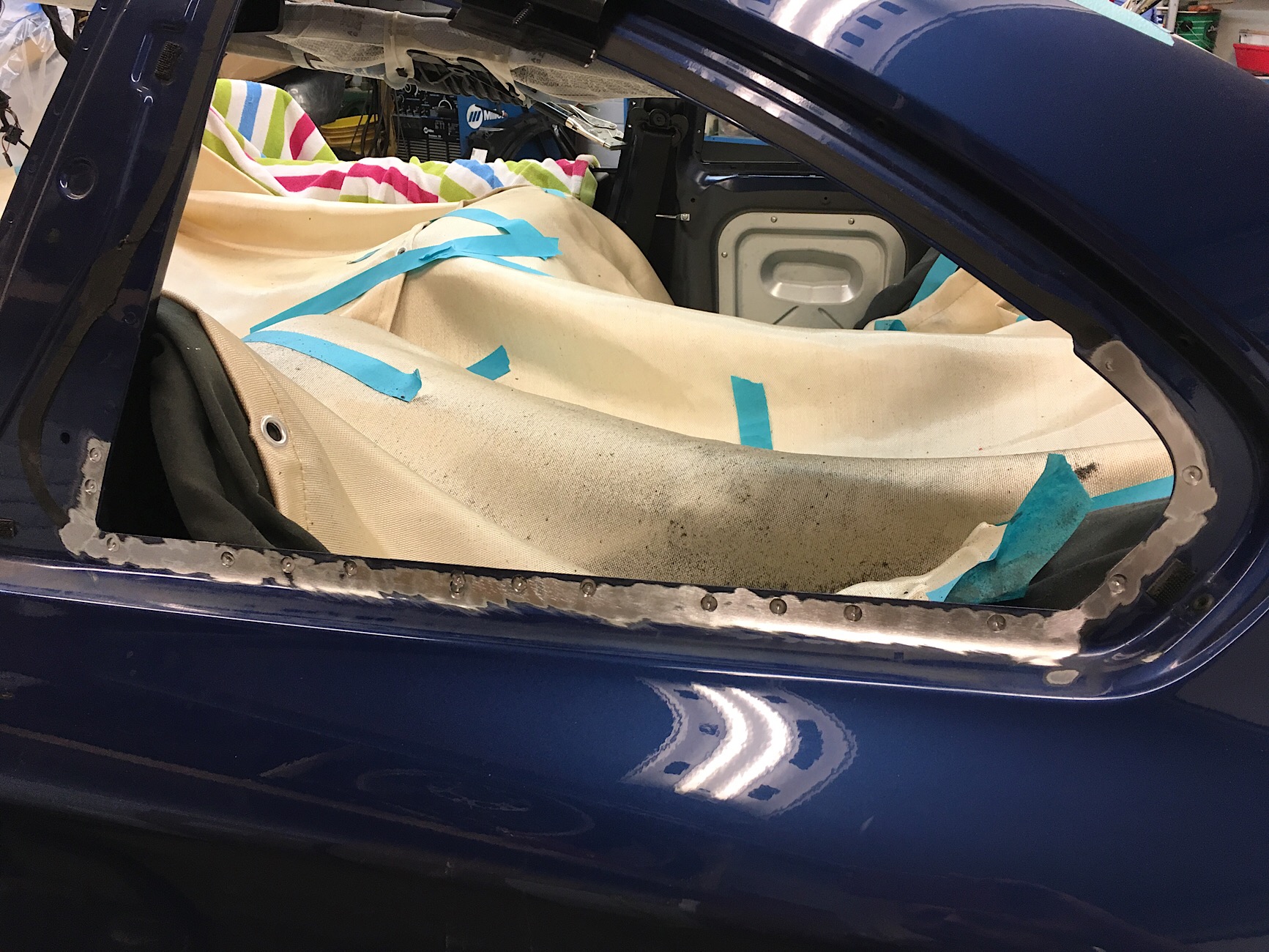

Meh

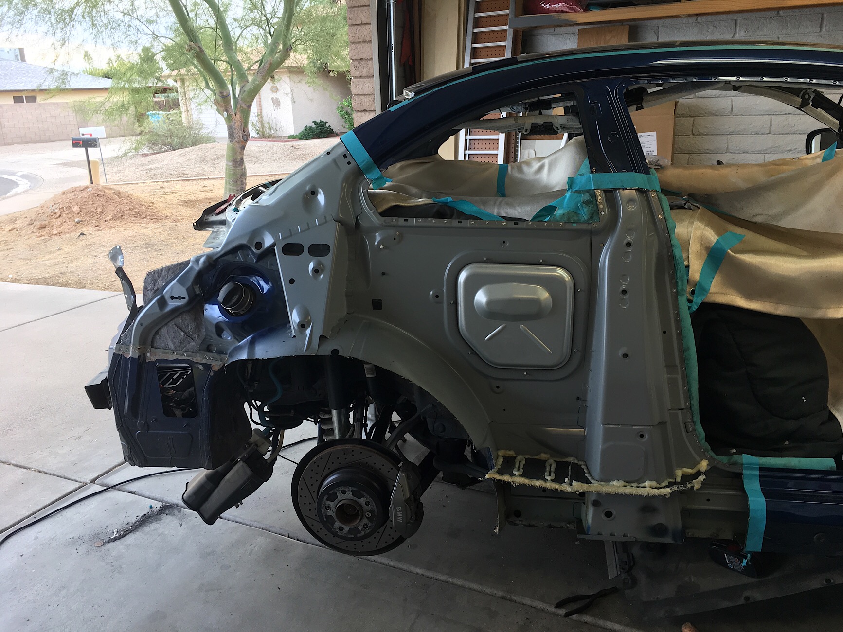

Nothing major as of this morning. I’d forgotten to post up this pic the other day. It just shows where I’ve removed the brace above the wheelhouse.
So, tomorrow, the “plan” is to knuckle down and get some serious progress on this thing. I’ve got the day off and a friend coming over to assist and to help keep me on task. I tend to get distracted somewhat easily when I’m out there working alone.

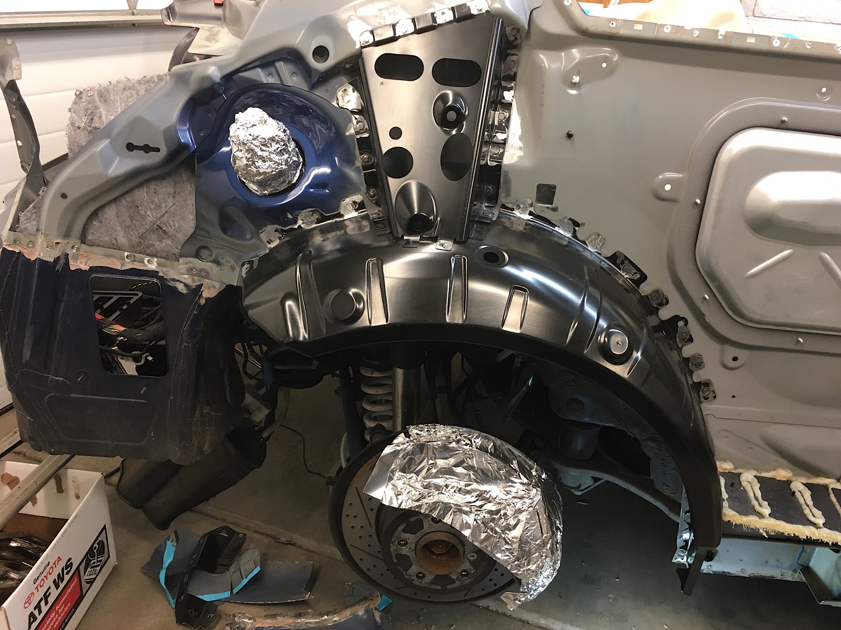

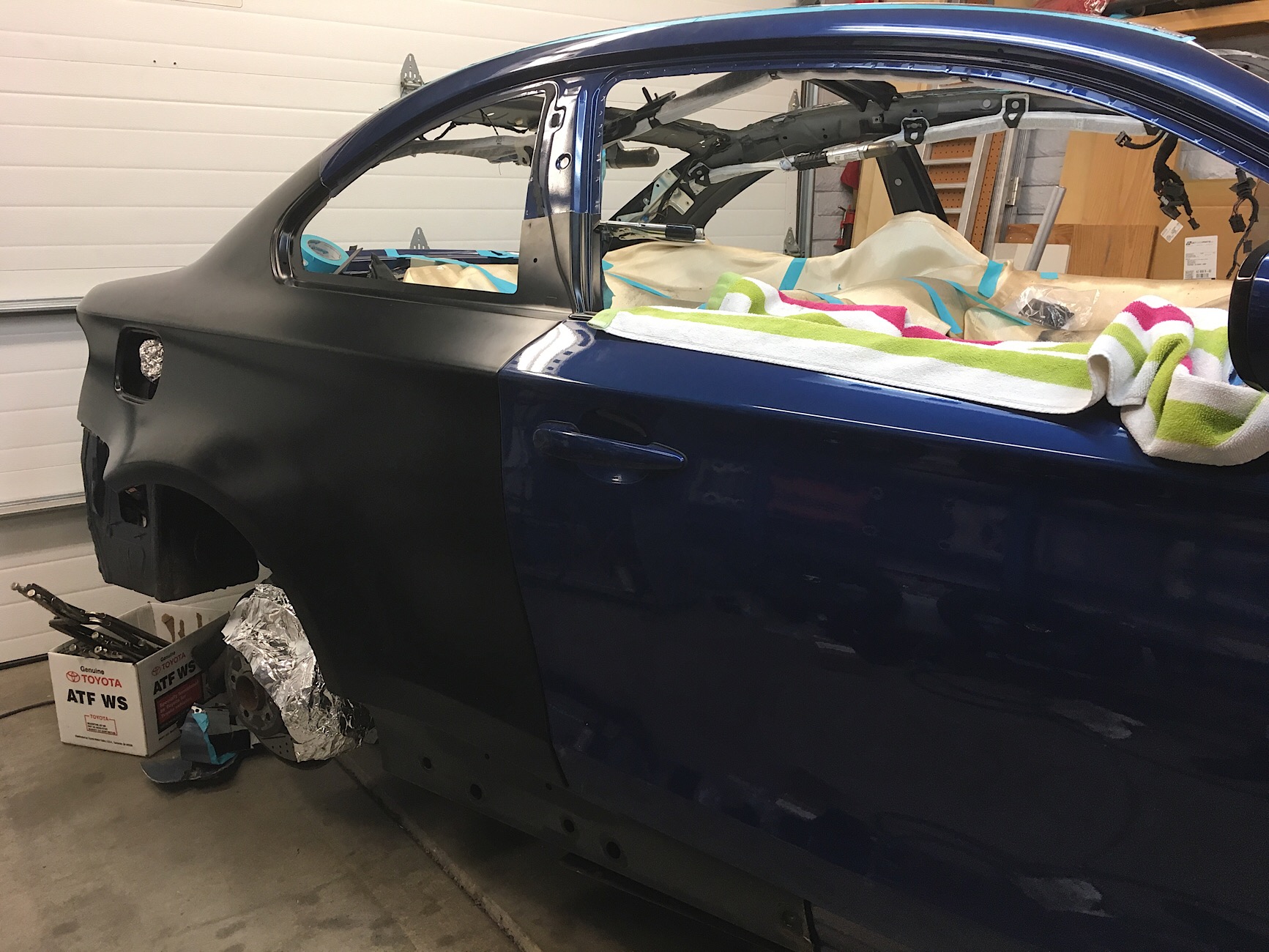

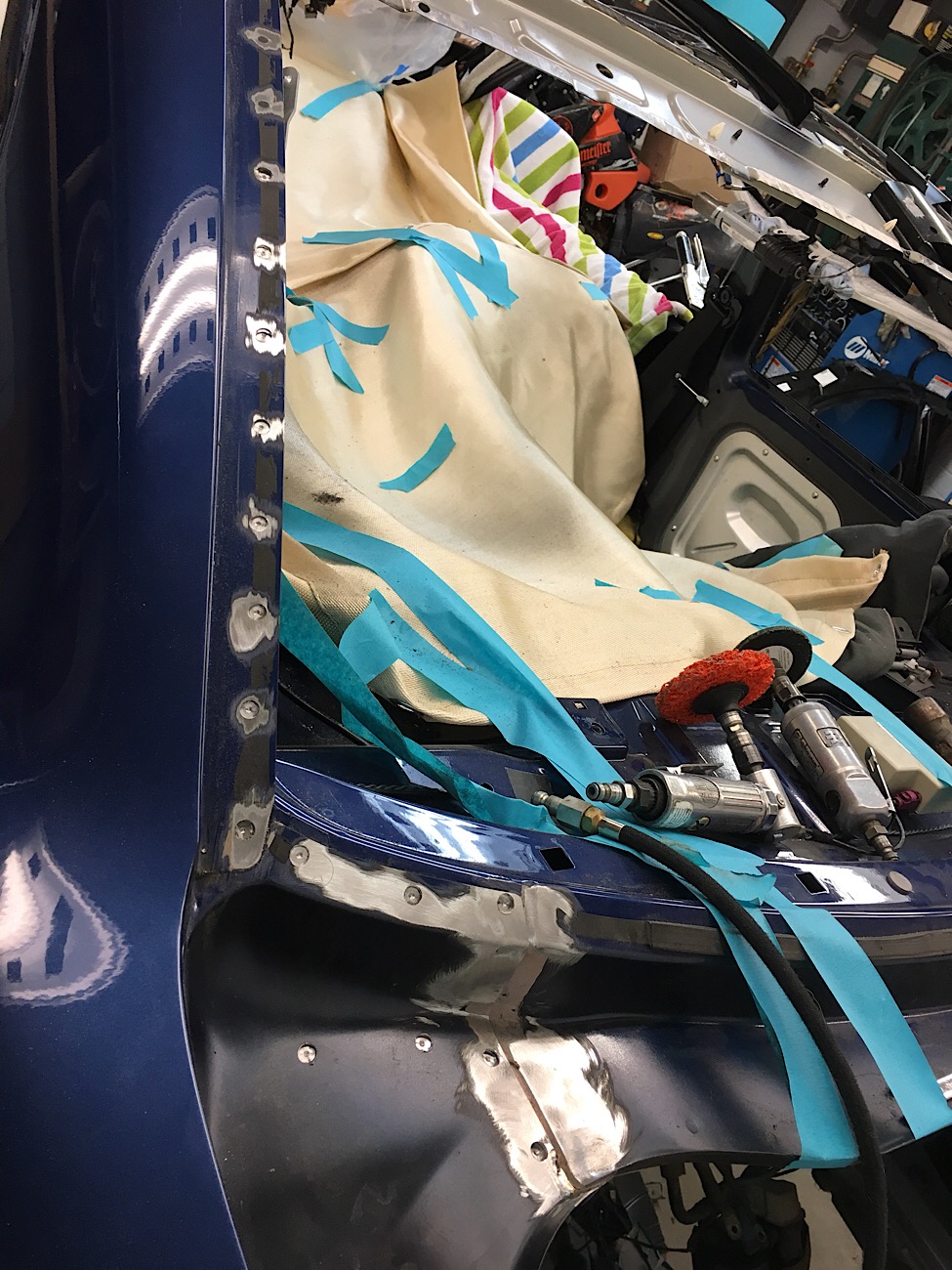

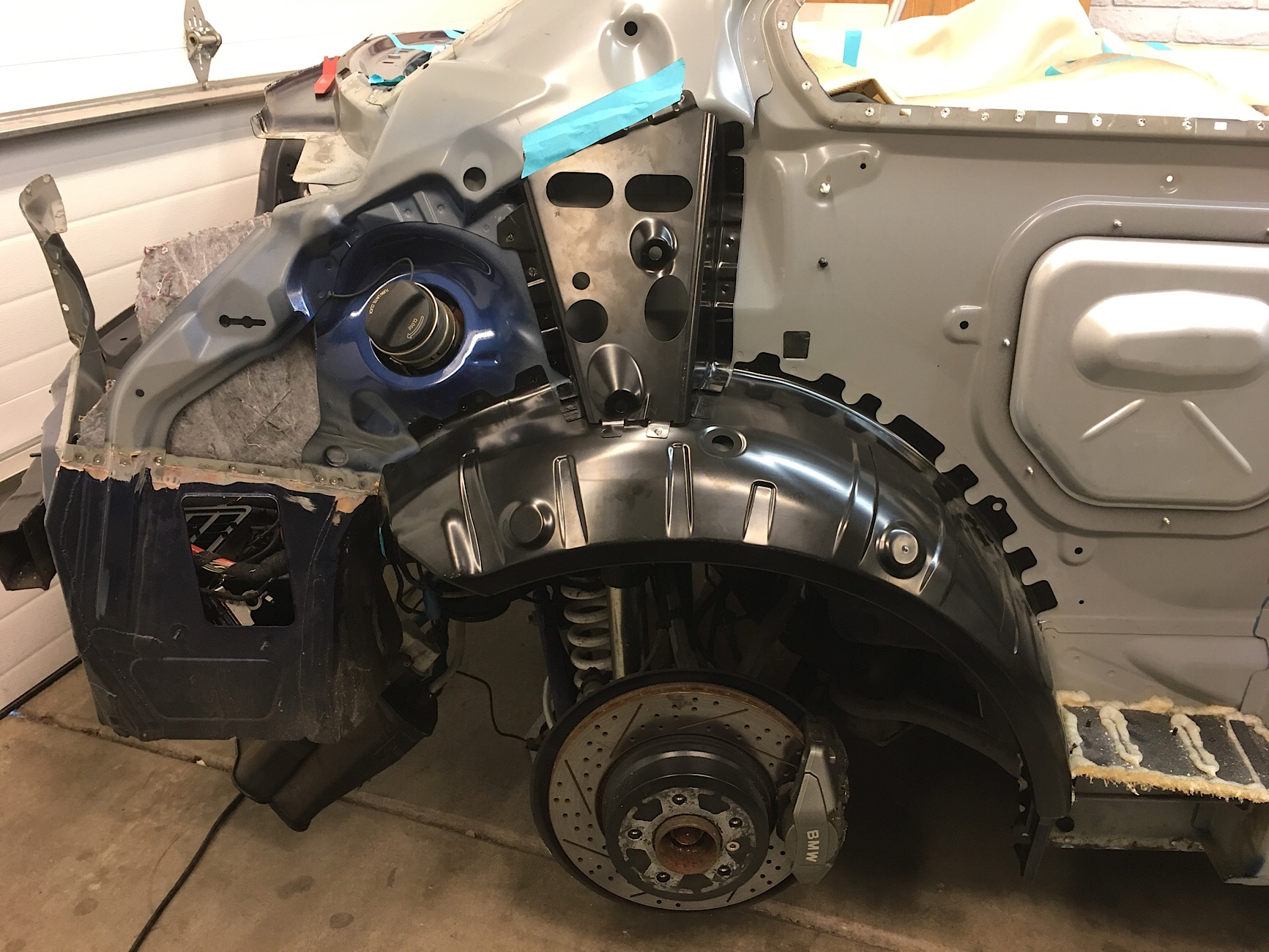

Rh outer wheelhouse
Well, didn’t end up having the kind of free time that I would’ve liked yesterday. But, I did get the new outer wheelhouse trimmed off and fitted to the car.
BAN_M2C4298.00

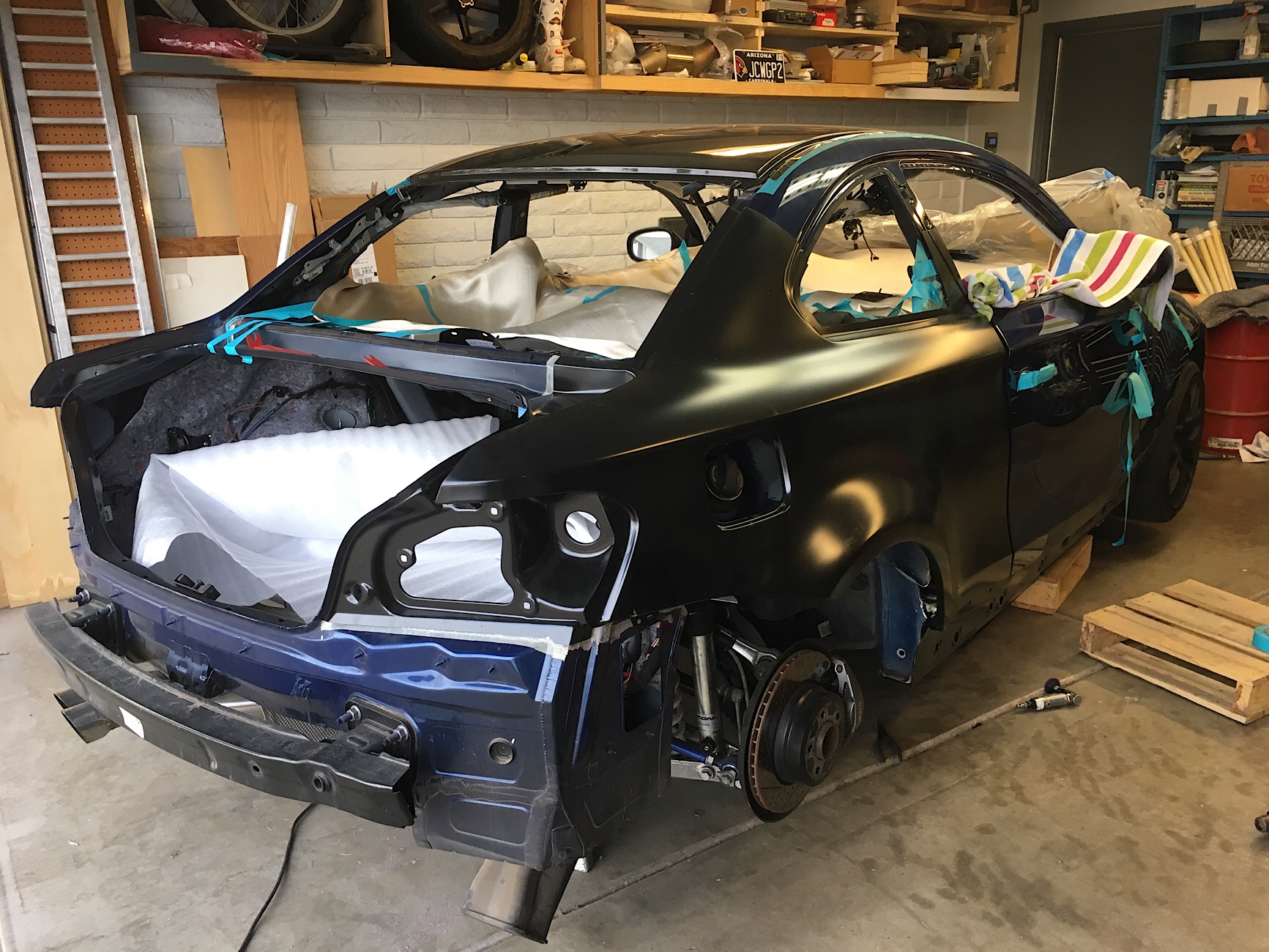

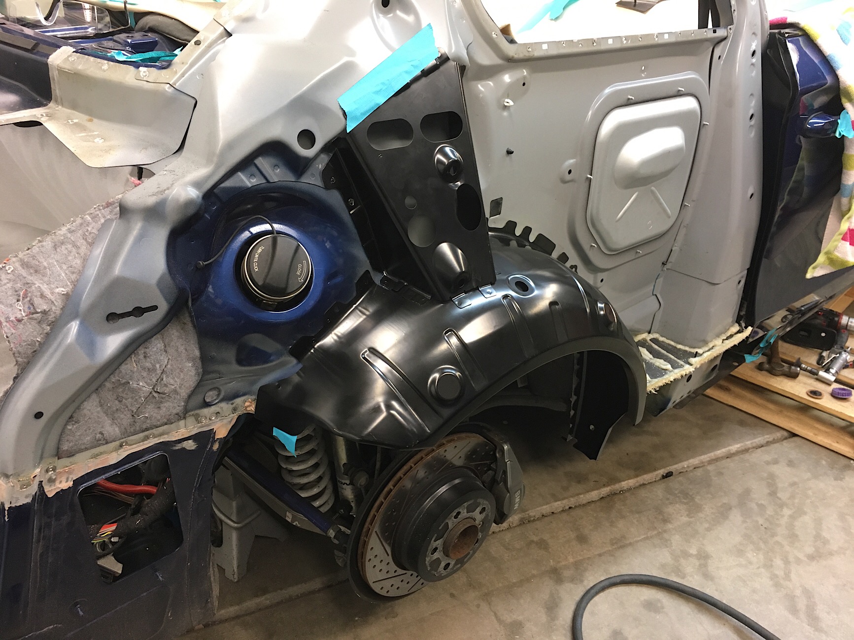

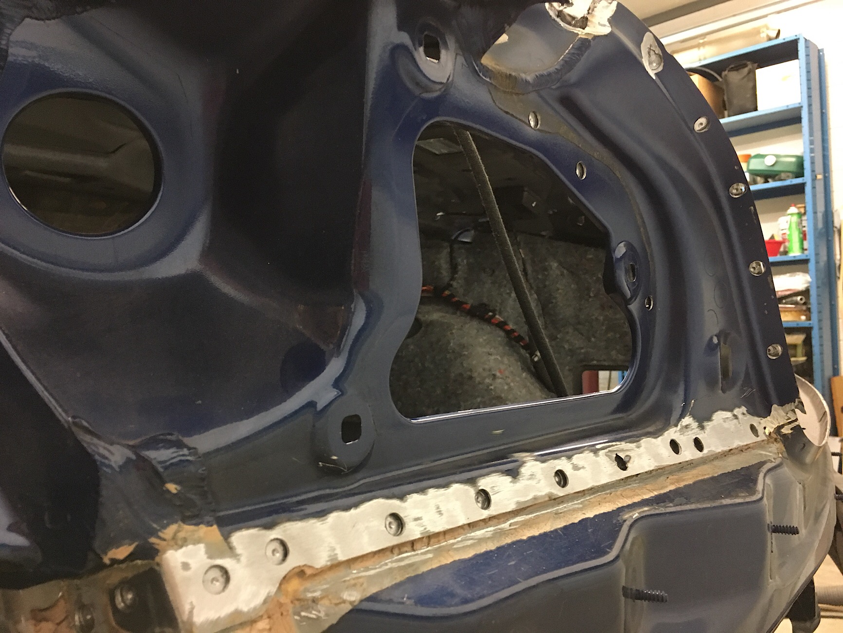

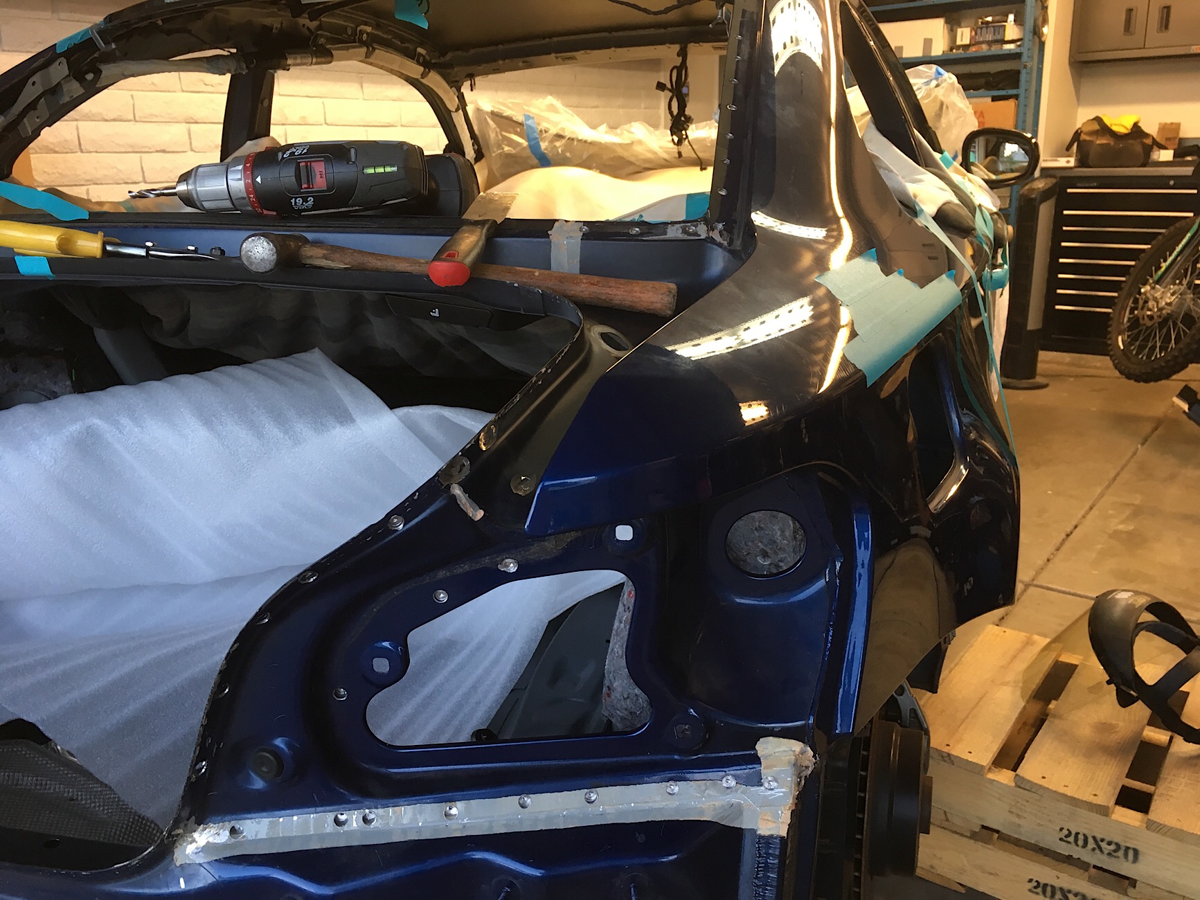

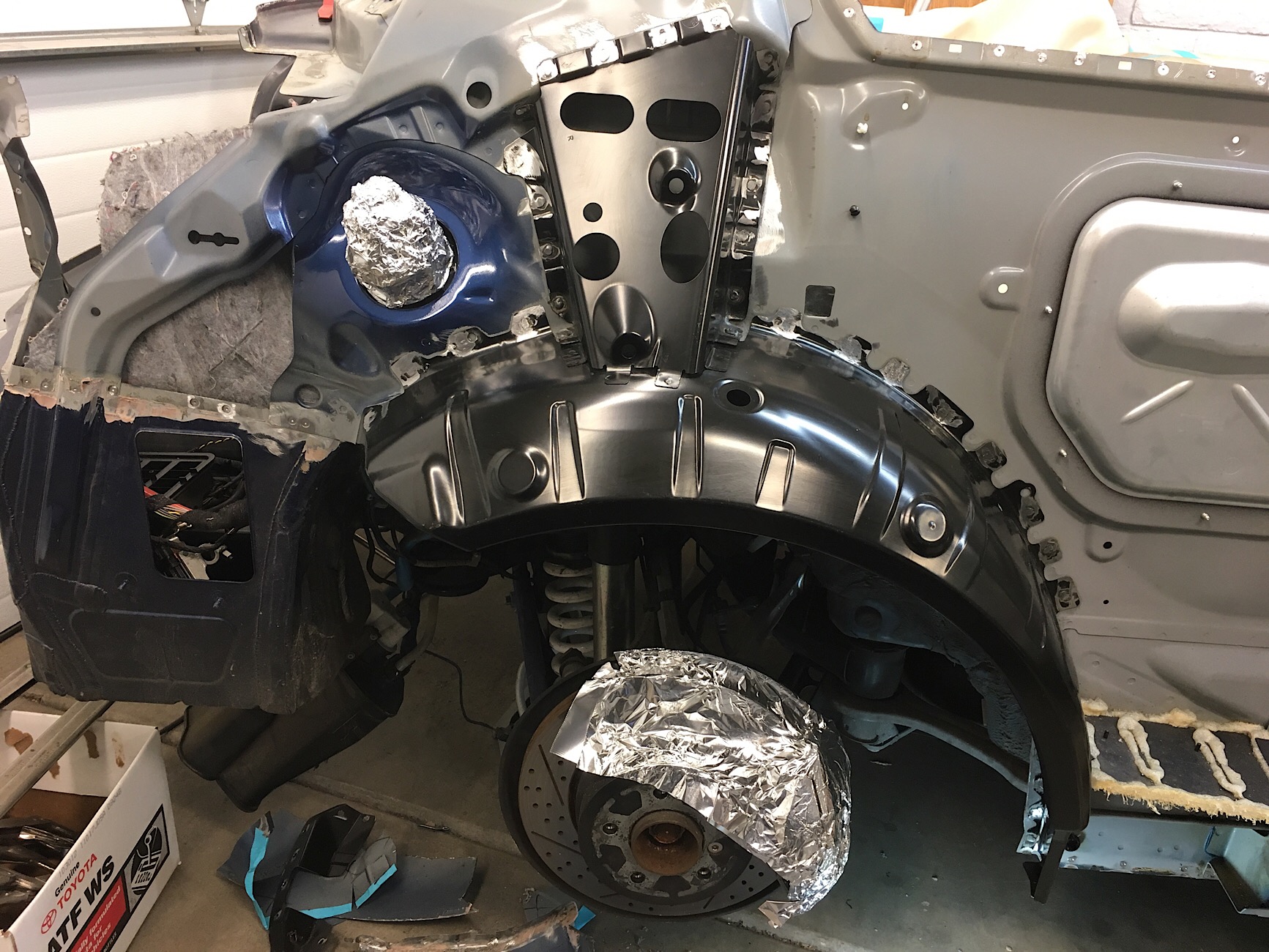

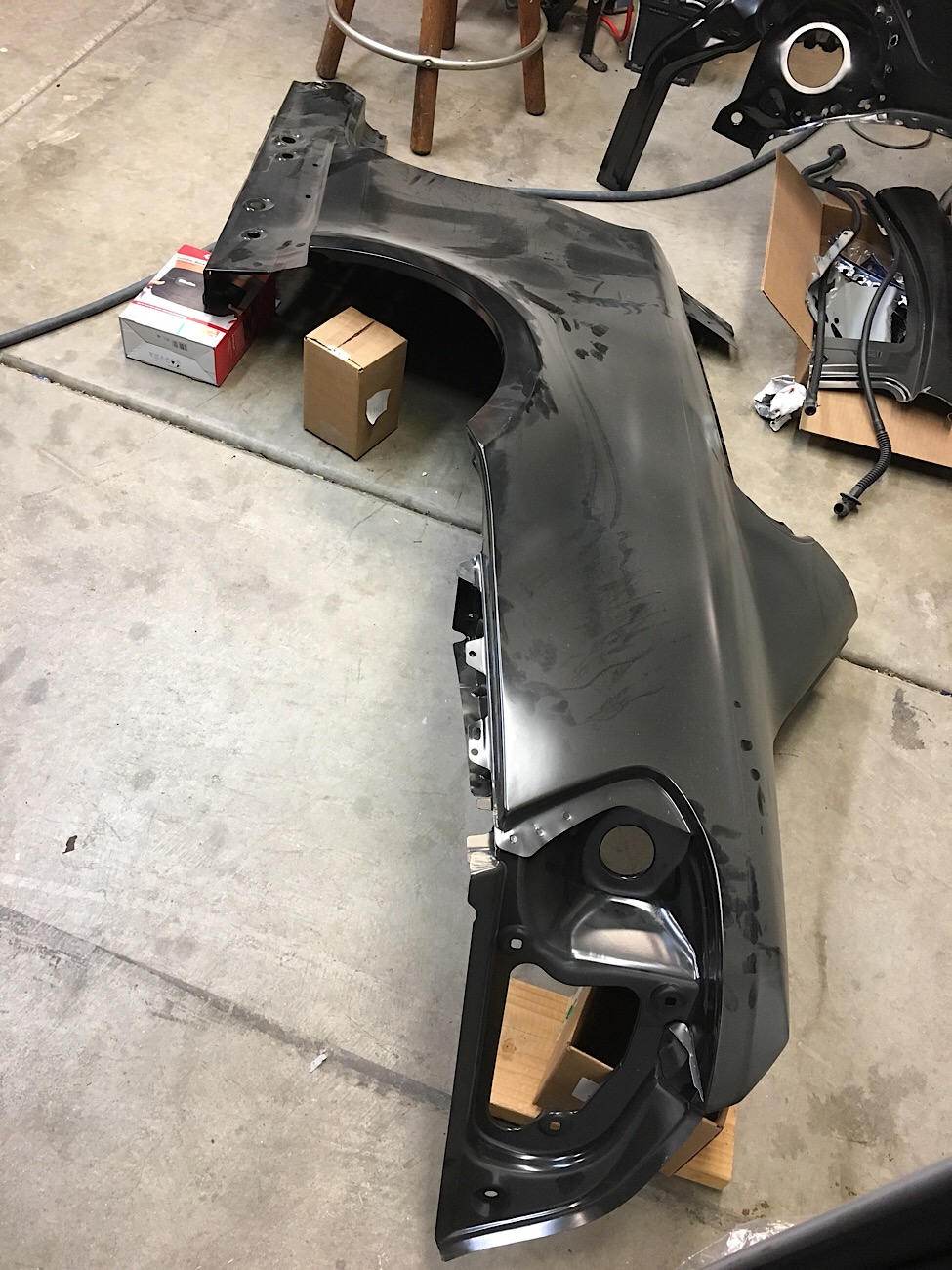

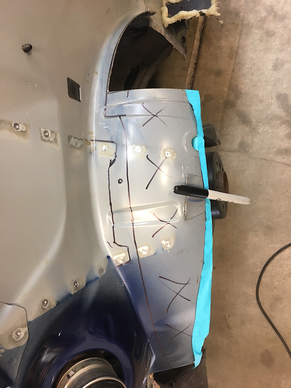

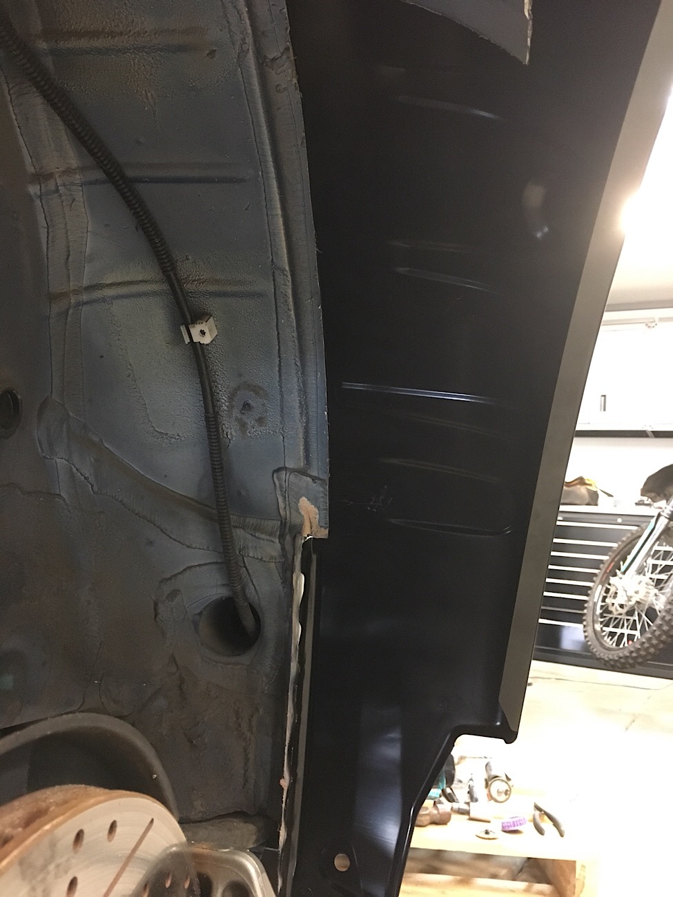

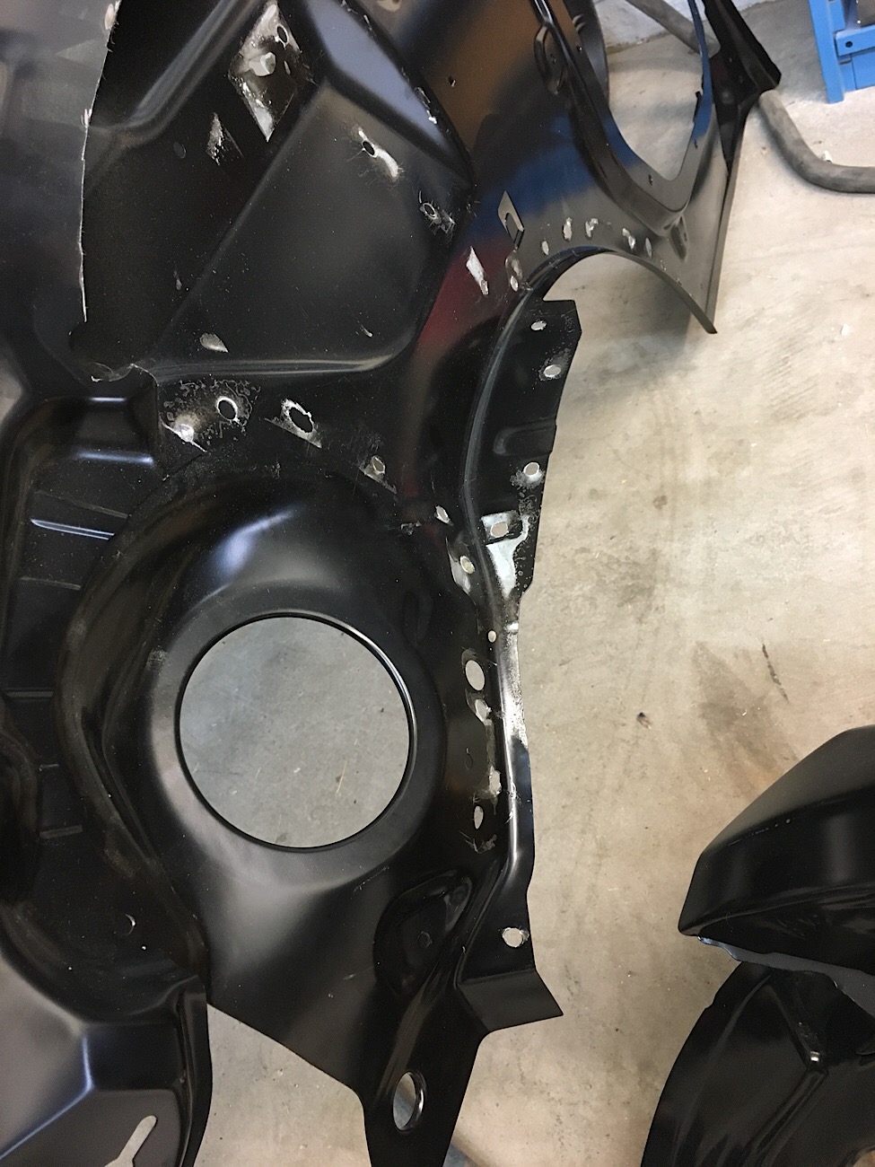

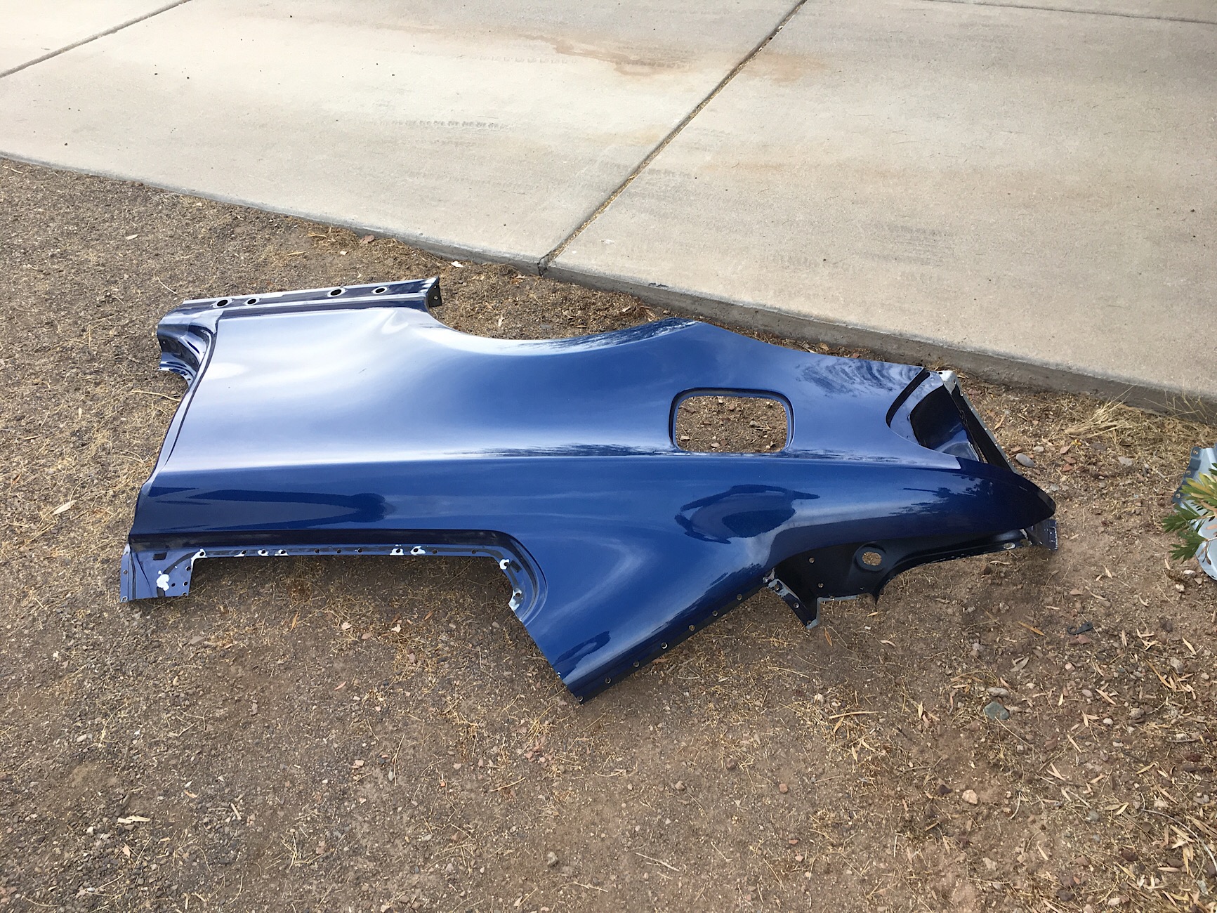

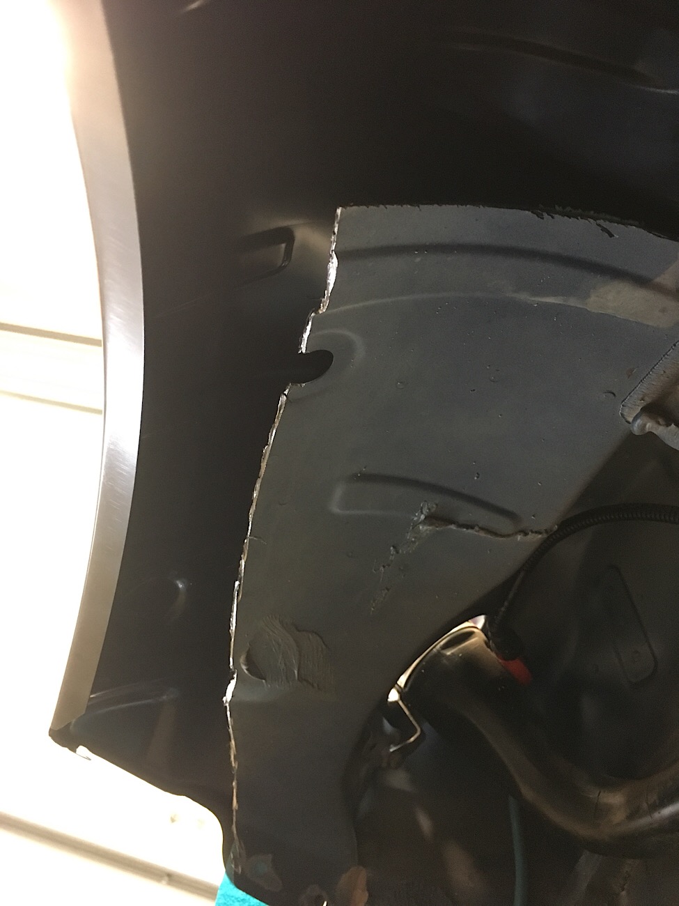

Few details
Here’s a couple pics some might find interesting.
First pic, top view before I completely trim off the old 135i section.
You can see the tire clearance difference between the two parts in the second pic. I’d say it’s about an inch higher and extends outwards about 2”.
Third pic is the front section of the arch.

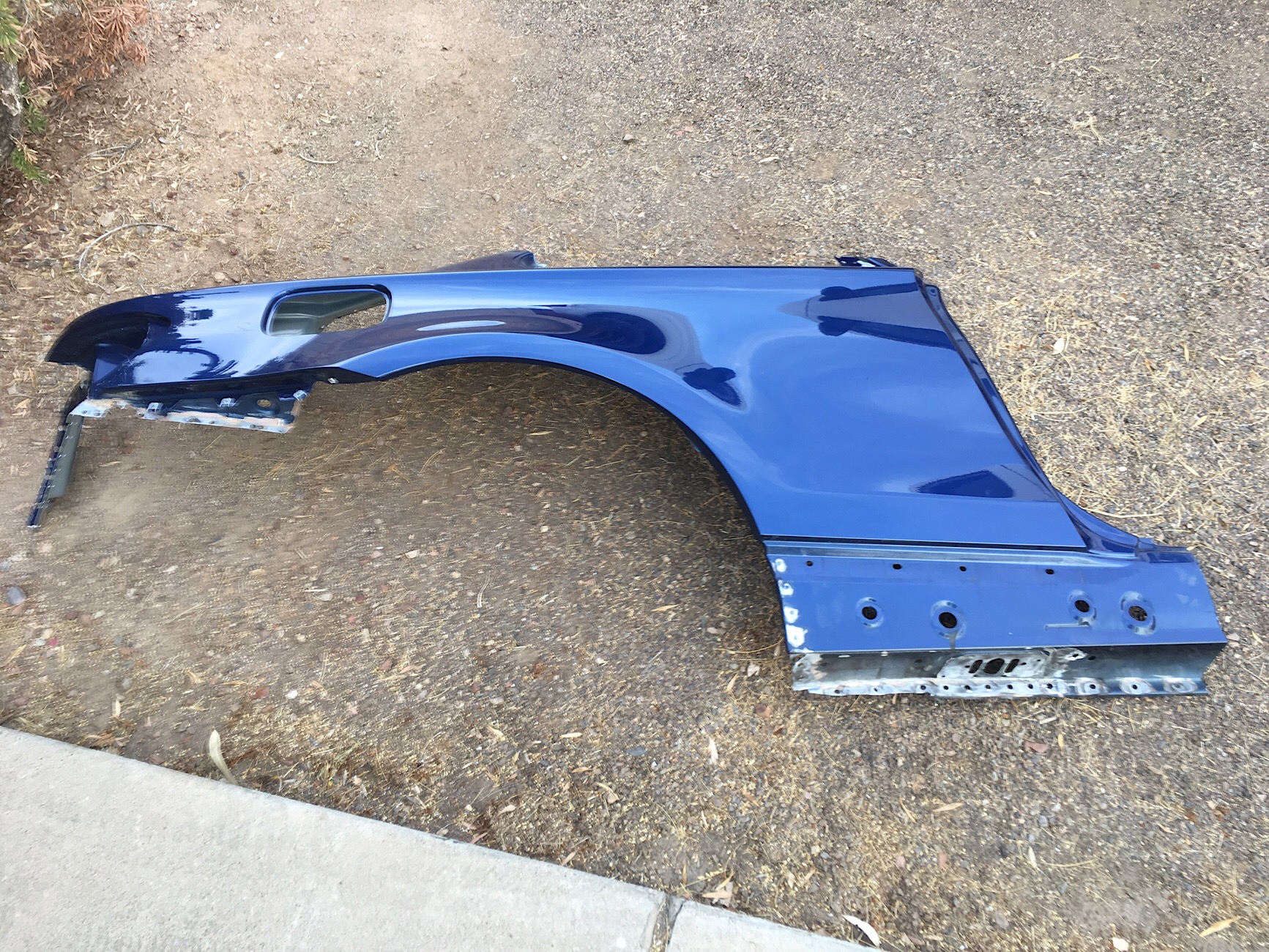

Fourth pic is the 1M remnant that I removed the wheelhouse from.

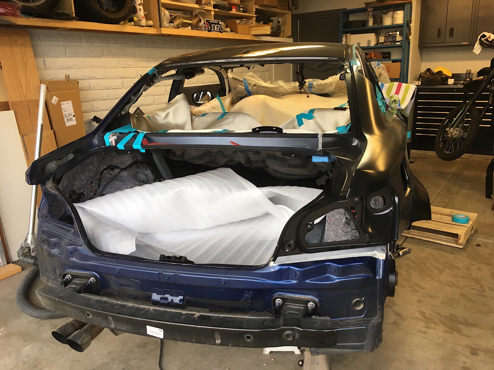

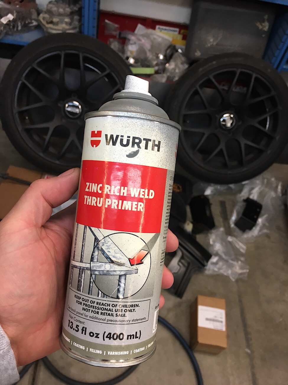

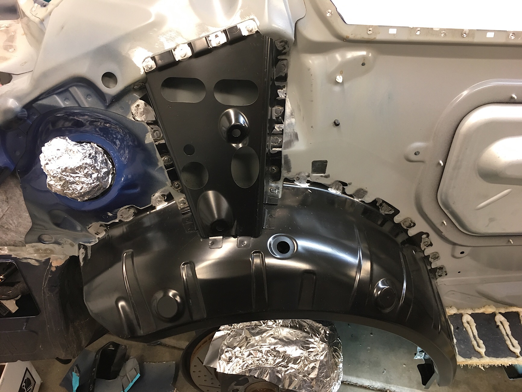

A mini milestone
So, I’ve actually started putting things back on to the car rather than cutting them off!
The RH outer wheelhouse is welded on. I didn’t grab any pics of the clamping and welding. I was gloved up and had my helmet on. Messing with the cell phone to take pics didn’t really cross my mind until I was cleaning up a bit.
I’ve still got some more cleaning up to do in a few spots.
The weld thru primer is what’s between all mating surfaces. All the outer surfaces will be painted to match the OE gray.

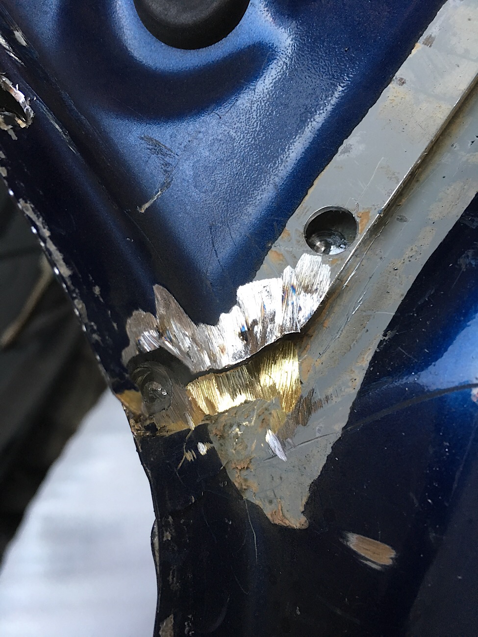

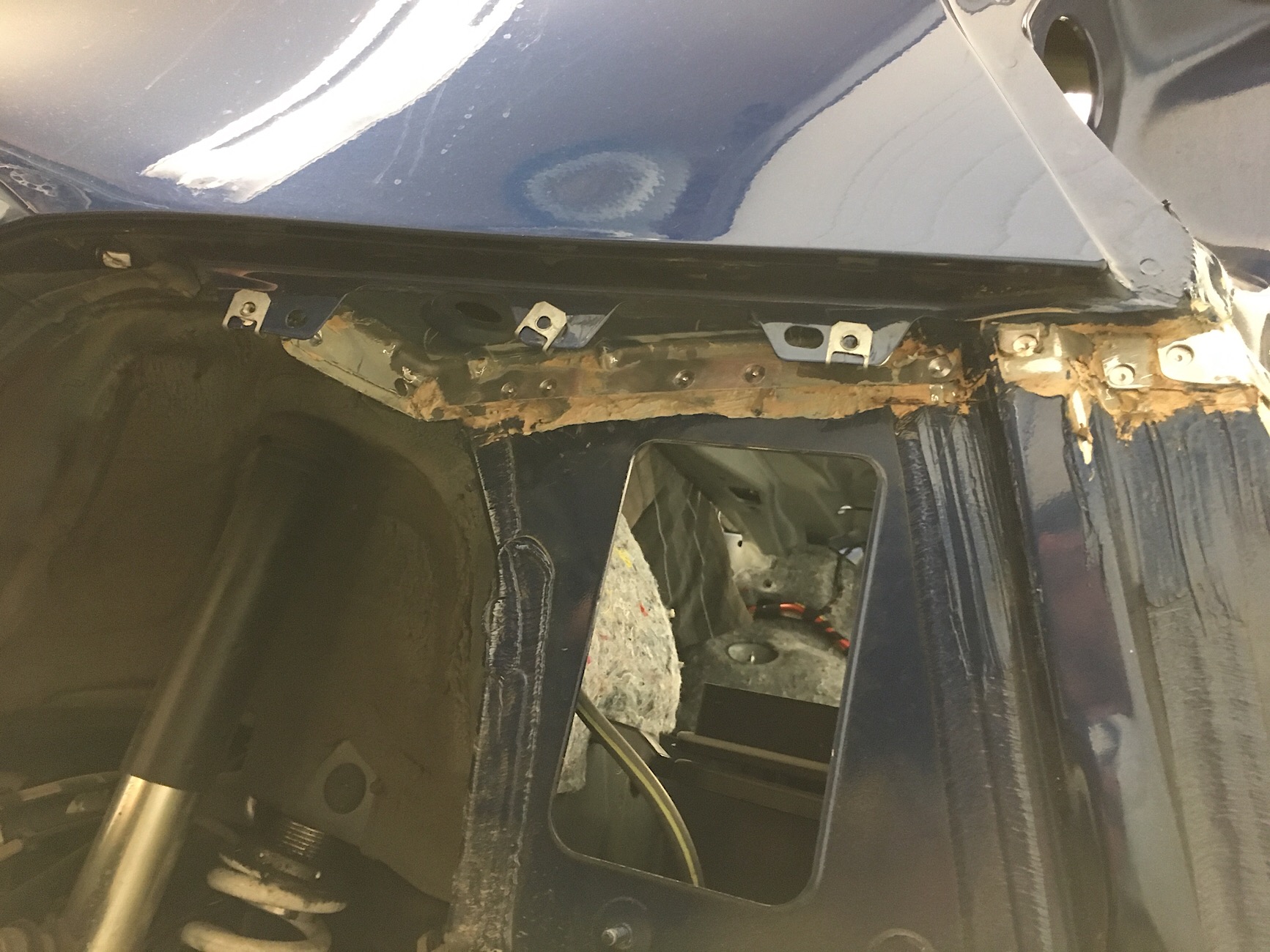

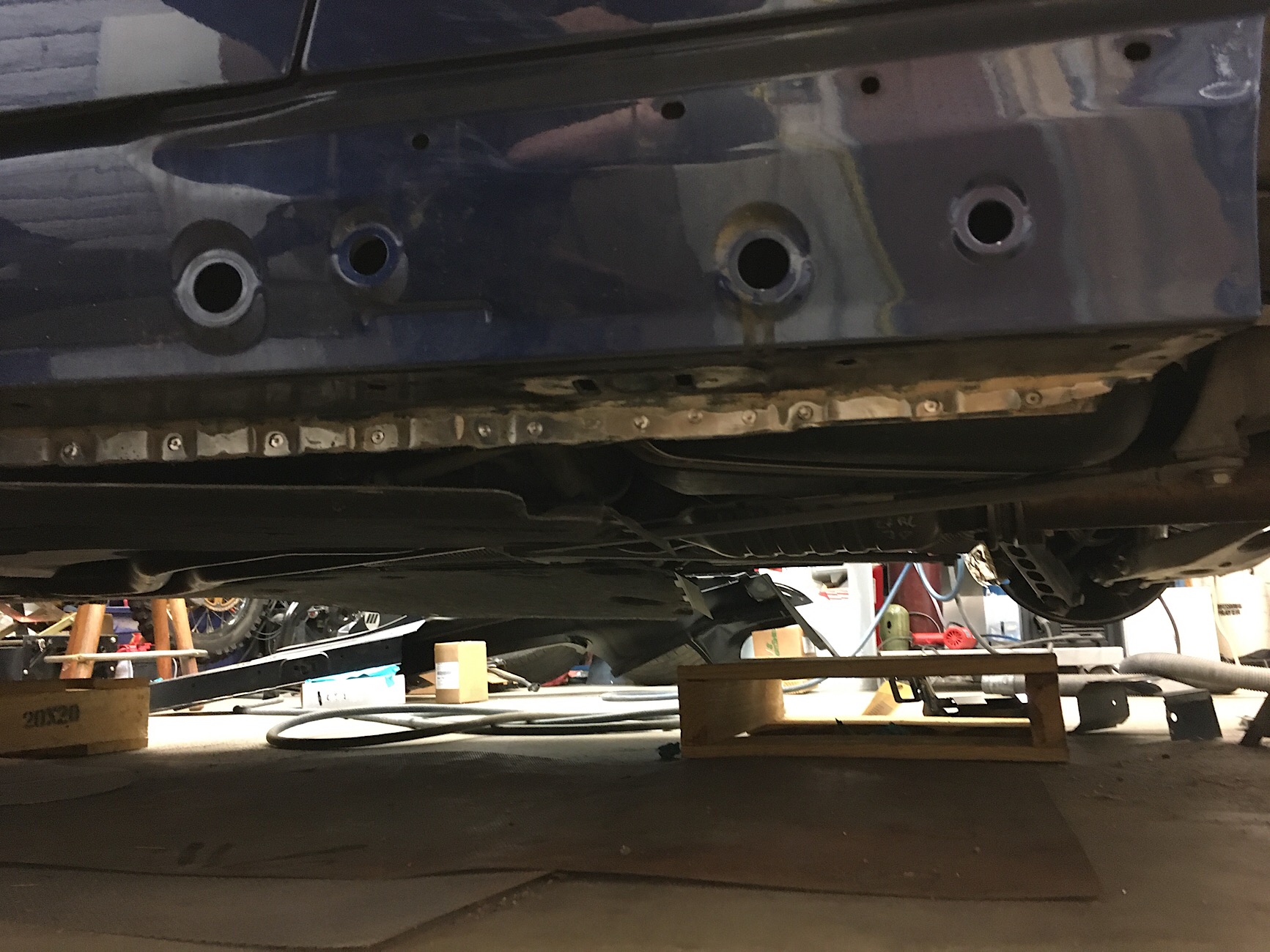

Lots of spot welds
Been trying to spend time each evening after work this week.

I’d been storing it at work.
