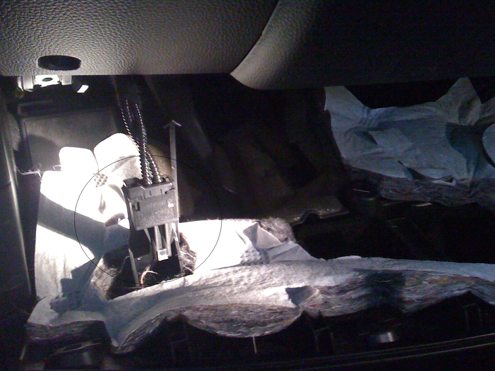

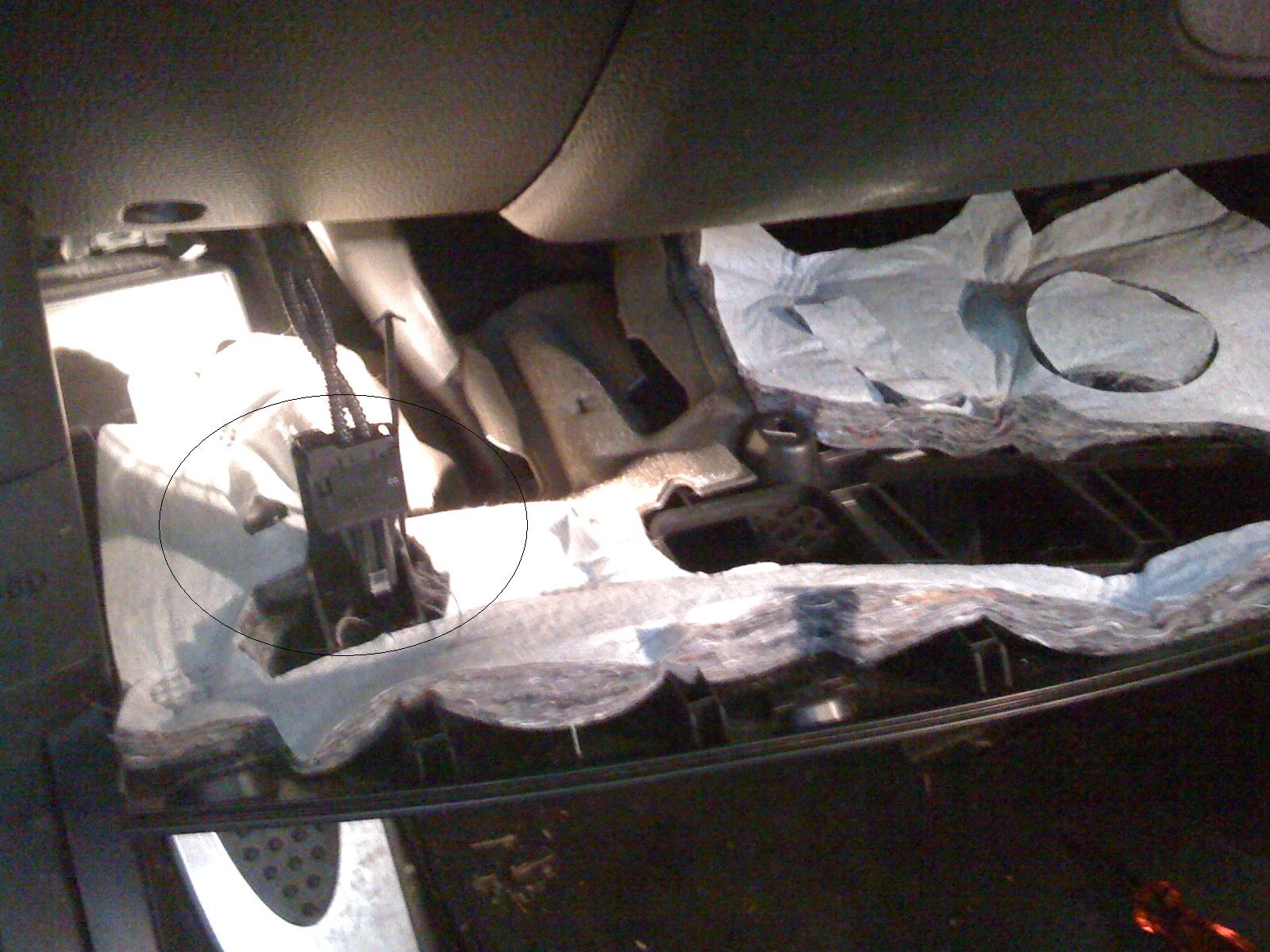

I've removed the pedal trim to have a look and i would like to know what it was (the circle on the pictures).

that's part of what they call the footwell module in these cars and I think it's used for programming- it has nothing to do with the phone installation, at least it didn't for me. If you have the wiring up in there, then the antenna wiring should be tucked way up in there somewhere and you just have to find it. As for the mic wiring on the passenger side- it really was quite a pain to get back up in there- I went through the side kick panel under the glove box on the side under the A pillar, and then through the glove box, it was a lot of wiggling and suffering and just concentrating, but I didn't remove any pieces that said airbag on them or that had to do with the airbags

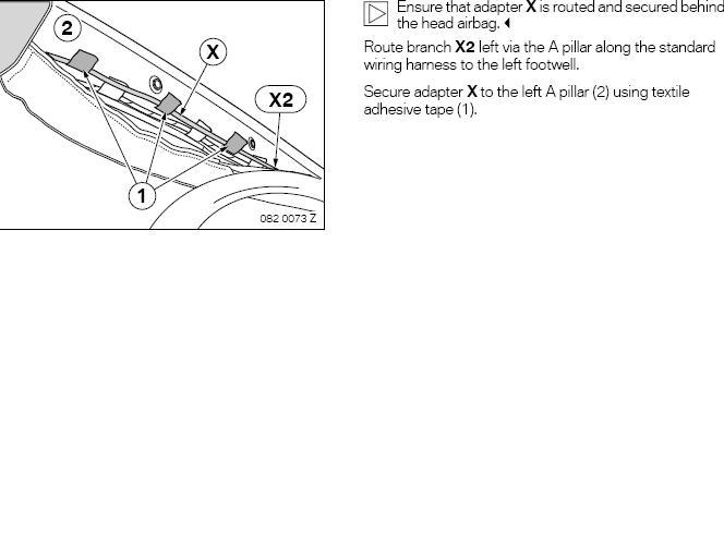

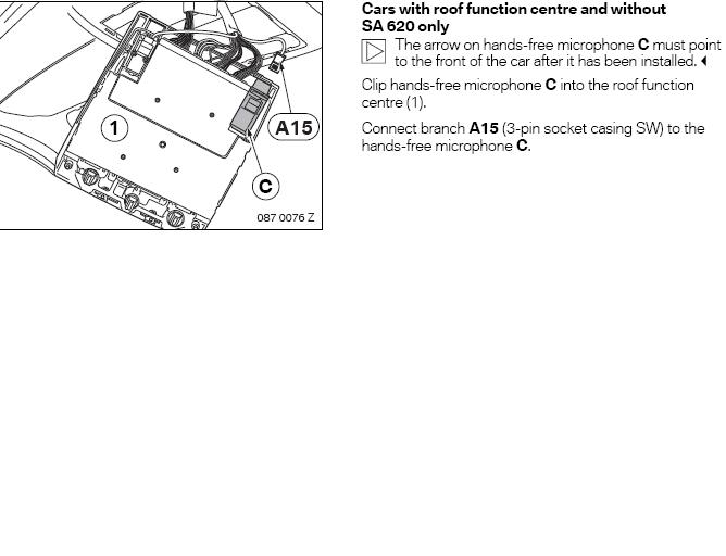

I don't have mic so i need to install one and i think i need to route the wire
which connects to the mic.
And i have to route the wire behind the head airbag of the A pillar as the picture shows
Tell me if I’m wrong...

it looks like that is what you have to do per the pics from bmw, as to the roof FZD, yes it is a total pain in the ass to do I know, but once you get it the first time it's easy after that. what you need to do with an angled trim removal tool is insert it at a pretty low angle right behind the center of each of the circular over head lights. you should feel a strong, springy response if you have made contact with the metal tabs, once you feel that it's a matter of simultaneously pushing hard on them and down, once you release one side, try to keep it open/ held down while you release the other

That's a MOST fiber port, used in programming or diagnostics.

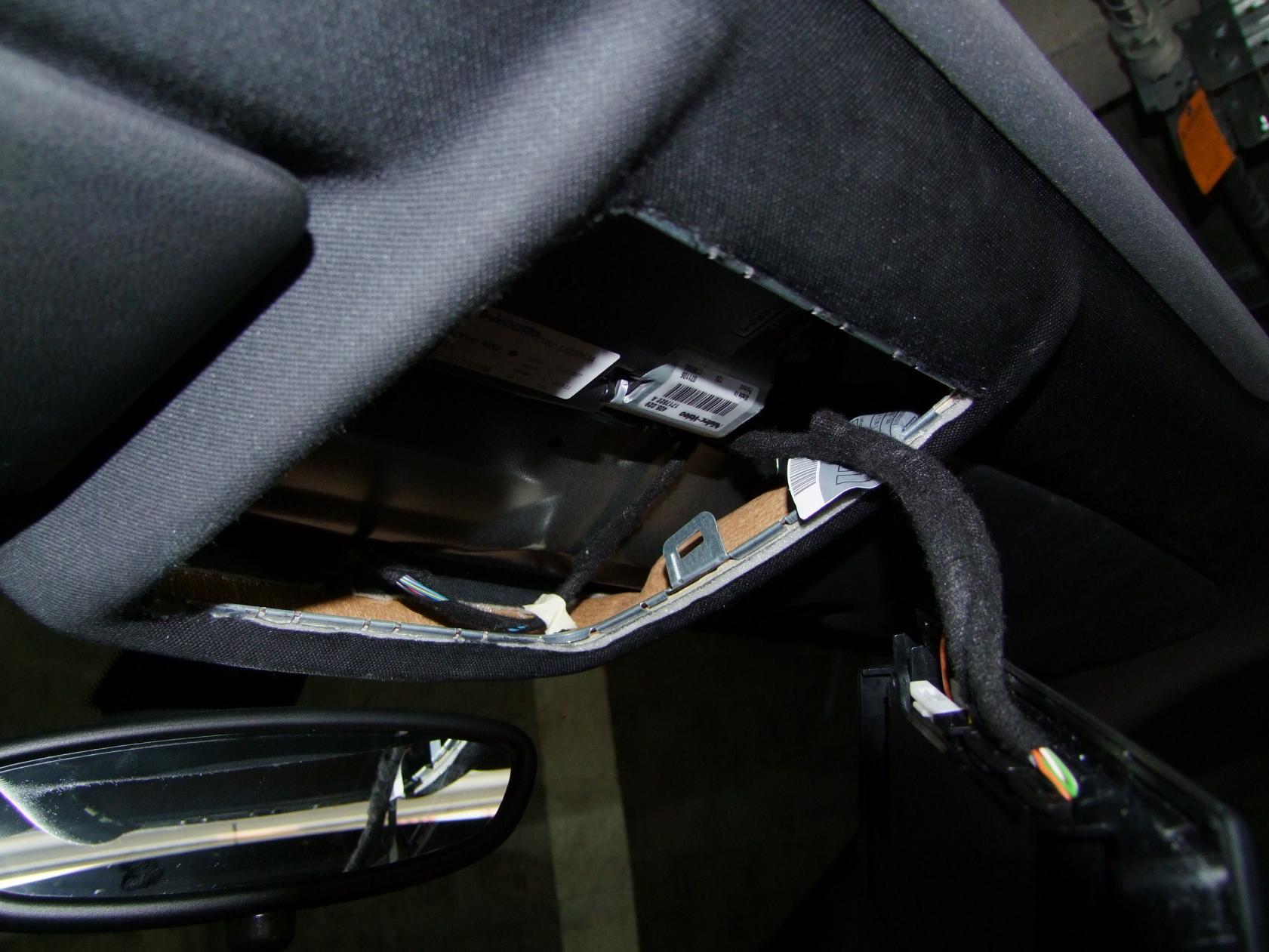

And i have succeed to remove the roof center.
I took photos i can share...
I have been surprised to see 2 "modules" , on one we can see "Webasso Drive assy" and the other "Nidec Valeo"
Someone could explain me what the aim of this 2 modules are ...
About the BT retrofit, someone could confirm me i need to route the wire behind the head airbag of the A pillar as the picture shows above...

if you're not doing assist, just bt, then put the microphone on the side of the unit closest to the driver- as in the pic- the mic clips in and the plug faces the rear of the car, then route the mic wire through the A pillar to the mic I believe- that should be it for the overhead console (FZD) on non-assist cars
