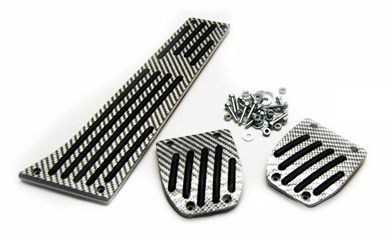

Hey guys, what drill bit size you guys used to drill them? 7/64 all the way? Also, the screws behind the gas pedal wont interfere with WOT? Thanks

I used 1/8 for all the holes. I had to cut one bolt with a dremel tool so I would not interfere with WOT. I found the hardest part of the installation was removing and reinstalling the gas pedal. There is only one bolt and it is easy, the hard part is the electrical connector and the slide on connector for the pedal assembly. I needed to take the pedal off to get to the nuts on the bottom bolts. Once it was out of the car, cutting the little bolt was a piece of cake.

Hi JimD, thank you so much for the info. Used the 1/8 for all holes and voila! Like you mentioned, the bolt for the top right corner on the gas pedal was too long, therefore I had to trim it a bit. I also removed the pedal for easy drilling, didn't have much trouble with the gas pedal connectors, but re-assembling was a PITA!

My only complaint is that the curvature on the aluminum clutch/brake pads did not match the pedals, the pads were less curvy. Not sure if this is just the way they are or if they came defective? Other than that, these are great pedals for the price, thanks!

However, the RHD cars have brake and clutch pedals with only 3 drill holes. Therefore, US spec pedals will not suit these cars.
True this, as the lower end of the brake and clutch pedals are too narrow, allowing for only one centre screw. I am having to drill a new hole into these pedals. Will fill those 2 on either side with screws so they're not noticeable. Weird that the RHD model would have a different shape for these pedals!
